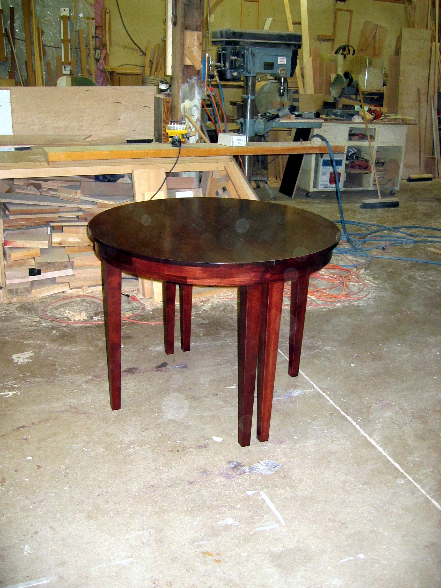

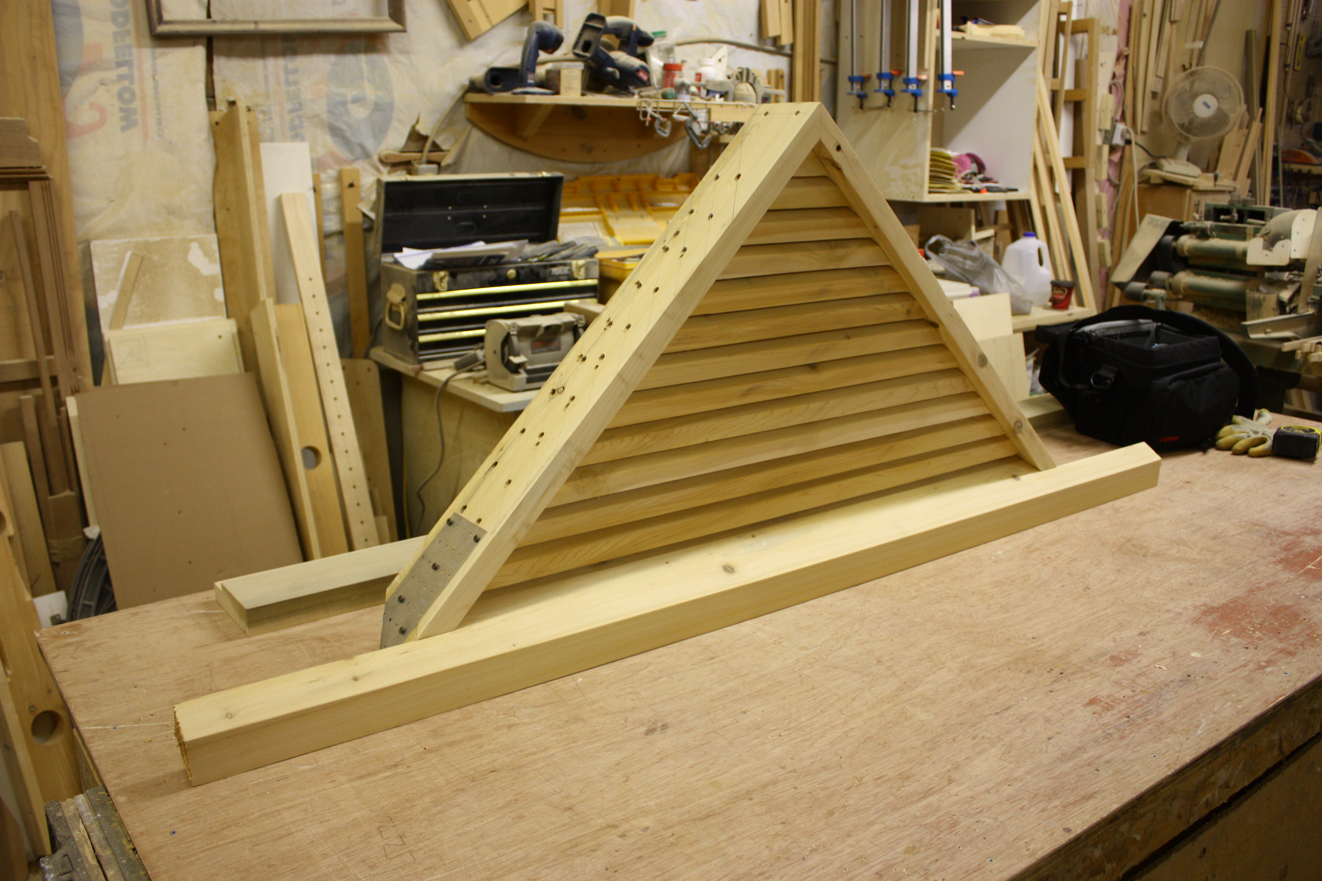

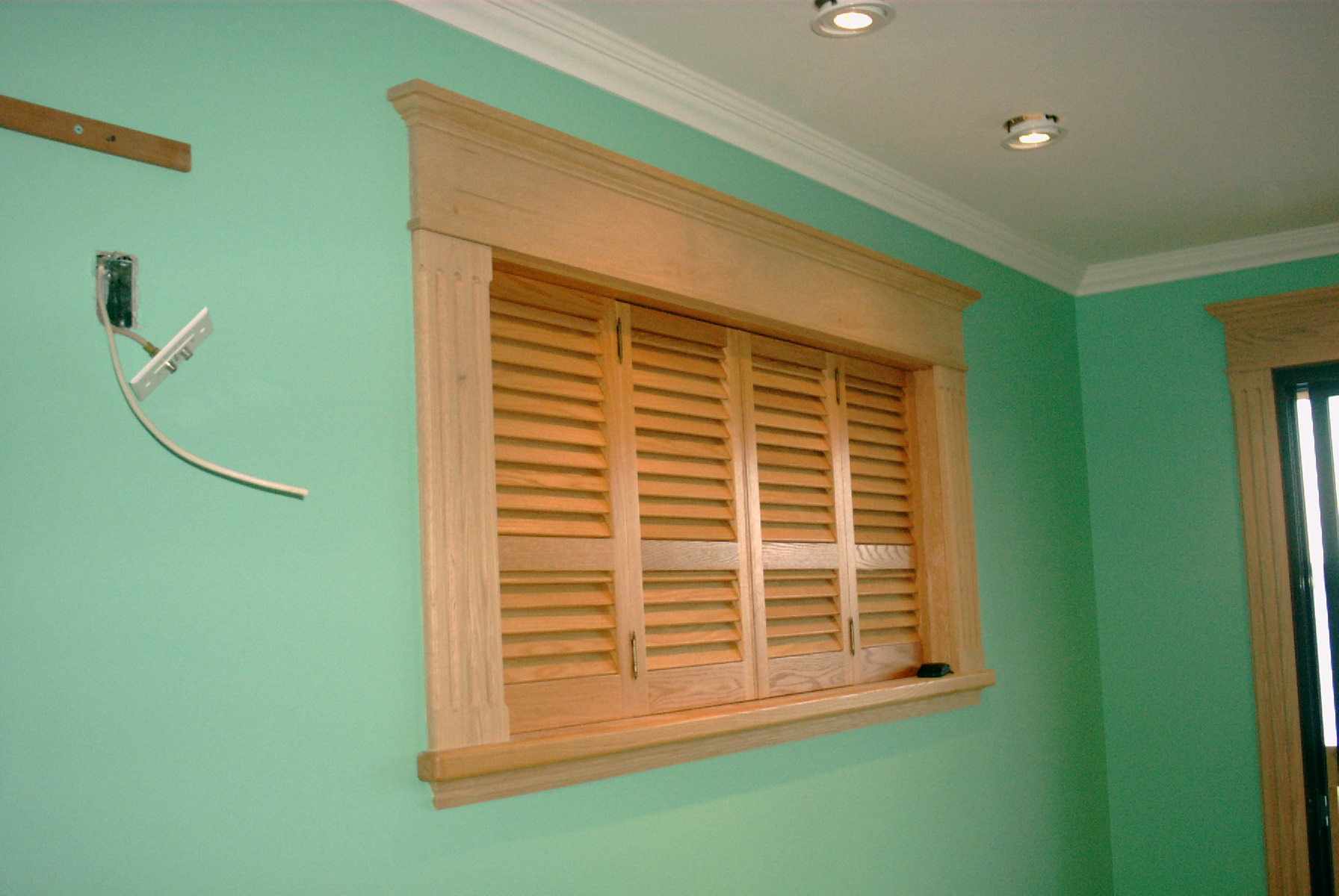

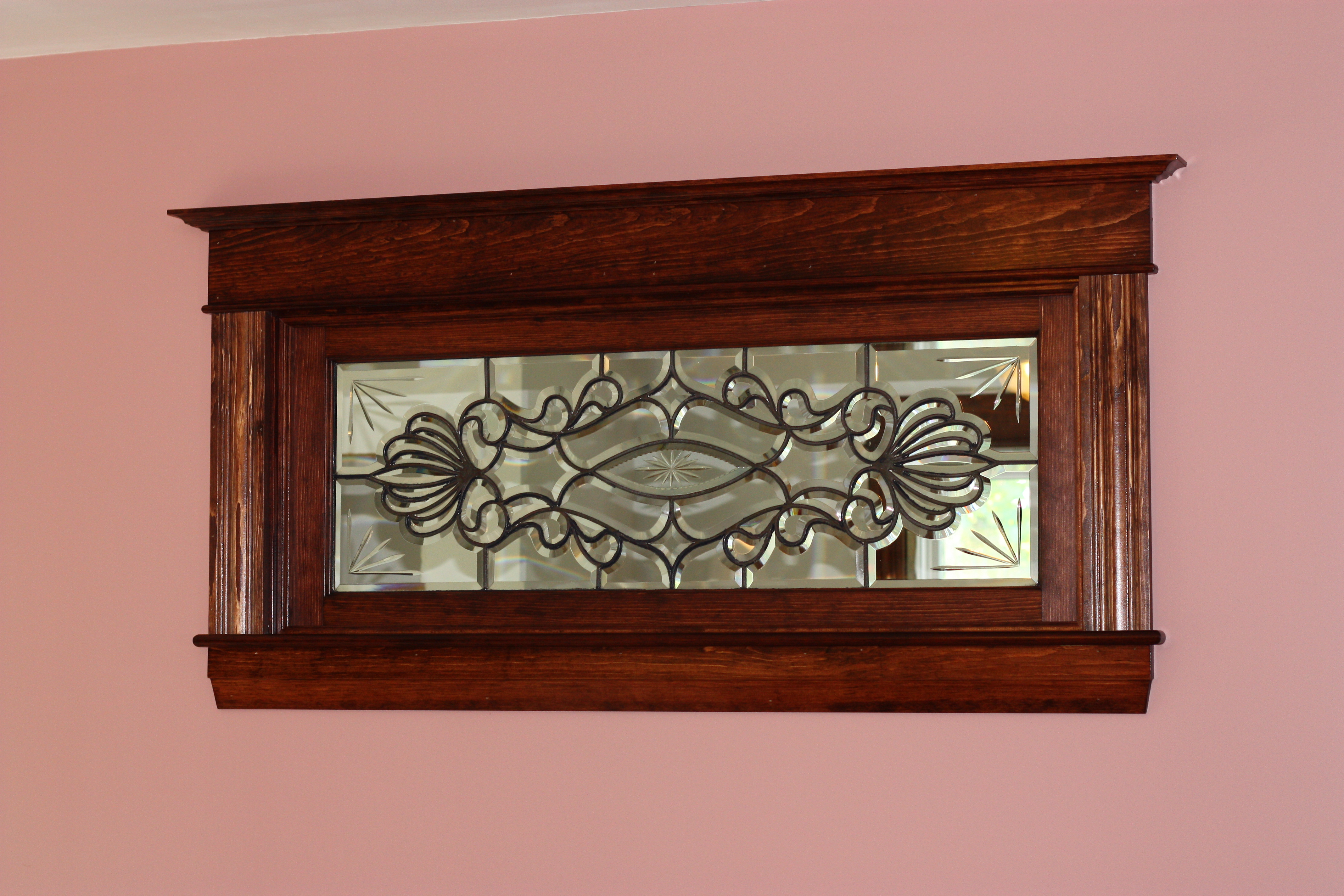

Well I gotta say , there are some pretty hard acts to follow (beautiful work) in this thread but I will throw some pics in here just for the heck of it. I have been working as a custom woodworker since 1985 and it's been good to me .

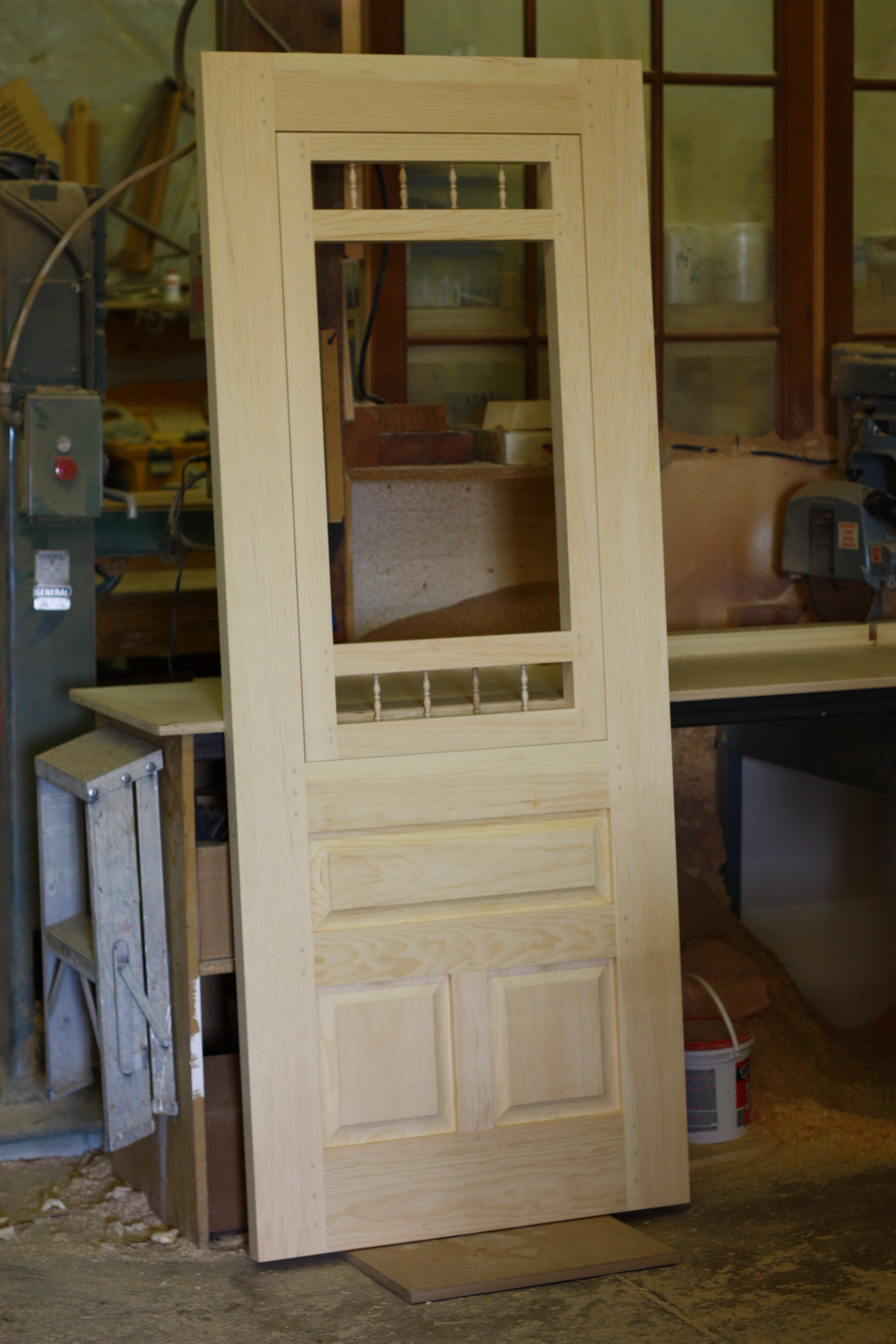

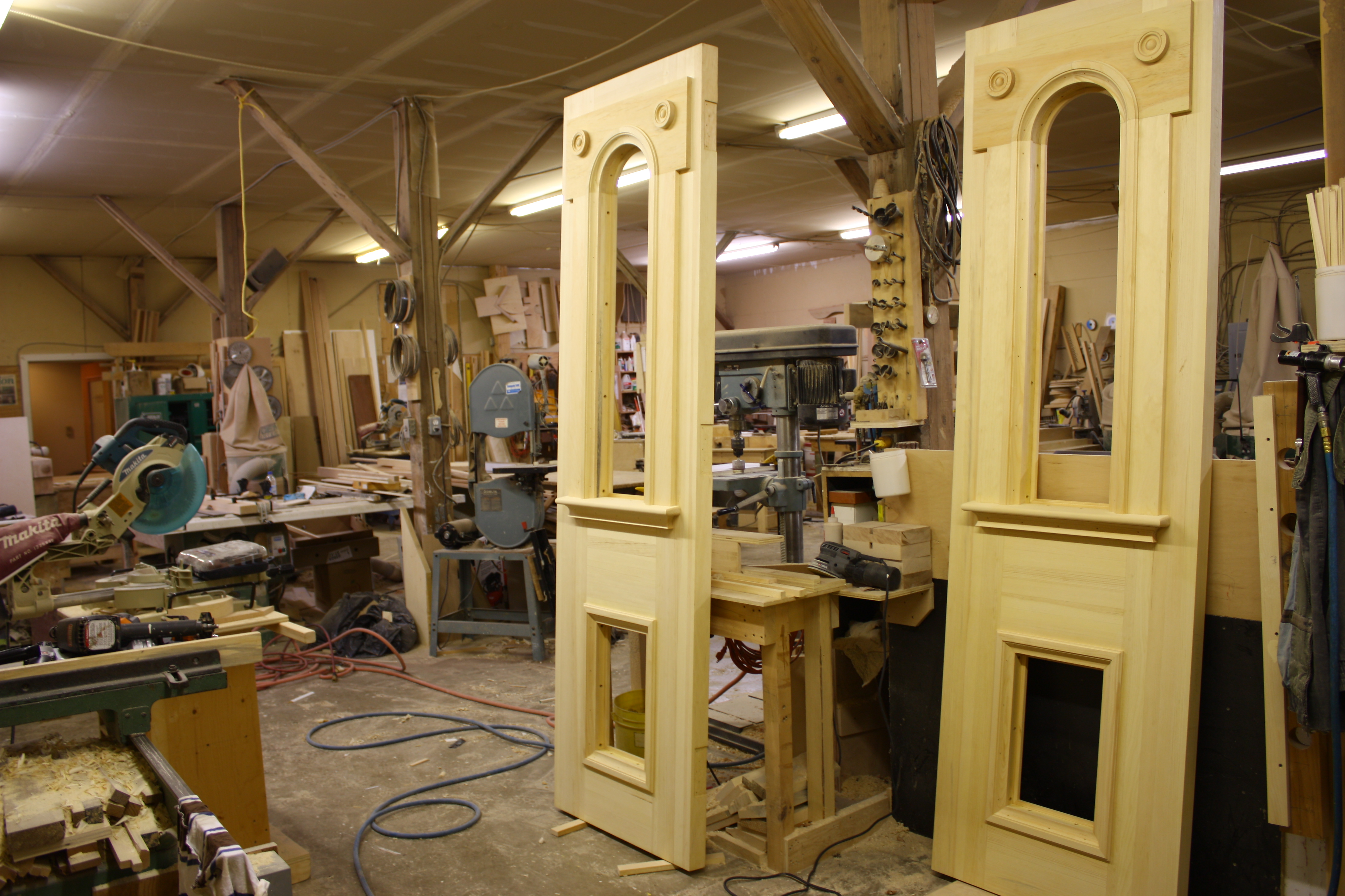

Very nice. Do you have any special tricks for keeping your doors flat when putting them together?
   / Lets see your Woodworking Skills #123
I have found that a piece of kd lumber that has a bow, bad cup or hook will tend to do it again a few days after it has been machined . No good for a door . Another thing is to make sure all your tenons and mortises are cut true and square . 1 or 2 degrees out will really give you grief .The last thing is a good flat bench to assemble on and clamp under and over your door to make sure you are not drawing your stiles too much in one direction. That being said , wood is mother natures own product and sometimes it does what it wants regardless of how much care you take :)

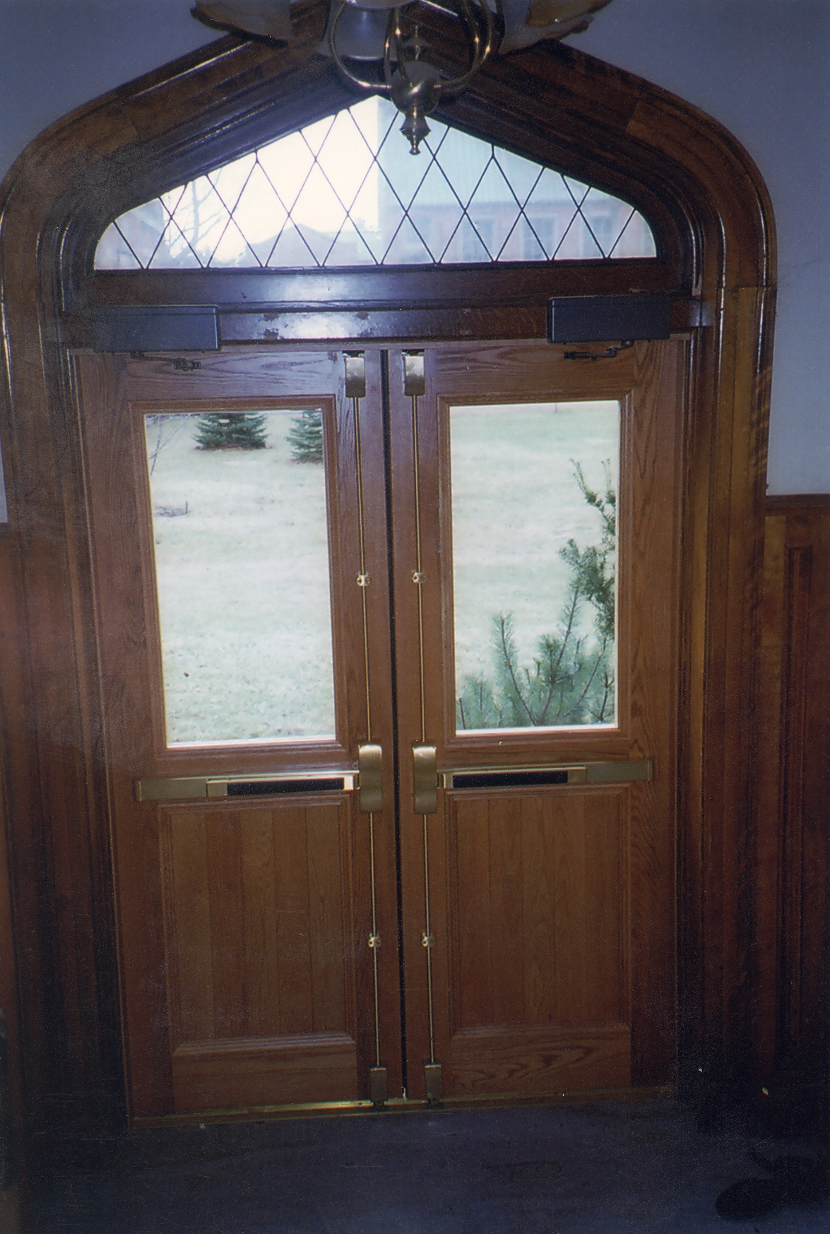

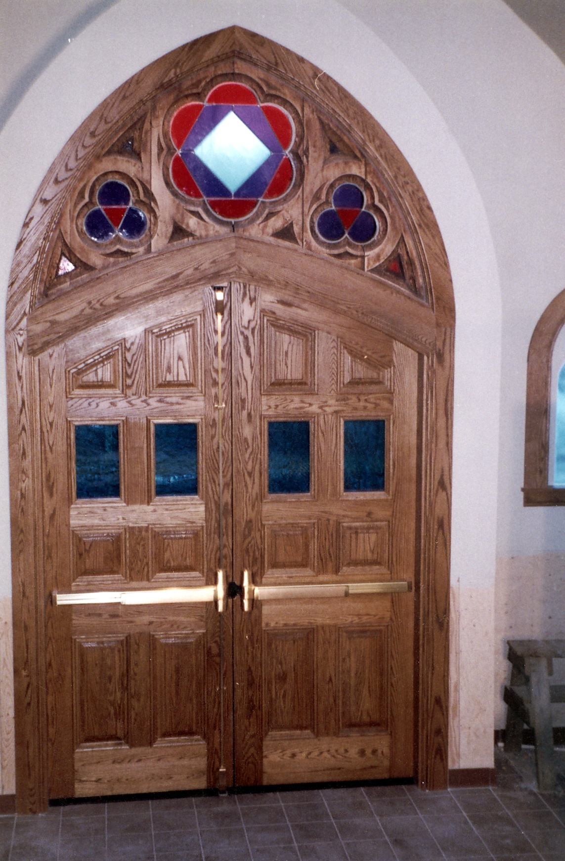

That last door is pretty fantastic! Antique glass? Did it move arround on top once installed?
Actually it seems to have sagged to the left since it was installed ! :D
