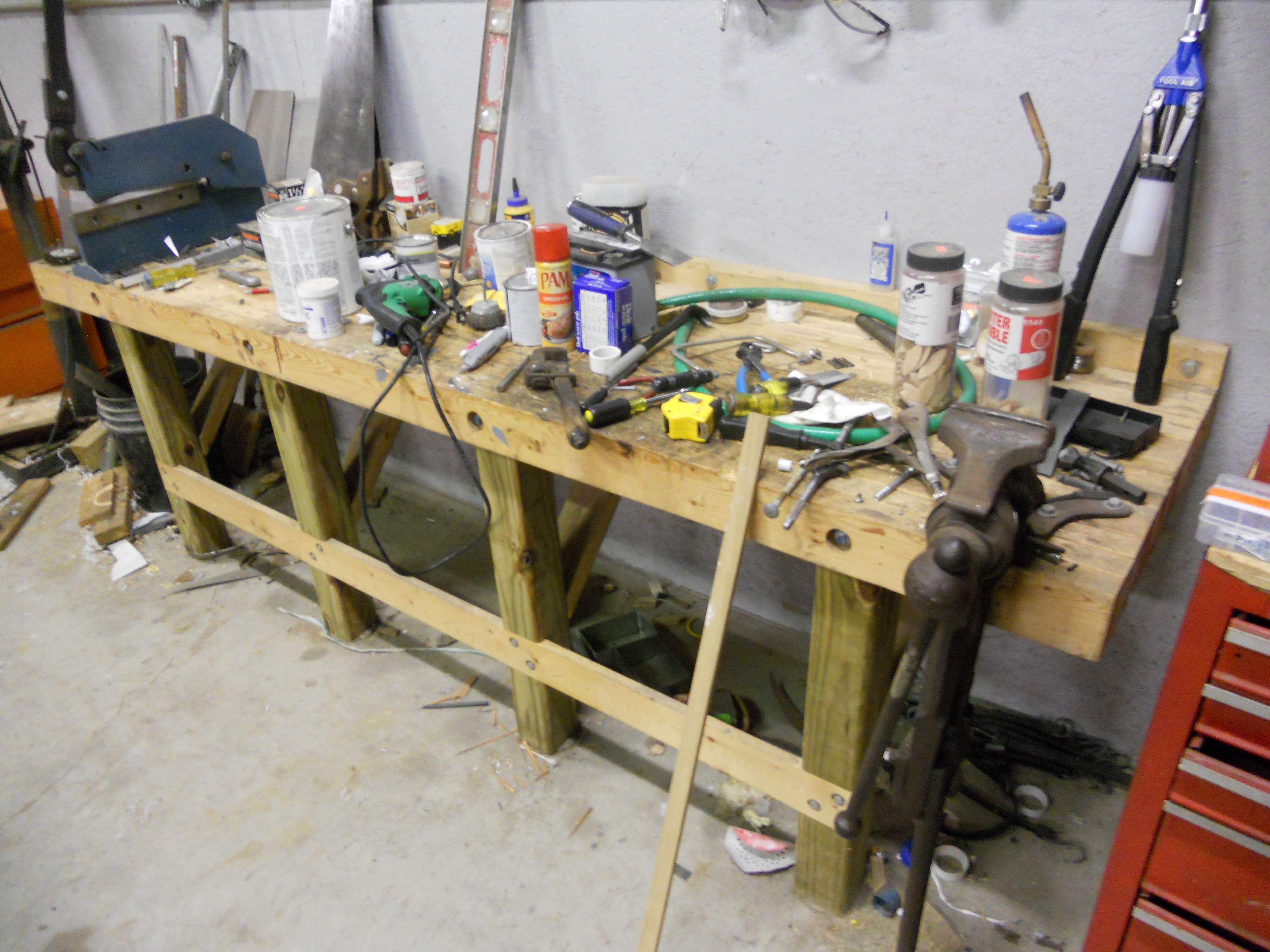

<img src="http://www.tractorbynet.com/forums/attachment.php?attachmentid=349315"/><img src="http://www.tractorbynet.com/forums/attachment.php?attachmentid=349316"/><img src="http://www.tractorbynet.com/forums/attachment.php?attachmentid=349317"/>349318[/ATTACH Here are two of my benches. The first one is solid magnesium. It measures 2 feet by 8 feet in length and weighs approx. 400 pounds. I tried to get a good picture of a polished corner but it didn't turn out well. The second bench was constructed years ago with 2x4's . It is 8 feet long and is bolted together with all thread rod. The wall side 2by is a 2x8 to allow sufficient area to be bolted to the wall. The legs are mortised into the top. This bench is extremely stable and takes a lot of abuse.

Dang. Sorry about the pictures. Ill try to repost them. The magnesium bench is about 9 inches thick with a honeycomb pattern underneath. I don't know why someone would want a magnesium bench either. I bought it from a machine shop that was going out of business.
