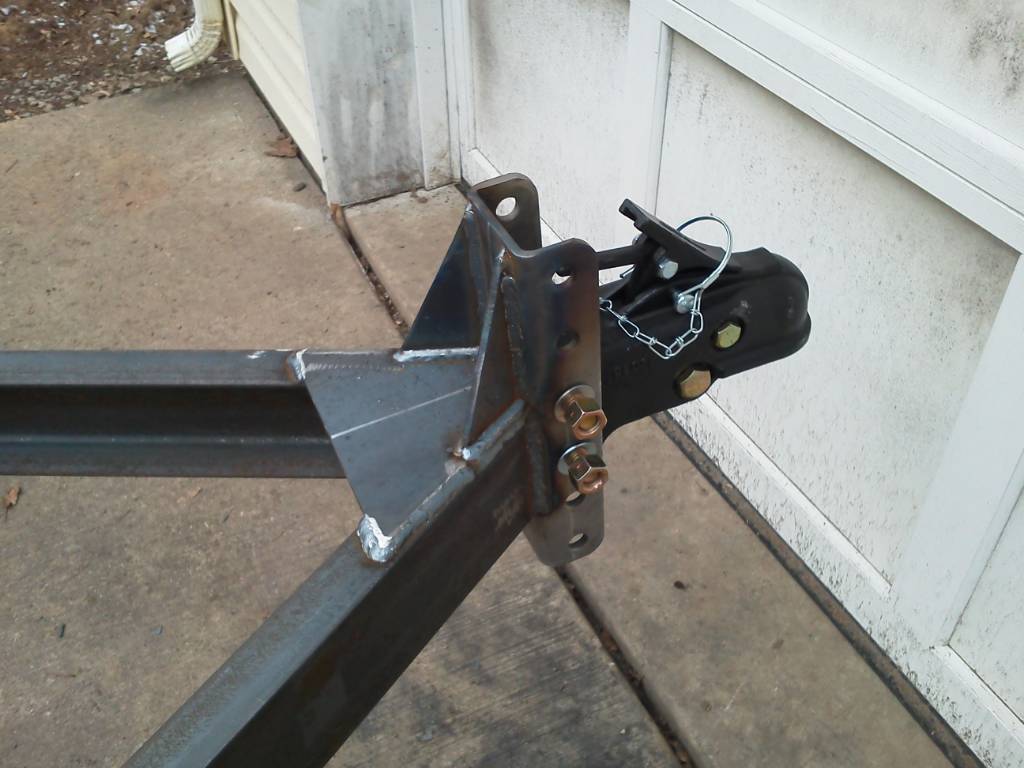

/ Lets talk about your balls #17
When I extended my 7k equipment trailer I used a 15k adjustable coupler, overkill but I didn't like the quality of the lighter couplers.198173832.jpeg
/ Lets talk about your balls #18
When I extended my 7k equipment trailer I used a 15k adjustable coupler, overkill but I didn't like the quality of the lighter couplers.View attachment 669686
Those adjustable height couplers are by far the best. The OP probably wouldn’t be needing such a high drop ball with one. Even if he does manage to find one a drop hitch severely reduces the vehicle hitch rating. Another benefit to the adjustable hitch is it’s easily removed for theft prevention.
