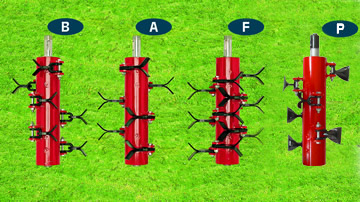

So what type of blades should I be looking at. I know that the hammer type
cost more to replace but most do not have shackels. So if you take the cost of
both the shackle and the knife and compare it to a single hammer I think it
closes the gap some on cost.
With all of that said would a B type rotor or the P type Rotor from Caroni be
better for me?
Also in looking at the picture of both the B and P rotor the mounts look the
same best I can tell in the picture.
So if I ordered the P rotor type could I also order the B blades and switch between
the 2 for the best of both. I do understand that it would be all the blades no
mix and match.
I don't mind spending a little more if it will work better for me-a few 100 not
1,000.
Lastly and maybe someone else can tell me I am assuming that the P rotor is a
hammer type blade in the picture, If it is not and actually a scoop type how
does that compair.
Thanks for the input.
This is the link to where I got the picture.
Caroni S.p.a.
A) That is a scoop/cup blade on the P rotor

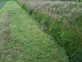

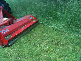

As Leonz noted the P rotor is not for hammers but mounts the finish cut scoops. The B rotor and blades are the ones you want IMO. I'll post a few photos later of thick grass mixed with brush pre and post B rotor treatment.
   / Let's talk flail mowers #999
Here are a few. More to follow
