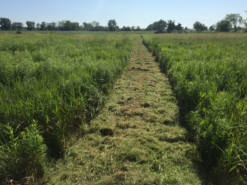

I just put about 15 hours of use on my new flail mower, this flail cuts with the nifes spinning in the same dirrection as the tractor moves im not shure the bennifits of this but as comparision my side arm flail mower cuts in reverse to the dirrection of travel and seems to have a much larger amount of vacume pulling the grass up and out the back of the cutter. It seems that most of the grass clipping on this mower gets thrown against the larg roller and doesnt get tossed out the back like i thought it would, now this isnt a probblem it just not what i thought would happen,
As far as performance goes this flail mower seems to load the tractor down just the same way as my 6 foot rotory cutter did it also bogs down in some areas of the feild just as the rotory cutter did so for me im still moweing at the same grownd speed as i did with the 6 foot rotory cutter. the main differance is that its cutting a wider path, it dosnt throw objects out the back not even grass clippings and when you do hit something like a rock its compleatly un-eventful. my 6 foot rotory mower has thrown wire and other metal objust into my rear tires and brocken out my windows, i cant see this ever happening with the flail.
As of now im mowing feilds that i previously mowed with rotory cutters and it left rows of dead grass and it will be a while till all the piled up grass clipping have rotted away.
the only thing i dont like is that it cant mow in reverse because the roller pushes the grass down out of the way of the cutter nives.
oh ya i ran over a tire today and all it did was make some noise and then jump over the tire the rotory cutter would have scared the heck out of me and then sent the tire into the next county:cool:
