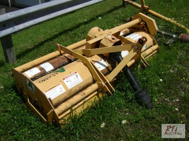

Do you have the capability of dynamic testing and balancing of the rotor? That is the most critical part of the fabrication as the rest is really just a PTO or hydraulic power transfer device. If you don't, perhaps it would make sense to bite the bullet and purchase a rotor from Alamo or Caroni or one of the other companies that make these mowers. You might find it cheaper in the long run to purchase a PTO flail and convert it. Depending on what duty machine you want, that might be the cheapest and fastest way to do it.

My center shaft is 9" in diameter (think the book said 3/8 wall thickness) not including the shackle or knives. It is a Bomford/Turner commercial model. The overall weight is 1258 if I remember correctly.
Hope that helps
I'll certainly have the shaft and blades balanced after construction, it's possible to buy flail mowers in Australia with the bobcat attachment but they are insanely expensive. The other option is to buy an second hand pto unit and convert that. Just love designing and making things! It's a disease I have and there doesn't seem to be a cure!
Hope that helps
Thanks Code54, that may be a little too big for my hydraulics but sounds much better than the 3" solid I was thinking of.

Just sourced some 6 1/4" OD 3/8" wall cold drawn seamless hydraulic cylinder tube - $300 for 72" :)
Can't quite work out why these units are $10,000 dollars here! I know these are excavator mount units but there are some big margins as far as I can work out.
