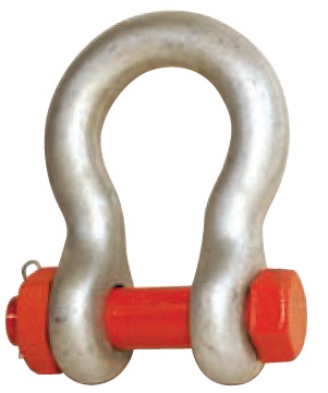

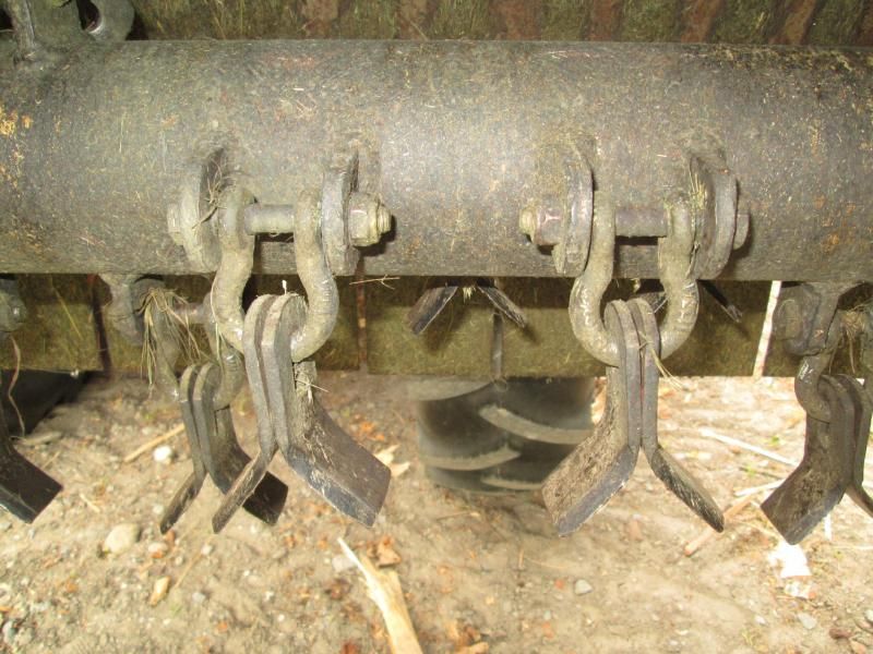

Hadn't checked on this thread in quite a while, but it seems timely that I did, with what is being discussed. I have had my Caroni TM1900 for about 5 seasons & like everyone else have gone through numerous clevis/shackle failures & hated to buy any more than I had to, due to the price. At the beginning of this season I replaced all the blades, bolts & shackles with no failures this year, so I thought I would share what is working for me.
I ordered the Flailmaster blades (108381, I think) mentioned a good ways back in this thread, used 70mm bolts (w/nylok nuts) instead of the stock 80mm to minimize the unprotected protruding thread & found some clevis/shackles (HERE) that have an un-threaded hole on both sides, that were around $3 each & fit pretty well between the station lugs on the rotor. The only glitch is that, with the curve of this shackle, it can get slightly bound between the rotor lugs when it is folded down, but nothing that the centrifugal force can't undo once the mower is up to speed. Other than that, they bolt right in.

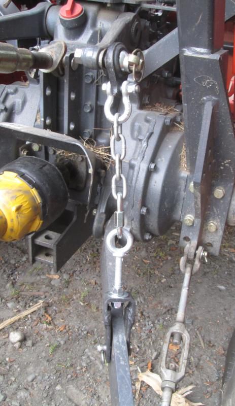

Another modification I recently made was to fabricate a flexible lift link to use in place of the adjustable link on my tractor. I have found that due to the offset of the Caroni that usually once a season I would tweak or break the right-side link when the far end of the mower hit a rise in the ground or the tractor dipped to the right & the mower didn't. There is a lot of leverage there but this flexible link allows the mower & tractor to move independently without snapping anything. I had used chain lift links years back with a rotary mower so I thought I would try it on this & it seems to be working quite well. I will occasionally watch the chain section of the arm & you would be surprised how often it relaxes. But it lifts the mower as if it were solid.

Great report TDVT.
1) Those shackles look to be roughly the same cost as the ones I got from Flailmaster but have the advantage of not needing modification to install. Looks like they are the ones to get rather than the ones I got from Flailmaster. (GME Supply Co, SHA38LRBT 3/8" bolt type safety shackle for future reference). I presume there was no difficulty getting the blades over the ears. If the slight binding bothers anyone, a touch up with a grinder would only take a second or two.

3) Your chain side arms for the 3pt are something I haven't seen before. Chain topping lifts are common but this is novel to me. I don't understand why your rigid arms bent. There is no restriction on a side arm moving up though I suppose as the two sides are linked up pressure on one side would need to lift both sides. That still doesn't seem like enough force to damage the side arms. Perhaps this is tractor specific. On my Kioti DK it doesn't seem to be a problem. The mower only weighs about ?500-700 lbs and the Kioti 3PT is rated for about 3000lbs lift so the individual arms should certainly tolerate at least 1500kbs each. I mow in uneven areas too but have never had a problem with the side arms.

If there is a concern with the new shackles wearing the station lugs, I think the shackles could be ground just a wee bit. Doesn't seem to be much contact area and it looks like they would still be much sturdier than the OEMs. Those look like they were made straight then bent into a U with a pretty sharp crease. My GUESS it that crease is where they break. Do I win a prize?? :) I suspect the new ones will last longer than most of us.

Regarding the use of cotter pins etc instead of nuts. That does sound reasonable and there are flails that use such systems. However, I often notice lots of tightly wound vegetable material (long grass, weed stems, etc) wrapped around the ends of the clevis bolts after mowing in high grass or brush so I would be a bit concerned about those materials somehow loosening and popping off pins. Perhaps this is not a realistic concern but it is why I have continued to use bolts.
The other point is that with the Caroni clevises, the blades are typically lost before they need sharpening or reversing anyways. Again, YMMV as I do largely brush mowing and simple grass mowing might not be as tough on the clevises.

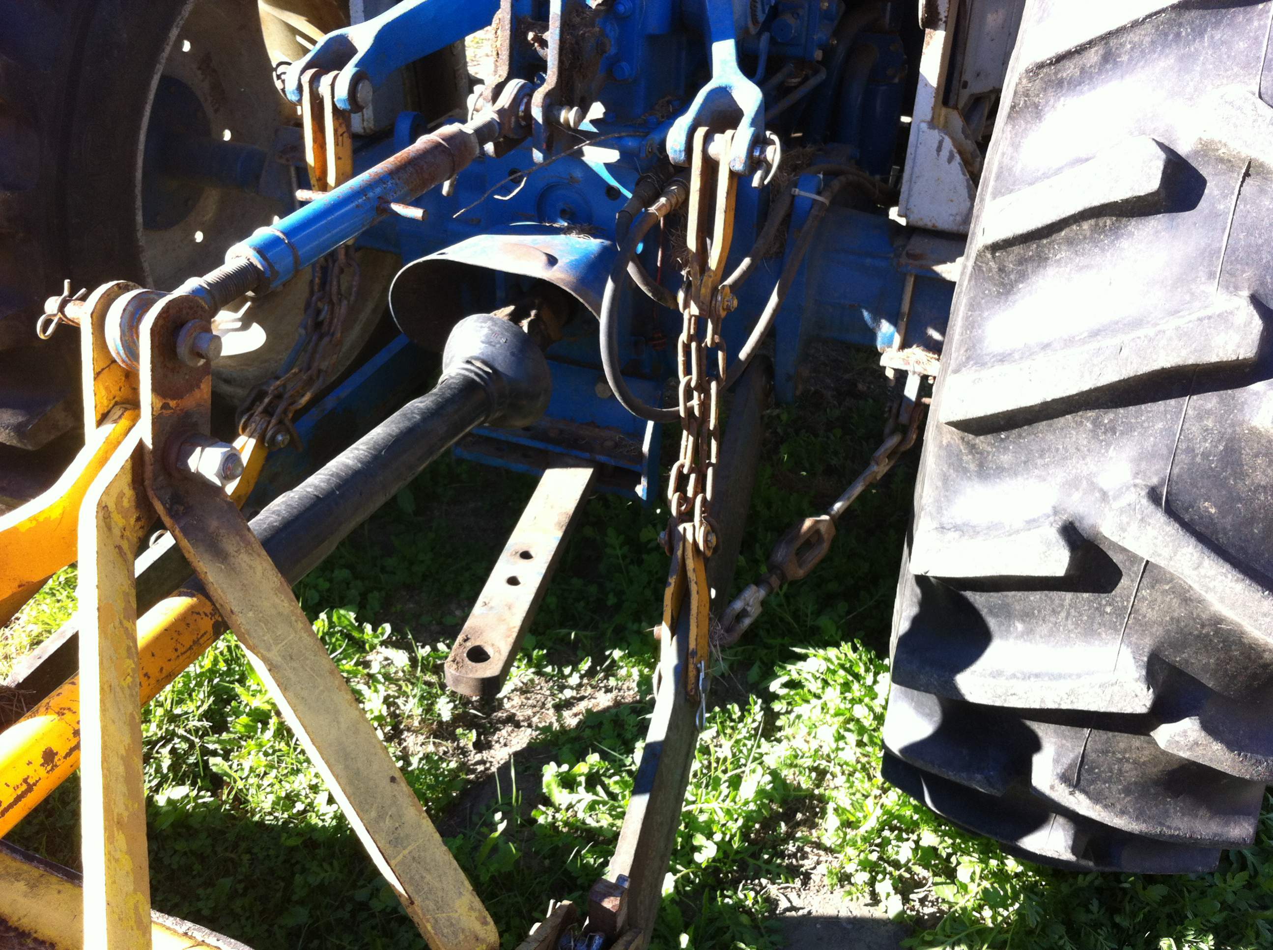

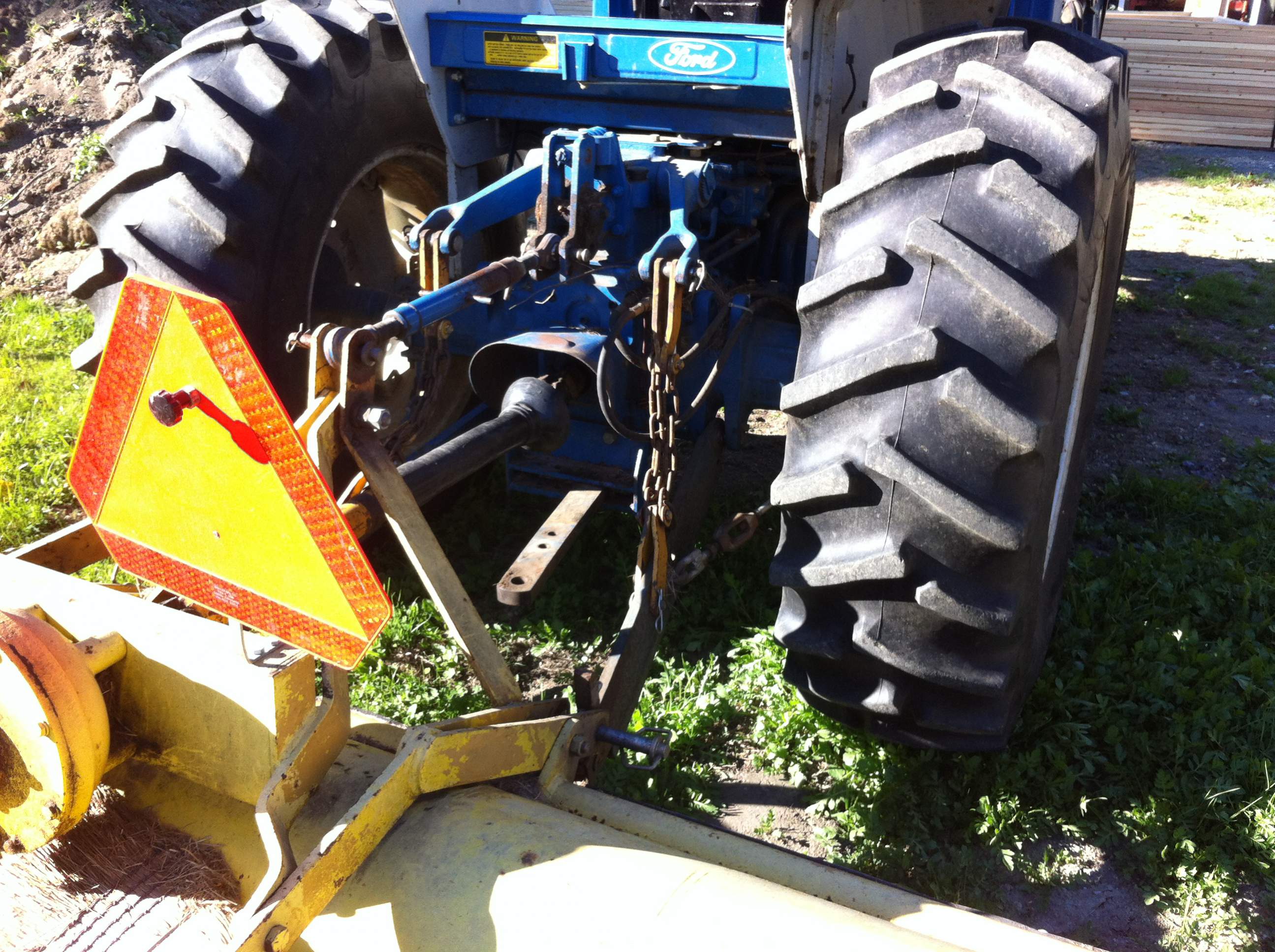

2014-09-22 16.24.31.jpg2014-09-22 16.24.24.jpgMy big old Mott mower has side chain supports, too. It must have been a municipal mower before I got it. I had to modify the chain brackets to use my standard Ford link pins but the mower does follow the ground very well. Well, as well as it can at 88" wide!
Jim
