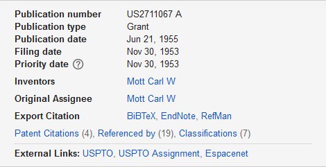

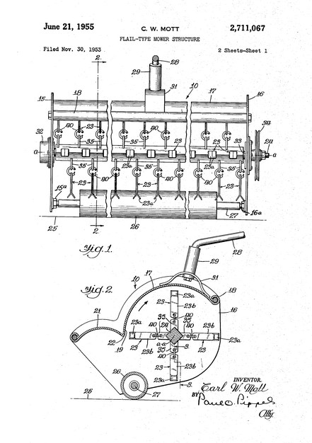

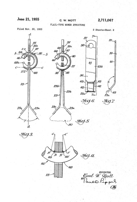

Just so we are all reading off the same page, here are the particulars of the original patent:
View attachment 440822View attachment 440823
Thank you for that whirly. It also answers my question that Elmer Mott was the son that took over the company and was friends with my dad. Mott's have a dynamically balanced rotor like a drive shaft. If they're vibrating, something is not right. Knives missing, bad bearing, bent rotor from hitting a large object, etc. that would also explain why it would leave stripes. I know when I needed to get a bearing for a Mott, it used a Sealmaster which is considered a premium bearing. Mott uses individual knife hangers and the key to changing them quicker is using the special cotter pins with a flat side to go up against the hanger. Using standard cotter pins is a pain because you have stop them from turning. SHD Alamo's also use 1 15/16" bearings which are considerably beefier. I've always said there's other good flail mowers but Mott being the originator is the standard and they've stood the test of time longer than any others. That's got to be worth something.
