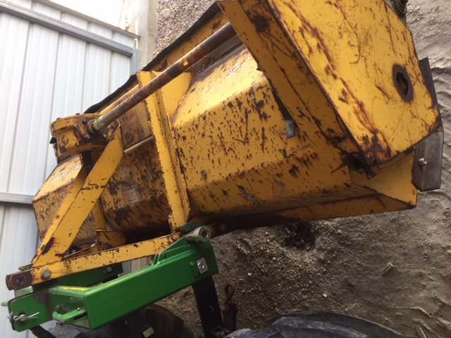

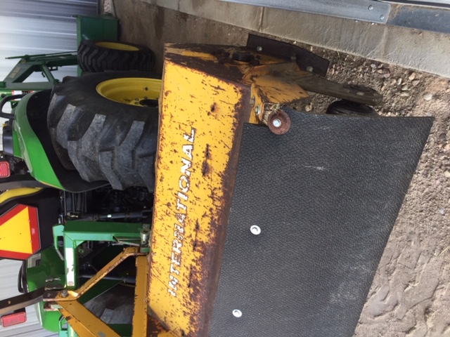

So I have two flails I wouldn't mind selling. One is a Mott that has some rust and needs a bearing for the rear roller. Aside from that it still cuts well. I used it today to make sure it still works and it's great.
Being no one seems to want to buy it (at least yet), It there anything else I could take it apart and use the gearbox for?
I also have a ford 907 but it's to sound of condition to dismantle
What have people turned their flails into
