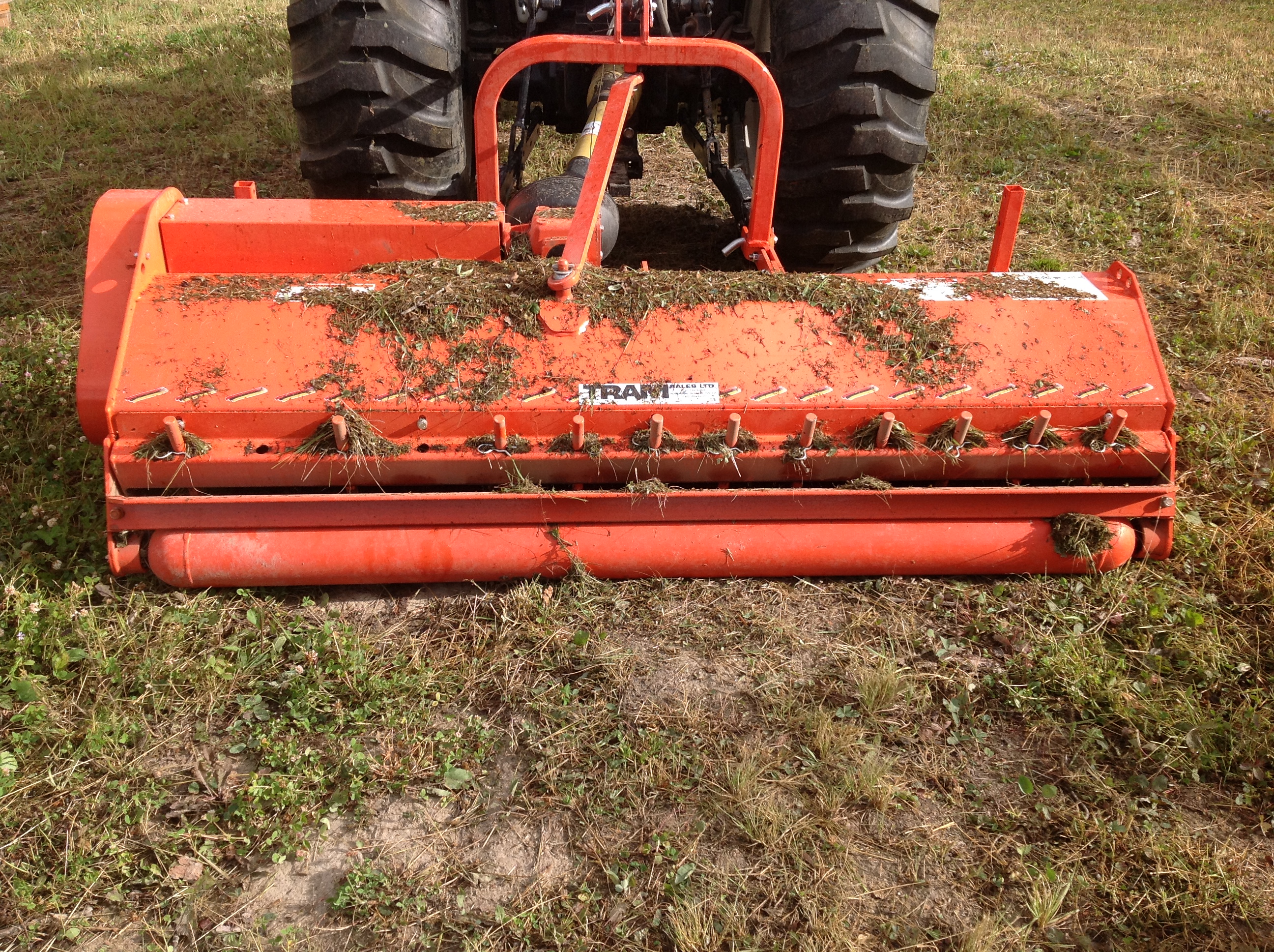

What are all the rods with the clevis pin in them. Have not seen that before
I believe they are what Leonz referred to as shredding bars. I guess they hold branches and other debris in the cutting drum so they are chopped up? I have a lot to learn, I'm sure.

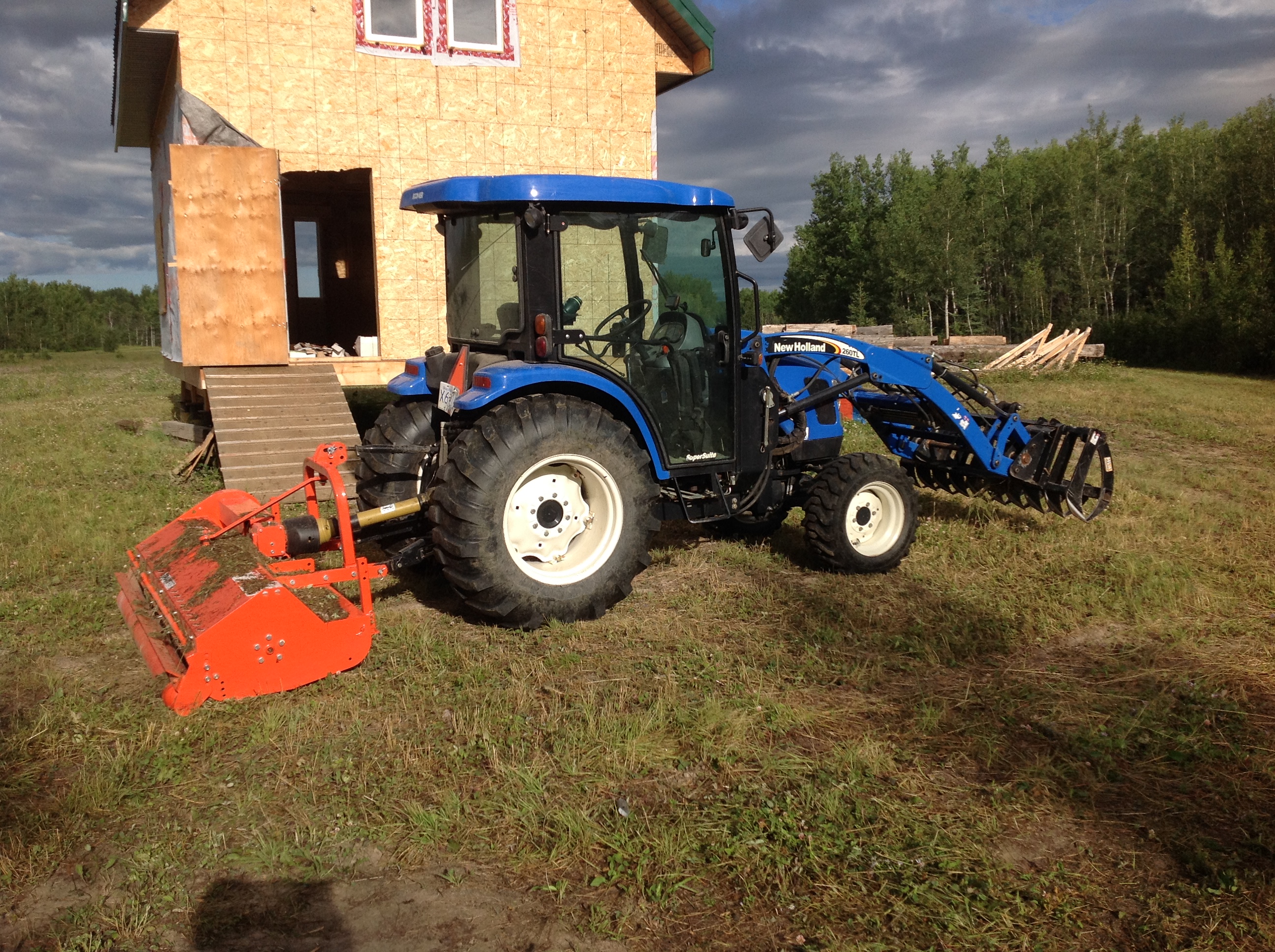

Well guys, I put the Sicma TE200 through a bit of a workout. Got 15 of 20 acres of 2' high clover small poplars and willow done in 6 1/2 hours. To say I'm impressed would be something of an understatement. I did manage to lose a couple of the shredding bars though. I'm going to have to come up with something better than the Cleve's pins I guess image.jpegimage.jpeg
