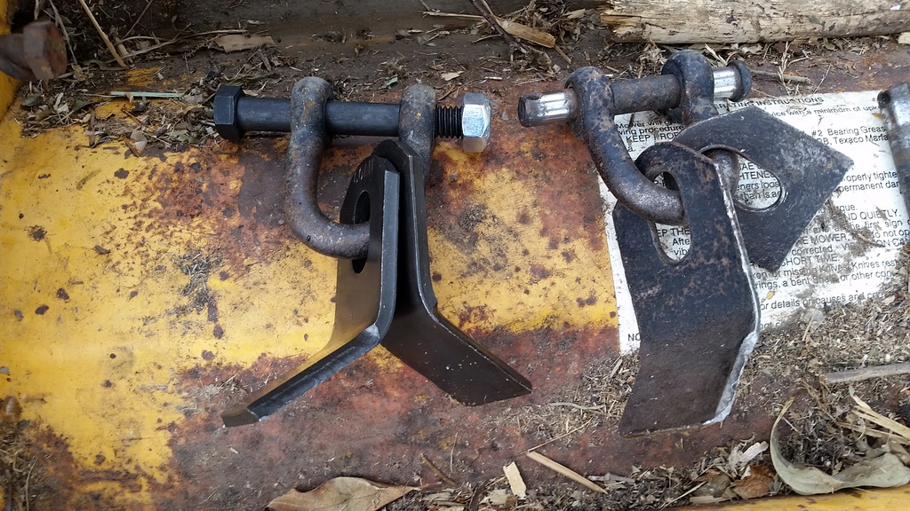

I've been doing some HEAVY clearing (some should be done with a rotary cutter, but I have to make do with what I've got.) After a long day of work, a look under the mower showed that many of my blades were missing or broken, and a LOT of the cotter pins were missing on the pins that attach the blade holders. I ordered a full new set of "Heavy Duty" blades from Flail-Master, along with new bolts/nuts to replace the pins and cotters. The blades are a lot thicker than the ones that were on it, which I am guessing were "standard duty", probably Alamo originals (I bought the flail from a county highway department.) They work really well so far. Still don't cut certain types of bushes down very well. The "stalks" of the bushes get stripped of branches and leaves, but the stalks just pop right back up after I pass over them. If I go over them many times, I get a few more each time, so I can eventually get them cleared, but this is where I think a rotary cutter would be the better tool. I do really appreciate the relative safety I feel with the flail. I don't ever hear anything being thrown any distance by the mower, and with 5 kids still at home, and 2 dogs, that's a good thing.
Scott in Penfield NY

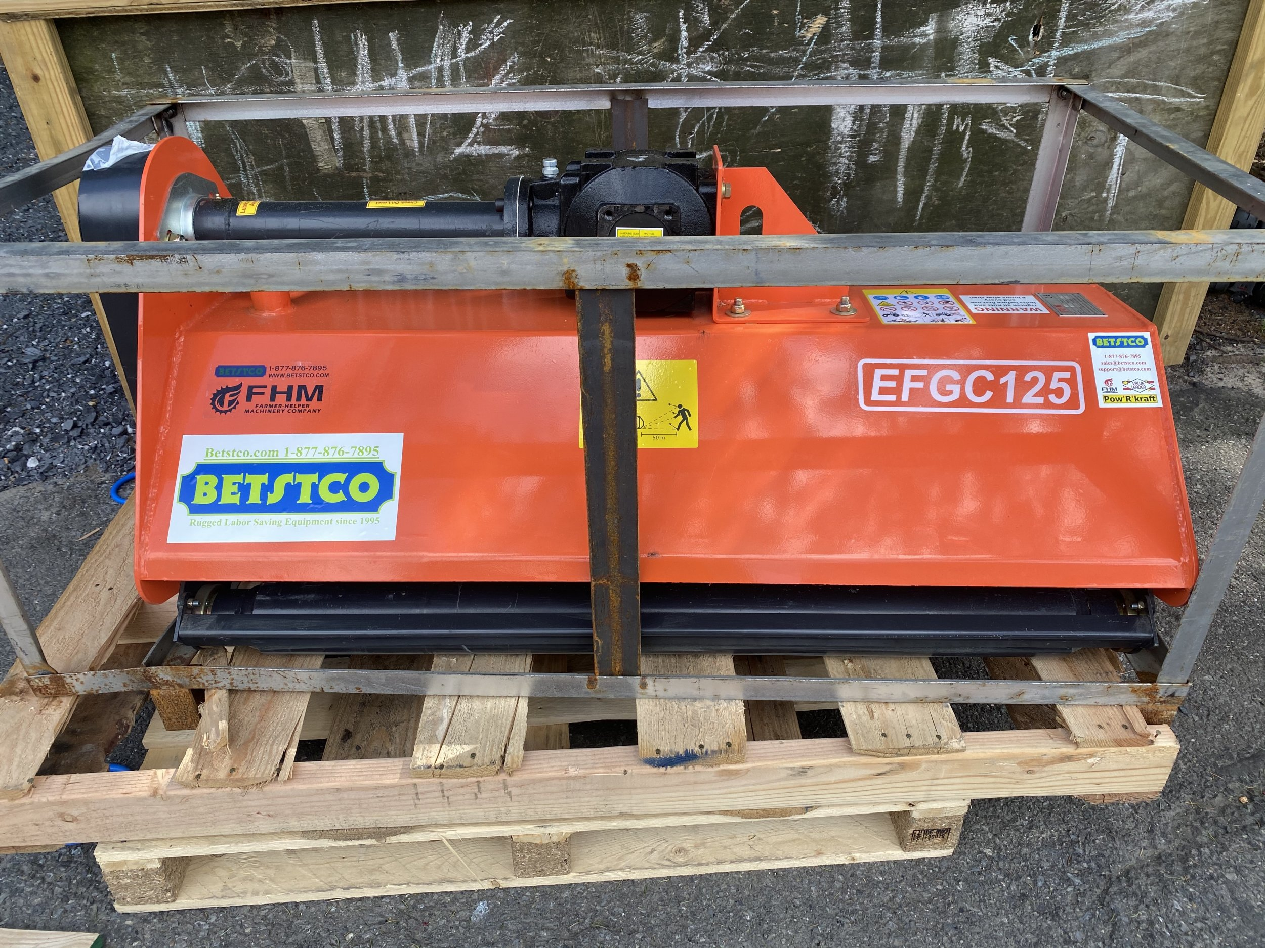

Has Betst gotten back with you yet on the issue? Can you return it? I also agree the knives look beat up in your last photo, but it is puzzling that both sides look kicked and warn.. Have you considered sharpening them and see how she does? Just curious.
Yes, they got back to me, but right as I was discovering the scraper could be mounted closer to the roller, so he just figured that would fix it. It made it better....but still seems like I'm ripping grass as much as mulching it and the ends of the roller still load up. No idea if I could return it, don't have the pallet or crate to ship it back to Oregon and would probably cost me $300-400 to ship anyway... Haven't considered sharpening them as I've only mowed with it for about 5 hours...I've spent enough time this week messing around with it that I could have gotten half a dozen other things done instead...
I ordered a full new set of "Heavy Duty" blades from Flail-Master..
Interesting picture there as the D ring mount might allow the two blades to "hydrofoil" out (spread apart from each other) as leonz said. Mine are rigidly mounted, which makes little sense to me as you have the wide 3/8" or so flat where the upper parts are together that just rips at the grass. Even if the blades were sharpened all the way up that wouldn't really become a cutting edge with them pressed together. I'd rather see something like one of these with all edges sharpened...
I've wondered about just spreading mine apart with the spacers that are already on the bolts, but would have to check overlap of the blades first. I also think the standard side slicers would cut more efficiently if the bottoms were ground instead of the tops. If you picture the angle of attack of the blade swinging up and forward into the grass grinding the bottom instead would lead the cutting edge into the material a little more square to it...

Hello dan,
Your neighbors mule will not make difference.
The issue is the "so called" knives that came with it. Take one pair off and measure the total knife height from Vertical, The Width and the size of the mounting hole and order a new set of hardened knives from Flail Master or Clean Cutter.
Sadly sharpening the bottom edge of the side slicers mounted on the flail mower will not help you as they will not be contacting the majority of the brush at all(less than 1/4 of an inch width of cut as the other edges will just tear at the brush.
Once you have the knives changed you will see a huge difference.
I am sorry your going through this due to thier poor quality control and manufacturing.
