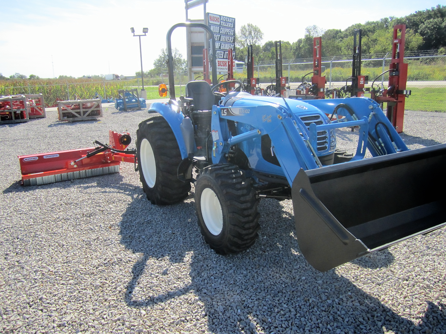

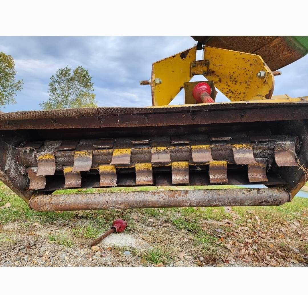

Just a couple of photos of the unit I am getting mounted on a similar tractor to check dimensions.

I see most of you are using flails to mow pastures, lawns, etc. I want to use a flail for two purposes: mowing fence lines (so the electric won't short out... maybe this will require weedwhacking regardless), and mowing cover crops in a raised bed vegetable production system. My tractor is about 59" from the outsides of each rear tires, leaving about 36" in between the wheels for a vegetable bed. (The beds will be permanently maintained by using the same tire tracks). Cover crops will be planted in both beds and pathways/tire tracks. When it's time to mow, I want the mower to mow only what's "in the shadow" of the tractor - in other words, I don't want the mower to stick out to the sides, because then it would mow down vegetables growing in the adjacent bed (if there are any). This means I need a 59" mower with no offset. There is a 59" Caroni, but it appears to be offset. Is there any way to center it on the back of the tractor so that it stays within the tire tracks?
Added question: The 48" version is also an option, though less useful for maintaining fencelines. Does anyone know whether the offset would go out to the edge of my right tire?

Knowing your tractors information will help with the options as flails are horsepower hungry, and going slow can be important too.
Offset ability will help with mowing fence rows, but some string trimmer work will still likely be needed.
Some of the apparent offset in mowers is the belt drive that hangs out. any 59 or 60in mower should be able to mow only the width of your tractor by adjusting the 3pt hitch to center it up.
The woodmaxx FM62 has a mowing width of 59in. it also has the rear trash door that opens for mowing thick cover crops. It is also available with hydraulic offset if you want it. I just purchased an FM78H and with my limited use so far I'm veryhappy condidering the price.
There are several others here that really like the Caroni and I thought hard about it as I wanted that rear door so I can mow very thick crops like buckwheat, cowpeas, clover, etc. to a fine residue.

You can purchase a flail mower with a hydraulic offset boom to mow along fence posts and in row.

Many of the Caroni flail mowers can be re adjusted manually to either an offset or centered position strictly depending on the model you purchase.
Other than purchasing the hydraulic offset for the "specific" Caroni Flail Mower the only viable option for fence row mowing is a small weedbadger with limit switches which have worked very well for many years by automatically adjusting the width the mower travels from side to side.

Arrows - you may be in luck - several of the Peruzzo ditch bank mowers will center behind your tractor and offset to do fence lines. Look at both the Elk Cross and Fox cross units. They also can be raised to mow raised beds. Iowa Farm Equipment has information on them and dimensions you can check on how things set up. If your not handy with metric units, I use the following link to help. Convert centimetre to inch - Conversion of Measurement Units. Andrew with Iowa Farm equipment was very helpful in my quest. The other brand that may work is Maschio. They have several lines that might work centered as you need, and then offset to get into the fence lines between the posts just like the Peruzzo. Also look into the weed badger as leonz has recommended. He was a great help to me in my quest. Good luck and let us know what you find.

The tractor has 25 PTO horsepower, about 30 engine HP. There are many low gear speeds (1st Low is verrrrry slow).
I mean, I guess the cheapskate option is to scythe everything (I already have a scythe), and if I need the material on the beds chopped up more, I can use the landowner's lawnmower after it's died back for a couple days. It's just that everyone who's knows anything about cover crops for vegetables agrees that flail mowers work the best for chopping it up into even-sized pieces and not leaving windrows or scattering everywhere. Some people just moldboard plow it in, but I've read The Plowman's Folly. I have a chisel plow that will get caught up in the trash easily - it needs everything chopped up. And obviously there's the all-too-popular herbicide method, which I will not do.
The Caroni website actually was more helpful than I expected, showing the hydraulic shifting positions. I'll need to go out and measure again, but it looks like having 800 mm sticking out from the PTO shaft still might be a little too much. Only the TL1200 (48") has a shifting position that allows less than 800 mm sticking out. But it's still gonna be wonky with only 450 mm being cut on the other side of the PTO shaft. *sigh*
The weed badger... does not look like the right tool for the job. Yes I can see how it would be useful maintaining fencelines and orchards. But I don't need to spend that much money on something that only maintains my fencelines. I don't see anywhere on the website where it explains how wide the tiller is, but it looks like it can't be more than 12 inches or so, so to till the whole bed would require multiple passes.
The woodmaxx looks like it might work. I will consider it. It's too bad that flail mowers, and specifically flail mowers less than 72+", are not more common used/craigslist.
I like looking through the Italian agricultural websites, thank you for those suggestions. It looks like Maschio has an American importer in Iowa. Not sure if Peruzzo has an importer.
