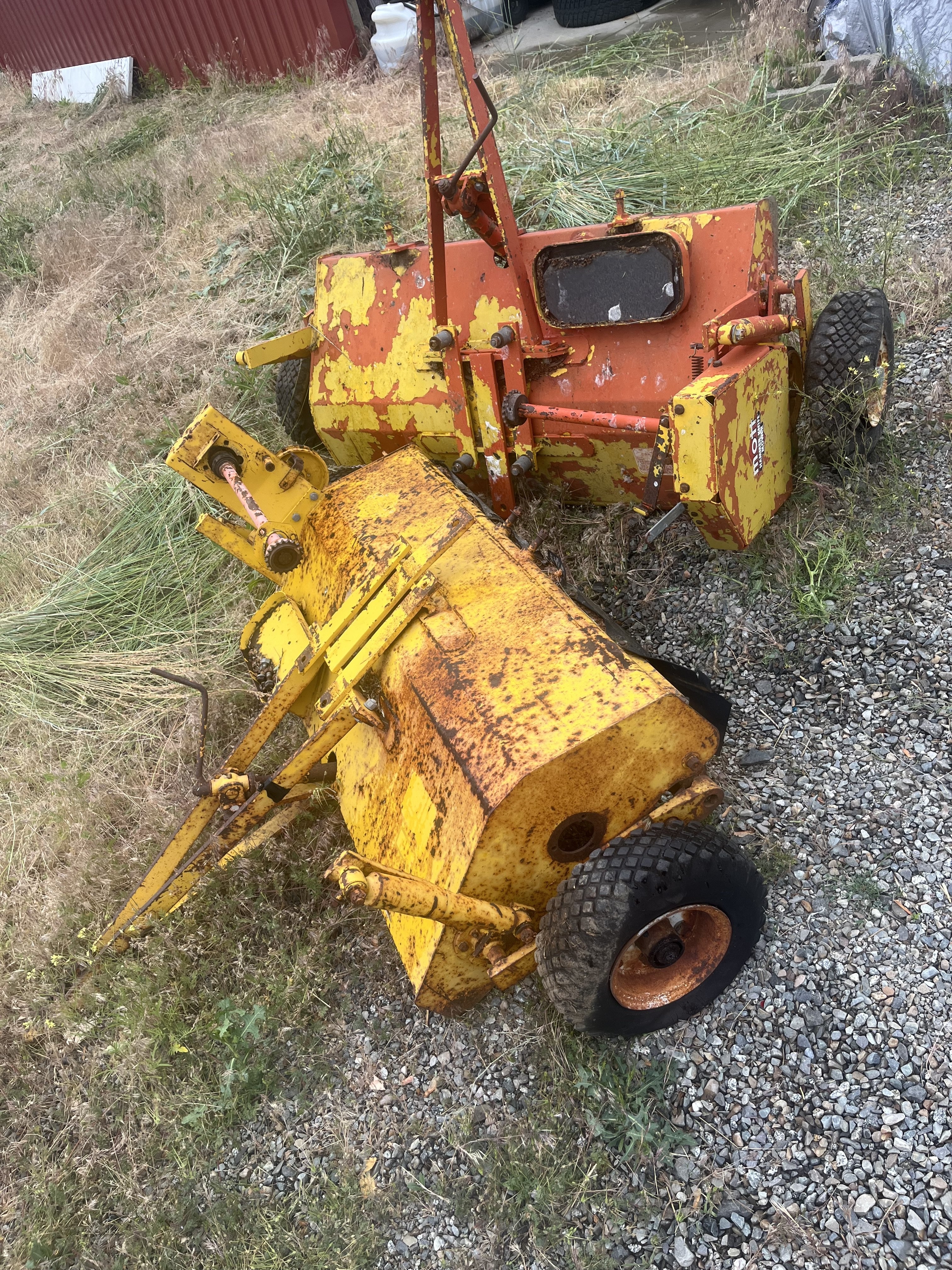

I have a Ford 917 flail that I am going to sell. Everything is in good working order. Give me a guestimate on a reasonable asking price.
