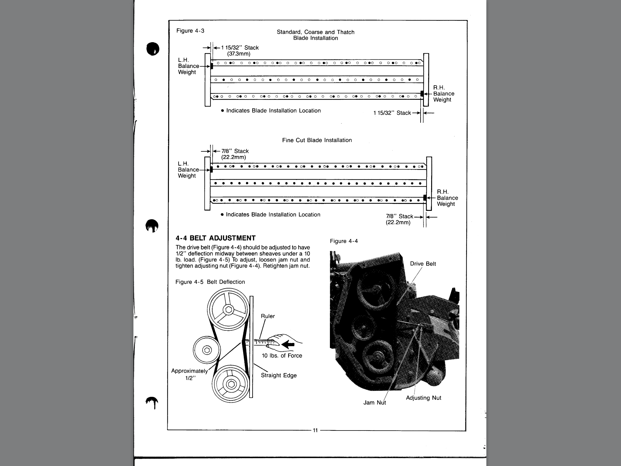

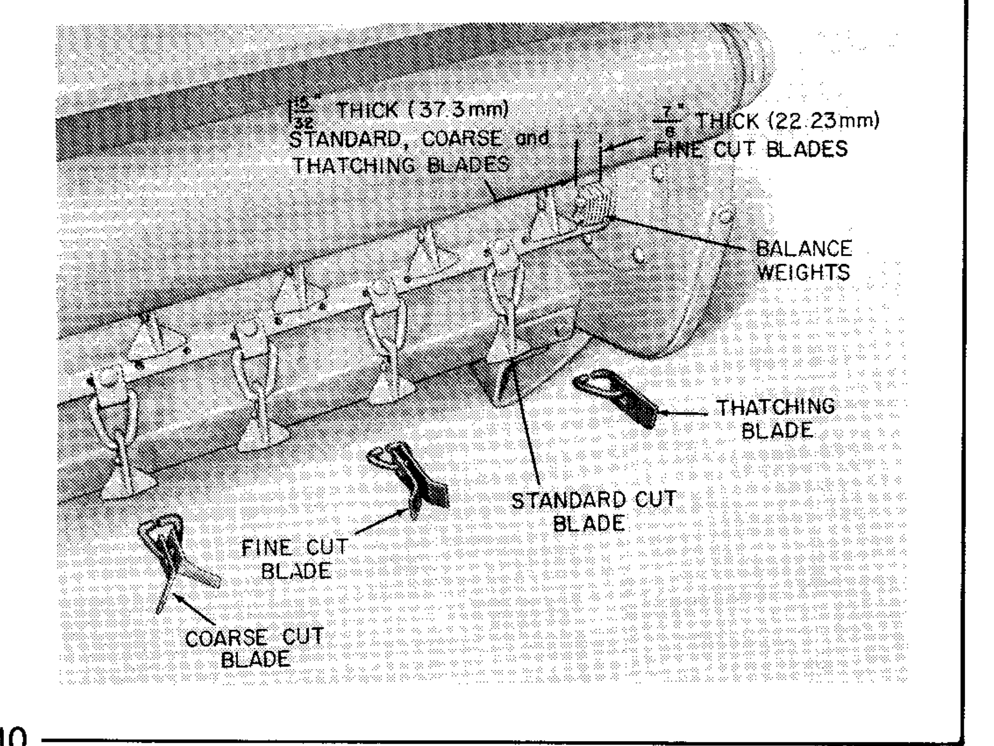

Flail-Master was kind enough to email me the manual for my Bush hog FH188 and it appears that the style of blades that are on my flail never came on this model, and the manual says that there are adjustment weights that are also missing, maybe that's why I'm getting a vibration.

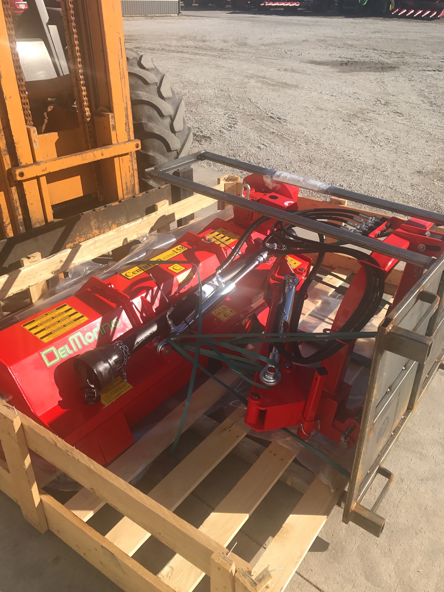

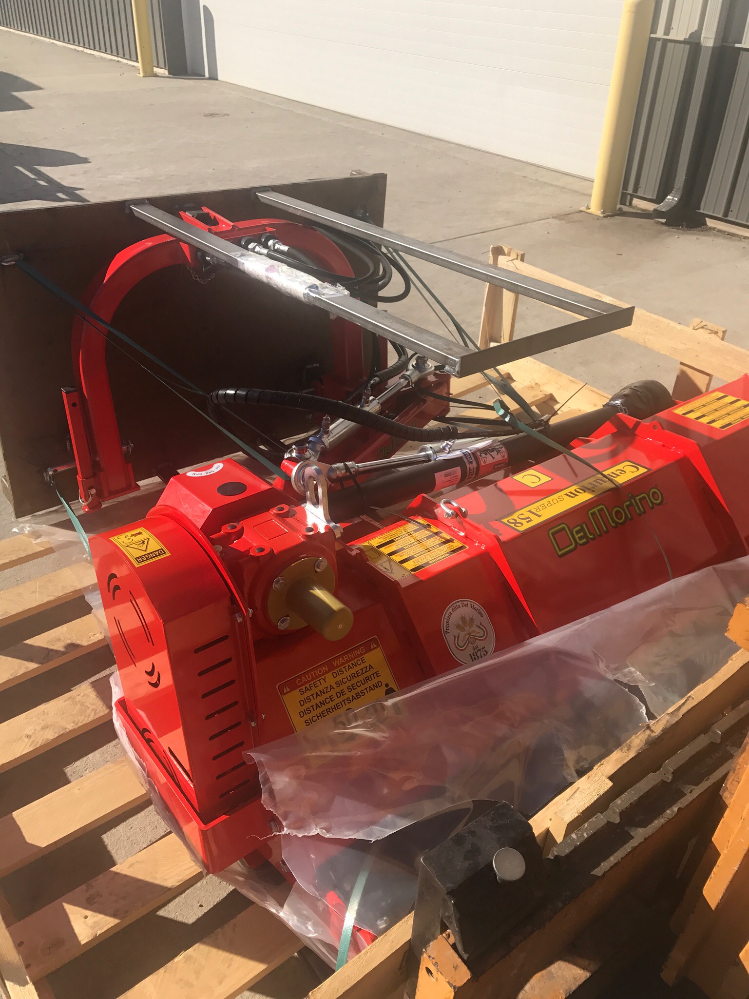

All, Update on my progress. I went and picked up the Del Morino today. This is the centurion 158M super. This is outfitted with knives vs hammers. Interesting that they ship them standing upright.:confused3: I laid it down for transport as you see in the pictures. If there is interest I'll report back on first use in a couple months. Initial inspection =:thumbsup:
I pick up my tractor tomorrow and the grapple is awaiting the tractor. Things are finally coming together!
View attachment 500724View attachment 500725View attachment 500726
Shipping them upright permits them to fill a container with more units of the various models of rototillers, flail mowers, rotary mowers, and other Del Morino implements per container coming across the pond as the more that they stuff in them the less costly the shipping is per container for them.
Make sure you check the gear box for oil too.

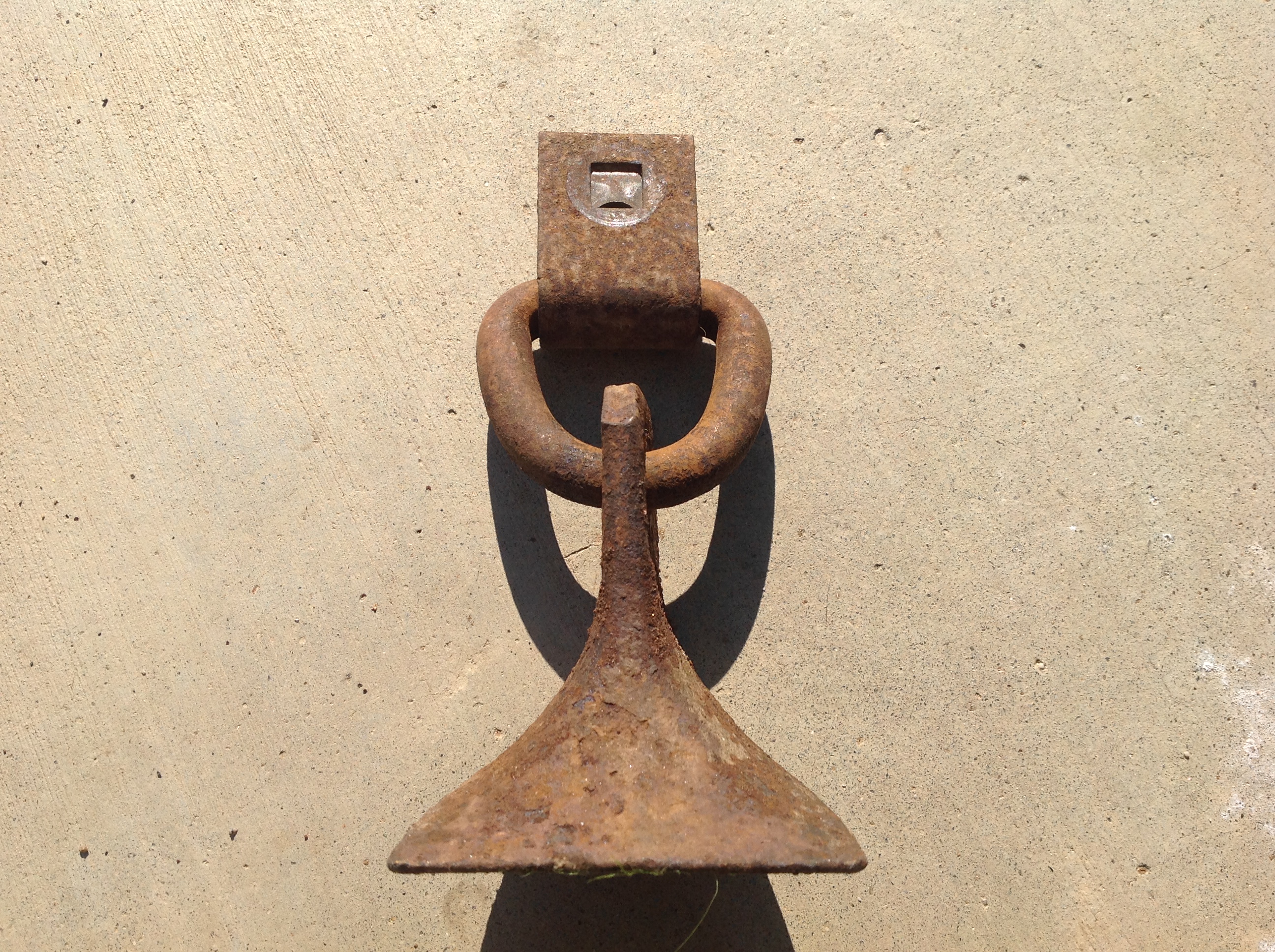

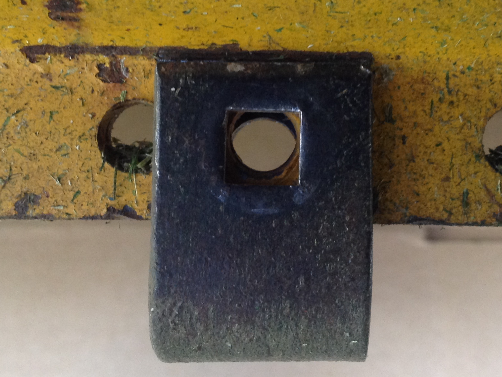

I just reversed 33 blades and she works, there is some vibration I'm concerned about.
View attachment 500708View attachment 500709
You will have vibration at low rotor speeds until you reach the orbit speed of 2,200 RPM+-;
if you have vibration at the 540 RPM PTO engine speed read the following please.
The rotor will have been balanced on a high speed balancer and weights would have been welded on it and then balanced once more with the knife sets on it. you may be missing weights OR you may have a bad bearing or two bad bearings on the flail mower rotor(if you have find you have one bad bearing its best for your sanity to change them both.

If the rotor was missing one of the welded weights or was off balance, can you have the rotor balanced by someone, or do you have to buy a new rotor.
   / Let's talk flail mowers #4,215
See if you can find a spot where it looks like a weight has come off. If so I think you could measure the size of what came off and replace it, especially if someone with a similar model can measure the thickness of the weight on theirs..
   / Let's talk flail mowers #4,216
One problem is that they used different thickness hangers that are going to be different weights, I see two welded weights on the left and only a small one on the right but no indication of one missing. I really don't understand why the hanger bracket bolt holes don't line up and you have to pound the bolt through the hole to make it fit, about 20 of the hanger brackets lined up perfect and the remainder did not. The two threaded holes in the second to last photo is where the adjustable weights go. The only problem with working on old machinery like this is that you could spend the money buying new cutters and hardware and then find out that the rotor is not balanced or bent.

Re: Del Morino arrived
I knew it was for shipping efficiency. It sure did look odd.
Gear box checked and did a trial spin. All good.Now I need summer!
