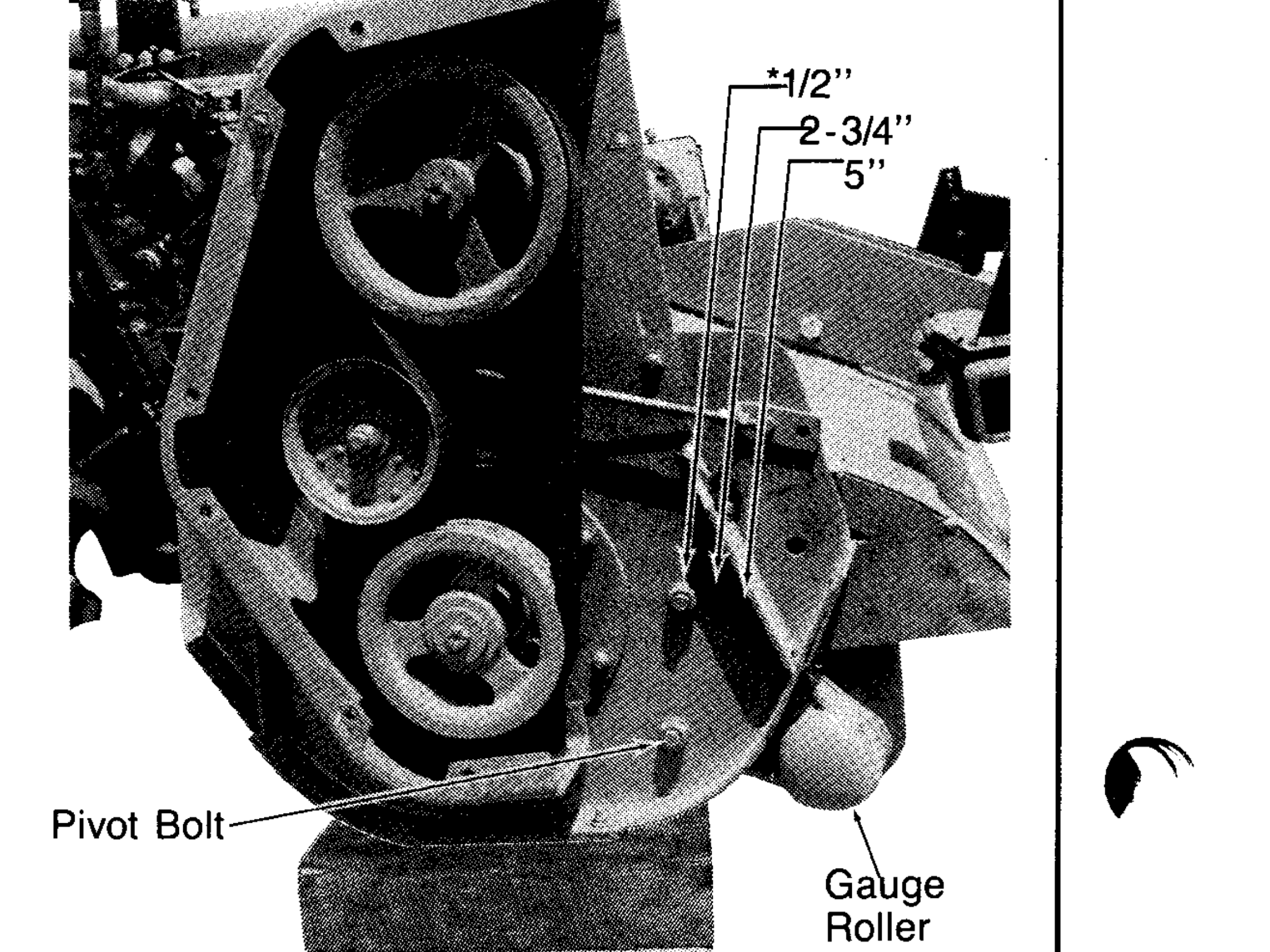

I don't see that it would make much difference which of those brackets and blade combinations you used so long as all were the same. The skids can be adjusted up or down to make sure that the blades are not resting on the ground and that is just to prevent rust. I'd set cut height with the 3PT not with the skids. Skids really shouldn't touch ground when mowing or any other time that the rotor is turning.
   / Let's talk flail mowers #4,252
There are three adjustments to the roller 1/2" , 2-3/4" and 5" and the skids are fixed, I do have the roller set to the highest position and I adjusted my three point to have the roller sitting on the ground and adjusted my top link so that the drive shaft was close to parallel with the PTO and that keeps the skids off the ground about one or two inches and the cut was one or two inches above the ground. Im guessing, correct me if I'm wrong, a bigger tractor would have the PTO higher off the ground and would allow you to raise the front of the flail mower more and give you more height adjustment. I was just following the manual when they said to keep the drive shaft as parallel to your PTO as possible, so if I go with the longer link, I don't see how you could get an adjustment for a 5" cut if the blade is now 3/4" bellow the skid. So the height of your tractor or PTO must have some bearing on the adjustment you can achieve.

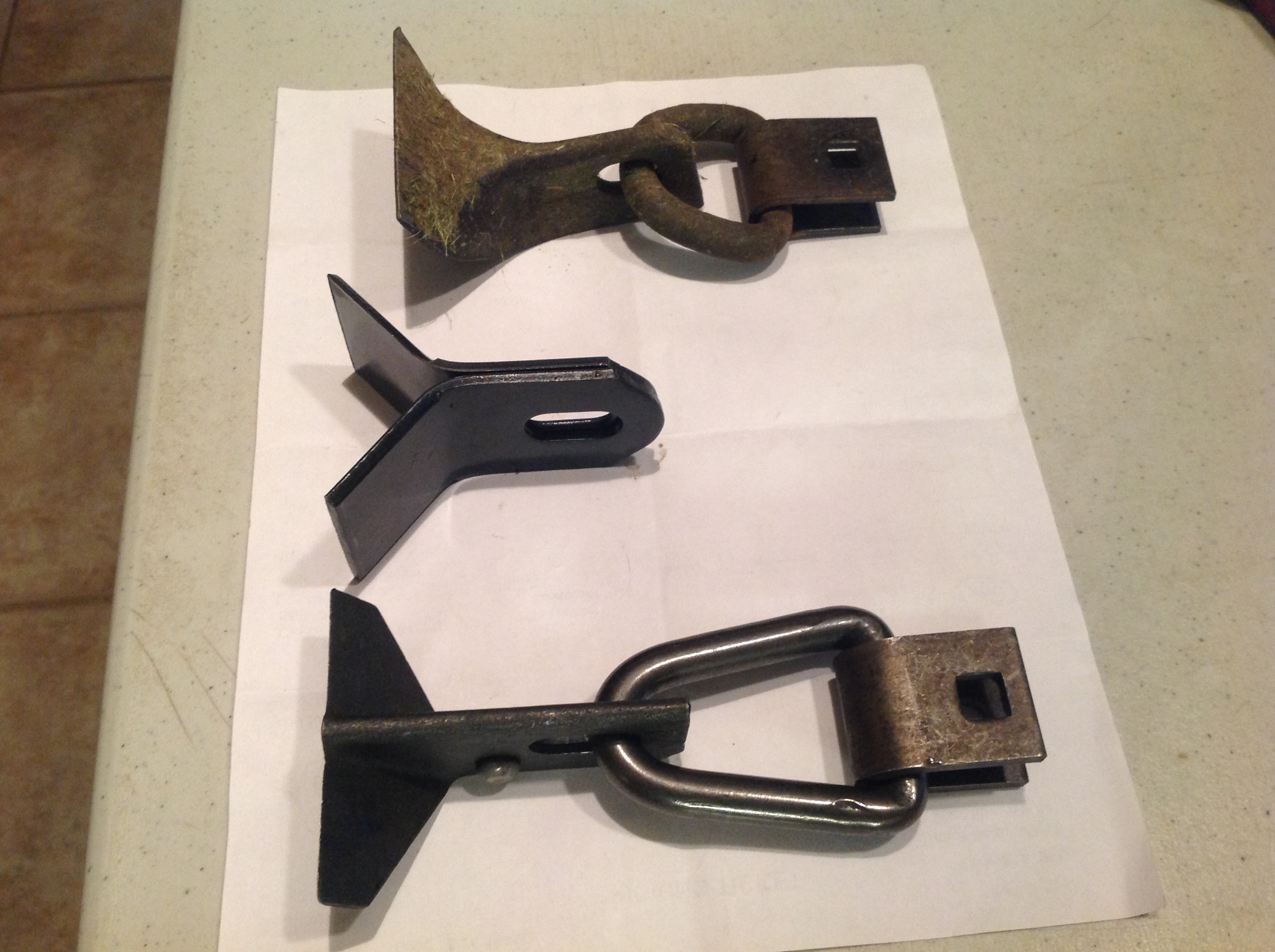

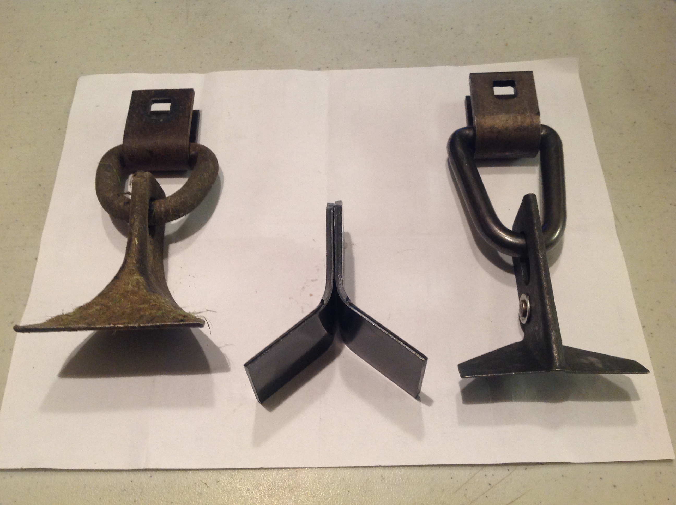

I just received samples form Flail-master for my Bush Hog FM188, and all the existing parts are wrong.

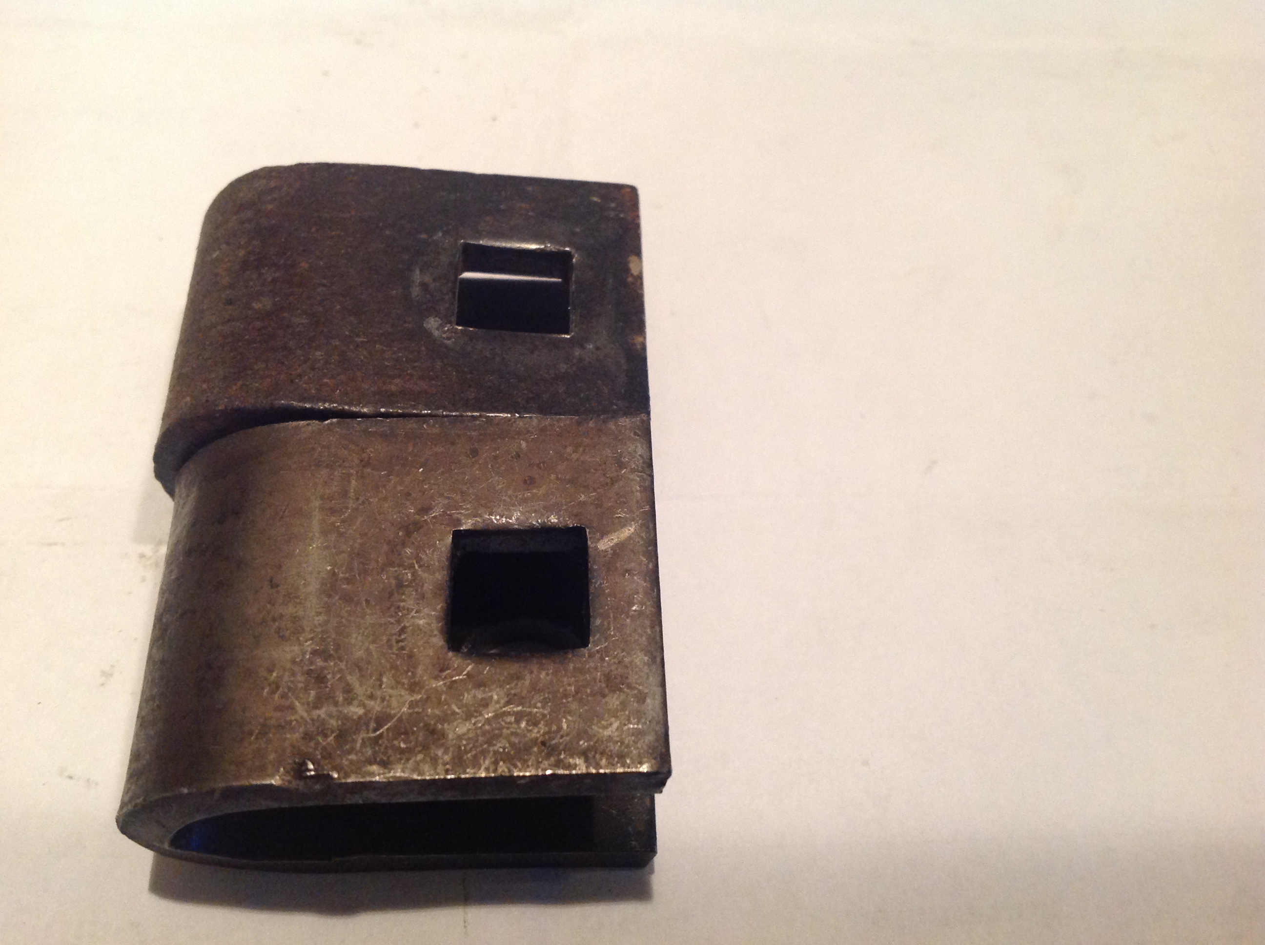

The bottom hanger bracket is the correct bracket and has the hole closer to the top and corrects the misaligning issue I had with having to pound the bolt through the holes.
The two blades on the right are the correct ones for my flail, the incorrect blade on the left with the short link when mounted is even with the skids and the correct longer link has the blade extending past the skid, does your knives extend past your skids.

Which blades do you prefer for field mowing, standard cut blade on right or coarse cut blade in the middle.
I have the side slicers in the center. They do a fine job pasture & field mowing. They do an ok job in moderate brush & finger sized woody stuff. The rotor bearings did blow after some moderate brush, but I think that was mostly age related, although I'm sure the brush didn't help.
My next flail will be the duck foot hammers, but I'm expecting it to tackle moderate brush. My rotary cutter ran off with my old tractor, so I'm just left with the old beatup 917 & side slicers for now. Need to get a new flail that can tackle some brush, maybe a heavier beater rotary.

As far as "duck foot hammers", are there two kinds of duck foot blades? My Dandl has duck foot blades but I wouldn't call them hammers, might be 1/8" material thickness. Just wondering....

Old 917 is still here, it would have cost the buyer a lot more than my 5' rotary cutter "Brush hog" despite the rotary being 3 years old vs the 30ish on the flail. New tractor is 72" wide so a 60" mower wouldn't have fit well. Not to mention flails kick ***.
There are some cast duck foot style out there. Not sure who sells heavier cast ones vs. folded bar stock ones. When you start getting into forestry flails they really turn into hammers.

I misunderstood. I thought you let a flail go with the other tractor. Thanks for the info on the blades. I thought I might have missed something else. I was thinking about Y blades for my flail as the duckfoot blades seem to grab larger than finger size stuff and try to throw it forward. Now I am not so sure if I should. I may wait until the grass starts growing and give them a chance on the green stuff.I do like the way they cut smaller than 3/4" material...
I use my 3PT and topping lift to adjust cutting height. 90% of the time the rear roller is holding much of the weight but occasionally even that comes off the ground in very lush grass or brush. I never ever have the skids on the ground while mowing. So long as you can lower the 3PT to ground with the blades spinning and not dig dirt I wouldn't worry about skid position. Only reason to have even that consideration is that you will certainly forget someday to shut off the PTO before dropping the mower to the ground.
