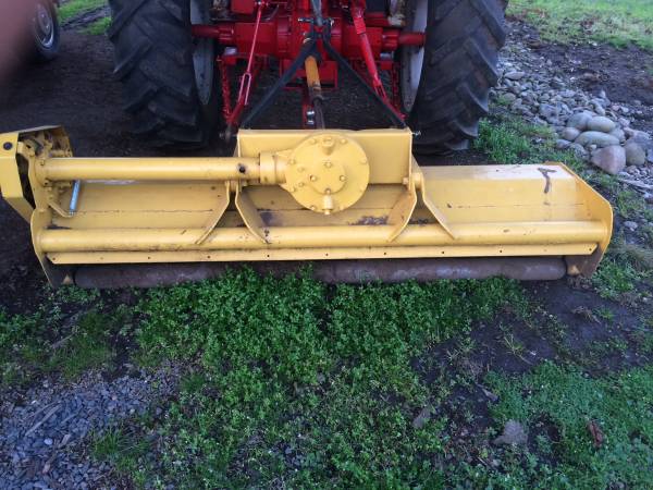

Can someone identify the make/model of this flail that showed up on the local craigslist?
   / Let's talk flail mowers #4,293
Thanks. Given a make to search on, it does indeed look like a Mott of some kind. The owner says it's a 6 footer and "has new knives". Wants $1200. He's not even that far away as things go hereabouts - about an hour.
Edit note: Never mind - he sold it earlier today. So it goes.
