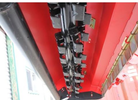

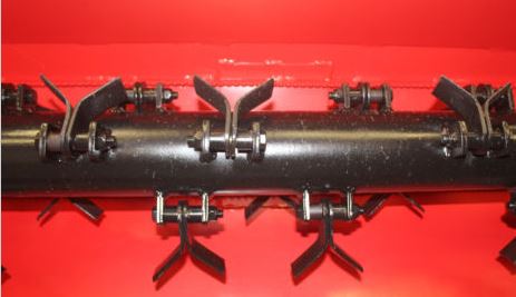

After a month of reading every time I get a chance, I have made it through this thread. Great information for those willing to make it to the end. I need some advice. I have just purchased a Kubota L6060 that hasn't been delivered from the dealer yet. It should be here in the next week. I have about 15 acres of vineyard/blueberry pick your own/pasture to cut with random rocks from the size of softballs to the size of tires, which can be avoided by lifting when needed for the most part. This gets mowed every other week or so depending on weather. This land is in east TN and is fairly hilly with a 15 degree slope on some of it. I have never had an issue or felt tippy with a small Massey or John Deere and the tractor is coming with tires filled and a FEL which I can leave on or remove depending on how it feels with the new tractor. I am wanting a hydraulic offset flail to be able to get closer under the grape vines and blueberry bushes. I called agrisupply about the caroni, but they are estimating mid july now. I can't wait that long as the grass will get out of hand and the 5' rotary cutter just can't get where I need to. I am looking at Betstco Farmer Helper version now as it is in stock. Looking at a few models.

I believe the L6060 won't have any issue with these so is there any reason not to get the largest cut? I am not sure what the difference in the EFGCNH195 and EFGCH195 are. It says one of them is an inch wider than the other, but I doubt that. Which type of blade would work best for rough cutting fields with occassional small saplings? Not really worried about lawn finish cut as it is a farm. I read alot of people mentioning hammer blades doing a great job on the rough stuff and still looking decent on the lawn. Which of these are hammer blades? Thanks for any advice and I can't wait to join the Flail Mower Nation.
There are some experts on here but this is what I have learned. By the way, I have the L6060 grand and a Del Morino mower.
1. In your picture, the lower picture is knives.
2. Have you considered a flipper version? I'm very happy with the extended offset and ability to mow all side gradients.
3. If you go flipper, Make sure you order the right hydraulic valves and I would suggest at least one float for so that the flail floats with the terrain at the pivot point
4. The best advice I can give? Get Leonz and Island tractor (and others on this thread) involved
Good luck. You will love the tractor!
The L6060 will easily run a 7ft flail so power is not an issue. Get the biggest one.
Yup! Get rid of the large rocks first. Any rock that sticks up more than an inch or two out of the ground should be removed. I had to remove a couple dozen 100-300# boulders from my pastures before I could get them under control and some still work their way to the surface each year.
Hammers work great on pastures and fields. As long as you don't want a finished golf course look, hammers will do a good job. Get the best one for your situation as your L6060 should handle any of your choices. However, I suggest you get one that is at least as wide as your outside rear tires width, i.e. - greater than 72" (180cm). That way when you shift it out it moves out past your tire.
