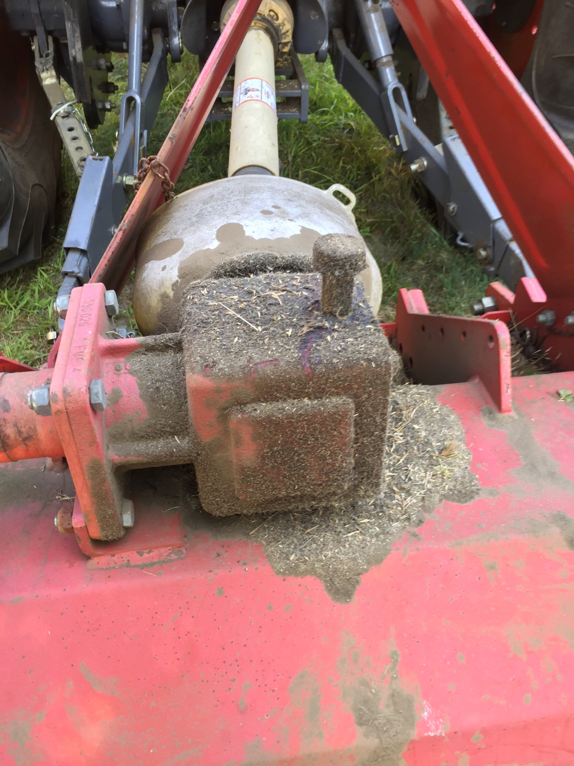

I've never bothered changing the gearbox oil. As most Caroni owners notice, the vent cap dribbles out oil during routine cutting so I figure I replace the oil slowly through just keeping the level up. (And if you get sick of the dribbling you can add a metric spacer which CUTs the dribbling down but doesn't stop it. I think I've posted the part number from British Metrics in Maryland in this thread a few times)
