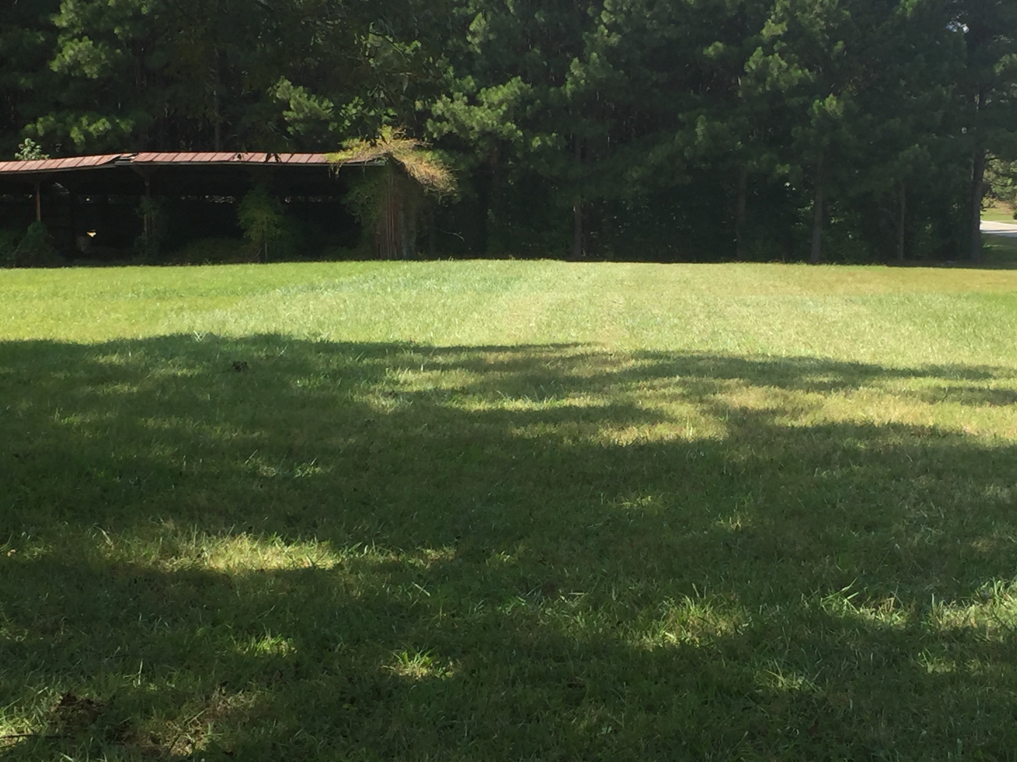

As I mentioned earlier, the dry clean lawn fescue type grass is less than knee high, 8"-10". PTO speed at 540 or a hair less. Mowing speed 3-4 mph. ( My fuel usage has almost doubled compared to the brush hog or finish mower)
This is what I'm mowing

I can tell you from my personal experience that you need to slow down your travel speed with that height of grass. That is why you lost your first set of belts. The scoop knives should help a lot if you intend to mow only occasionally.
Your pulleys are fine and the flat snubber pulley is in proper tension with the supplied OEM spring as the V belts should not move more than an 1/8-3/16 of an inch with the push of a finger as the snubber is designed to react to loading on the rotor.
