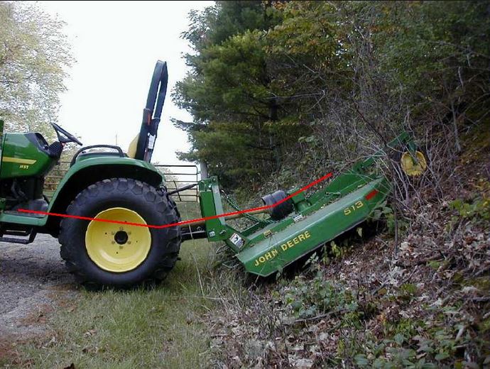

Sometimes, when the tractor is going through a depression and the back wheels are going into the depression, the mower rear wheel or roller induces a twisting force because of it's leverage advantage . The 3pl gets bound up and the result, if you dont have chains on the headstock, or a slotted top link hole, is bent components .
That is why chains are usually fitted to the headstock of most Bush Hog's etc. so the mower can pivot on the lower hinge of the headstock . If the mower is fitted with solid steel straps, instead of chains, the top link on the Tractor must be flexible enough to absorb the change in angle .
It is hard to explain in text . I will add a photo from TBN to try and visualize it . This Bush Hog is fitted with chains on the headstock and you can imagine what would happen if it didn't have them . chains.JPG

The length on a rotary cutter make it much more likely & problematic than on a flail. It can still happen on a flail.

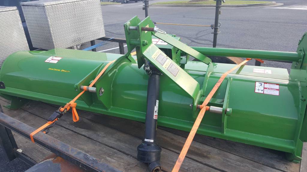

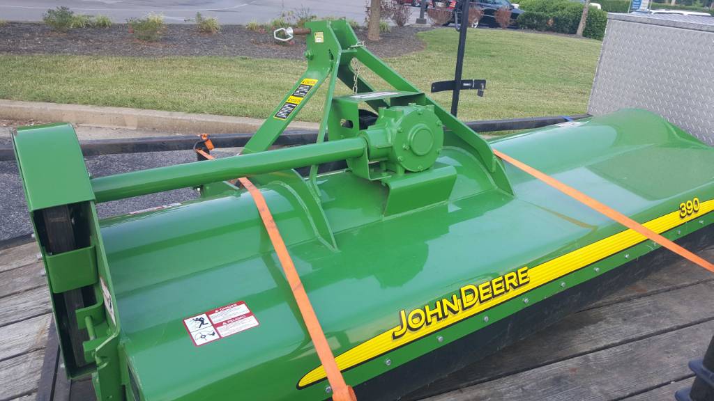

Just picked up muy second flail mower in 3 weeks. This one is for our 55hp 4wd AGCO ALLIS for the bulk of the hill fields. JD 390 8' wide. 2016 model with about 10 hrs on it. Still shiny and has all the stickers. This one also does not have lube fittings on the rotor. 1529191270386.jpeg1529191301573.jpeg

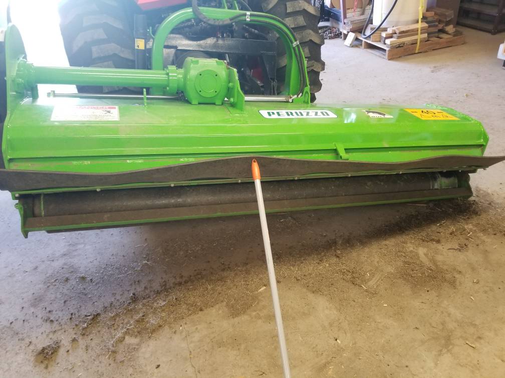

Anybody have any opinions on the value of a scraper on the roller? The one on my new Peruzzo has been a bit problematic.
At the start material was getting wedged between the angle iron scraper & the roller. The photo I took was after digging plant matter out from under the scraper. Then a few days later i found the scraper an inch or so from the roller instead of almost touching. Thought an adjustment something had loosened, but as I started looking, some stops on either end of the scraper had cracked. Recently I'm getting a ton of material packing pretty hard in on top of the roller under the rubber flap. I'm assuming the scraper is stopping material from flowing over the roller. Need to get a photo of that, but it was late & dark out tonight.
My old Ford 917 flail never had a scraper, at least as long as I owned it. The only issues I ever had was was when it was really muddy & I had no business mowing (think I was testing something).
Any reason I shouldn't just remove the scraper?

The scraper on my Caroni rode on top of the roller. It beat and banged with every bump it crossed making a racket which was driving me insane. I took it off and have had no problems at all although cow manure does stick to the roller but quickly wears off.

We never had scrapers on out mathews mowers and any build up fell off. The scraper is there primarily to clear fine clippings which can be as bad as super glue, no worries just set it aside and when you dedicate it to only fine sod mowing you will have it to use.
