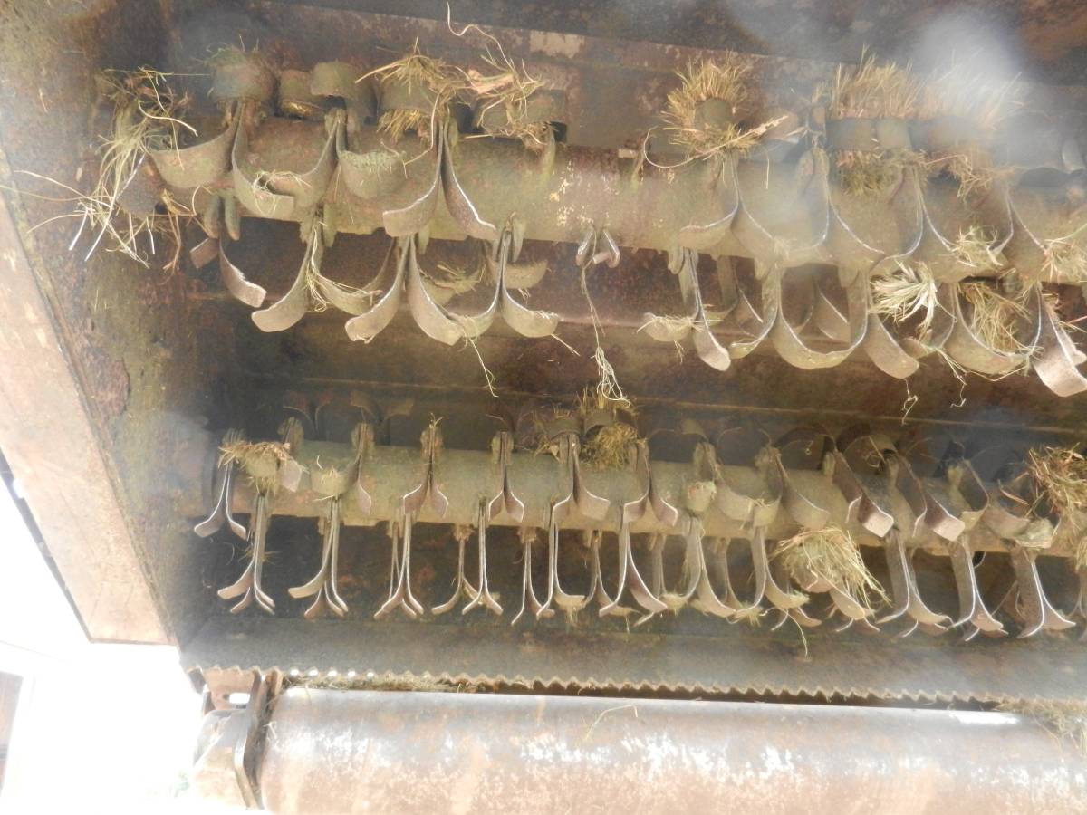

No kidding! not only is it two rotors, but it's fine cut on top of it. That's 4x the knives of a regular rough cut mower.
I'd like to sell those mowers, in fact I'd give them away as long as the customer promised to buy the knives from me. Sort of like an inkjet printer....the purchase price is the cheap part. :rolleyes:

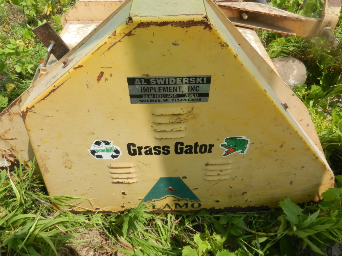

Just discovered that Alamo made a dual rotor flail mower called "Grass Gator". It must not have been very popular because it is no longer produced.

Man, that would cost a fortune to swap out the knives!
It did not help matters that the previous owner used it as a brush mower and ruined the the thing grass side slicer knives.
You could install the 4 inch heavy heat treated side slicers and have a good flail mower for both good sod and brush mowing.
