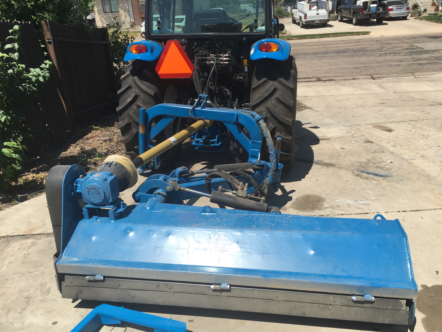

I have an older Berti TA 200. Very well built heavy duty machine. Mine was abused by the county road crew that didn’t know how to use it, but with a little work it works like new. The roller and rotor bearing are still in great shape and I think the hammers were replaced not long ago with Berti OEM replacements.
It eats brush right down to the ground and will chew up cinderblocks and 1/2 rebar. Yes, I accidentally found both hiding in some brush. It will wrap up a lot of barbed wire really fast as well. No damage from any of these with the exception of a couple small chips in the edge of one of the hammers after it picked up the two 3’ pieces of rebar. The rebar was pretty mangled, but fell out when I lifted the mower.
A Berti is a lifetime mower unless you are mindless county employee that likes to destroy stuff.
I cleaned it up and painted it to match my tractor.
