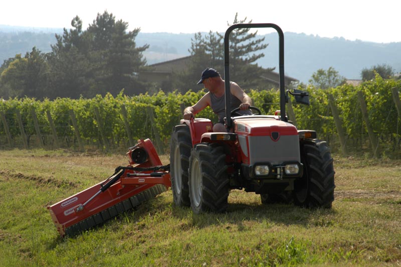

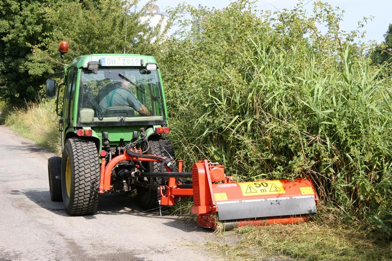

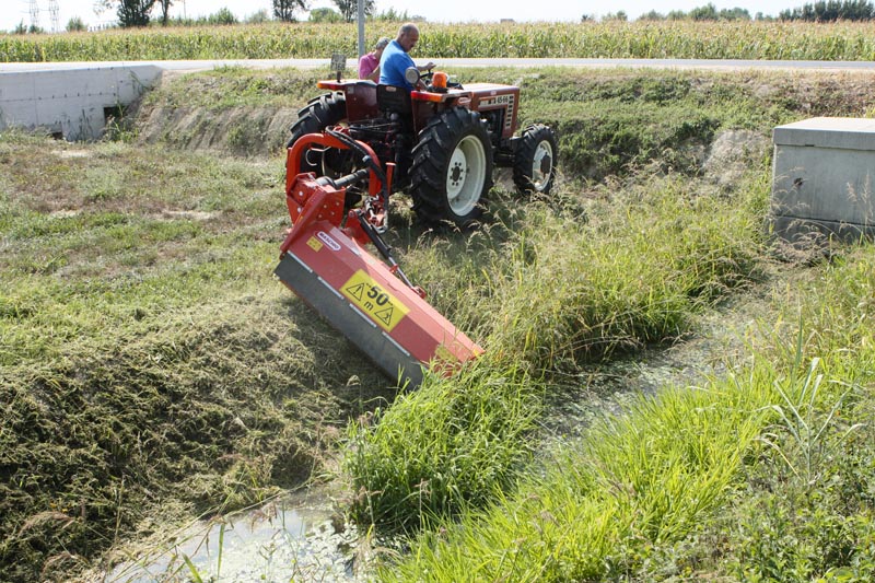

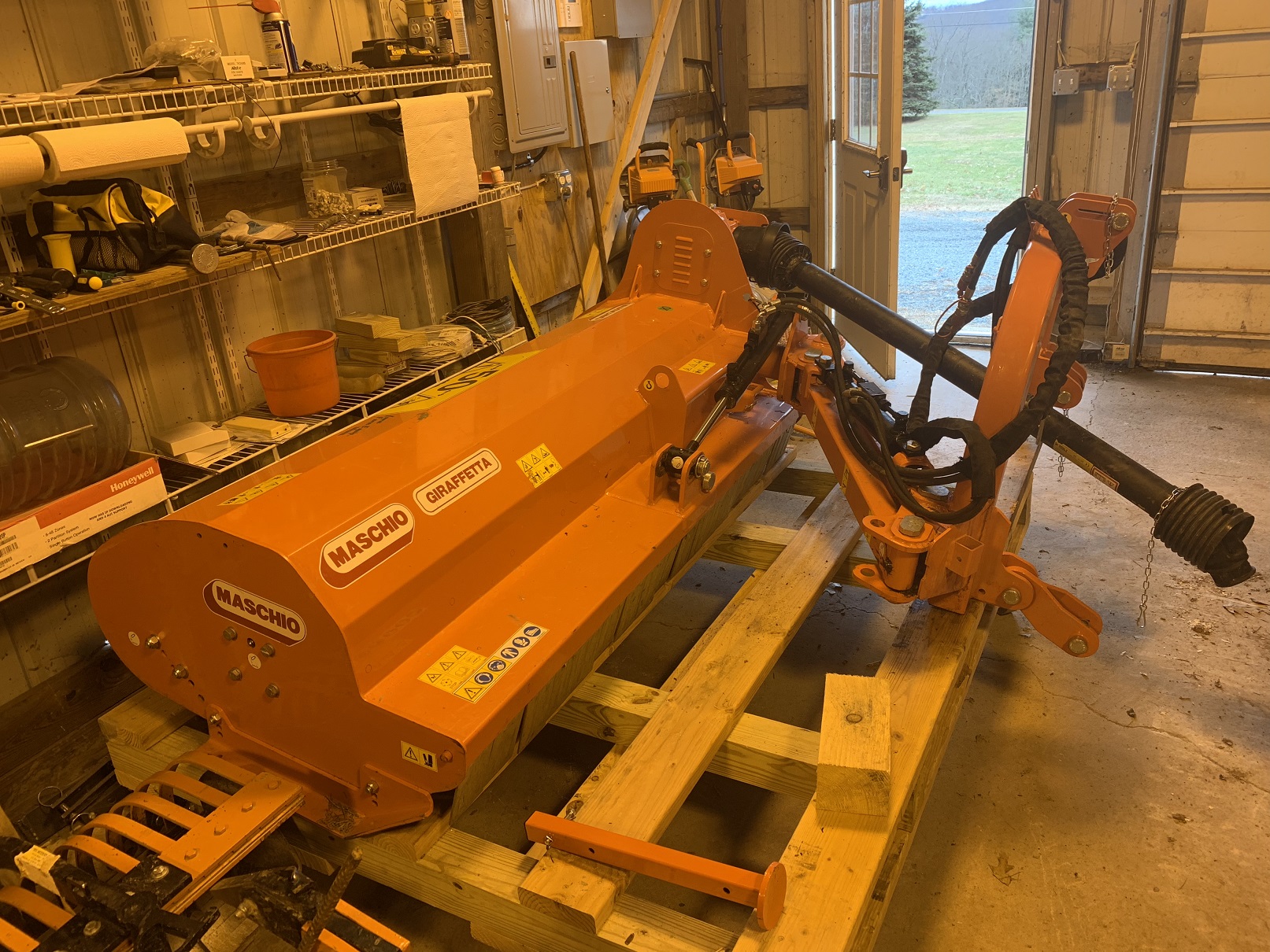

I bought their little "cousin" last spring for mowing shoulders & ditches along a mile of private road. I also mow perpendicular to the ground line for branches & brush encroaching on the roadway. The hammer flails make short work of anything up to a 3" diameter.
IMG_0398a.jpg IMG_0399a.jpg maschio-giraffetta-mower-2.jpg maschio-giraffetta-mower-3.jpg maschio-giraffetta-mower-4.jpg
Maschio makes a good product and so far, I'm happy with the implement.

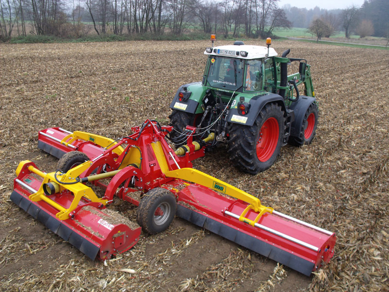

Hello and good morning Dave,
The wider folding flail crop shredders and mowers use high horsepower one to one gear boxes and propeller shafts that have to be at ground level to be used or in the case of the INO or Wessex mowers or other brands there can be a mower mounted up front and there are one or 2 mowers mounted on the rear to permit full shredding width.
With a towed three gang crop shredder the center mower is used to carry the folding mowers.
My old lap top is broken and I have all my flail mower information on it :^( so its harder to describe with out pictures but the INO flail shredders are well described on youtube shredding corn and sunflower crops that were allowed to maturity and later shredded.
I have uploaded many pictures and videos of them working or posted links in the past.
