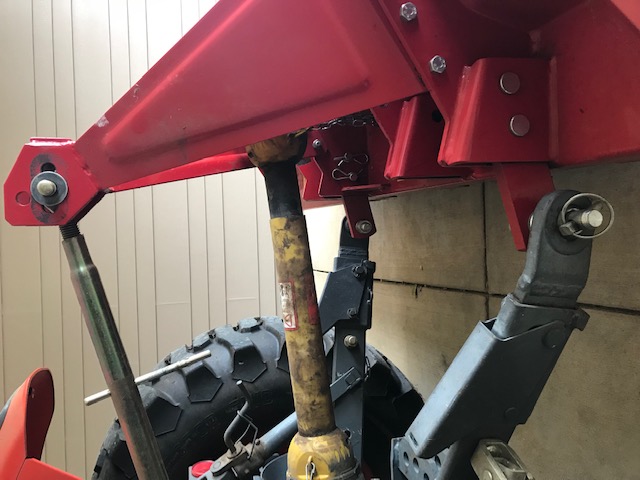

I will try to adjust it as you suggested when I receive my new skids. As it is set now, when the mower is resting on flat ground the roller is 1/2 inch higher.
Now I am not sure what you mean by adjusting the height of the mower with the top link. My understanding of the top link function is for adjusting the longitudinal level of your implement, in this case the flail mower.
On my rig I adjusted the top link, so the pin is located in the center of the slot of the mower hitch frame, when the mower is resting on a flat ground (see picture).
The only way I know for adjusting ground clearance of an implement is with the hydraulic 3-point hitch. The position control lever lowest limit can be set with a lock bolt on the quadrant. I wish my tractor was equipped with a draft control, but it is not.
Ok, now I understand. My Dandl does not have a slot. I lower my lift arms all the way down so they float. The top link holds the top of the mower back, and the lift arms hold the bottom forward. The mower rides on the rear roller and follows the terrain in the exact relationship at all times. By extending the top link, the mower pivots up, raising the rotor higher. When I go through a divot, the arms just raise up in float. My lift arms have slots to allow the mower to follow the ground when one end needs to be higher than the other.
I know none of this helps you. I would like someone else with a caroni to chime in to see what they do. How do you maintain the same cut height with the slot? Seems like the mower would change the angle of attack over every bump. Reach out to Island tractor as he seems to have been using a 1900 caroni for years.
