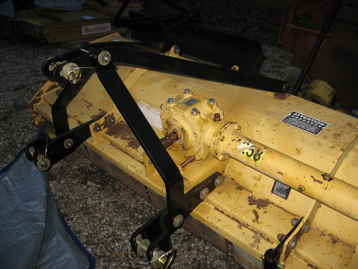

No it is a 918H, the gear box is way different than the 917 uses as you can see in the pic. I have decided that I am expecting more from this mower than it can deliver and am throwing in the towel. After all the sharpening, adjusting, resharpening and re adjusting, plus now I am finding parts availability is limited, should have done more research. I'll hold on to it until I find something else since it being an offset does OK on the county road that I keep the shoulders cut on since the county can seldom be bothered to cut them.
I am not expecting it to cut like the finish mower a bit rougher cut is fine since it is a large area that is kept cut for the appearance of the property. But the mohawks of uncut grass standing up are just not acceptable although reversing the rotor rotation did improve it somewhat. The old King Kutter bush hog with sharp blades will do a better job than the flail has so far.
I really appreciate all the help and comments, thank you all. I just got burned on this one, my mistake thinking New Holland would be a top quality product, I do have to say at least it is solid and well built. I will have to do more and better research before getting another, if I do. There are many things about flails I like, just not the quality of cut. At least not the cut from this one.
