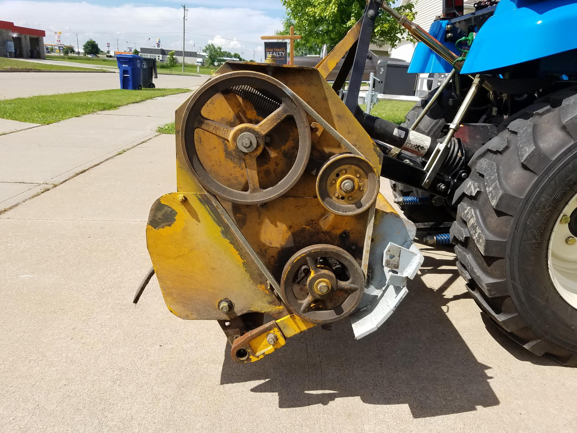

D2Cat the pulley's all turn clockwise if you look at them like this unnamed7.jpg the flails go the same direction as the tractor rolling forward. should it be going the the way?

Your flail mower is set up to discharge forward as you mow. I know this because your flail mower
has a second stub shaft to allow it to be used with clockwise rotation of the flail mower rotor as
you face the left side of the flail mower. You can mow in reverse and improve the mowing finish
if you wish to do that.

Highway mowers sometimes mow with the tire rotation. It helps them bounce over trash. Most other flails & all consumer ones rotate opposite the tire rotation. Whenever I mow backward neither of my flails cuts worth beans. Not sure if that's because of the flail rotation or simply the roller pushing grass down though.

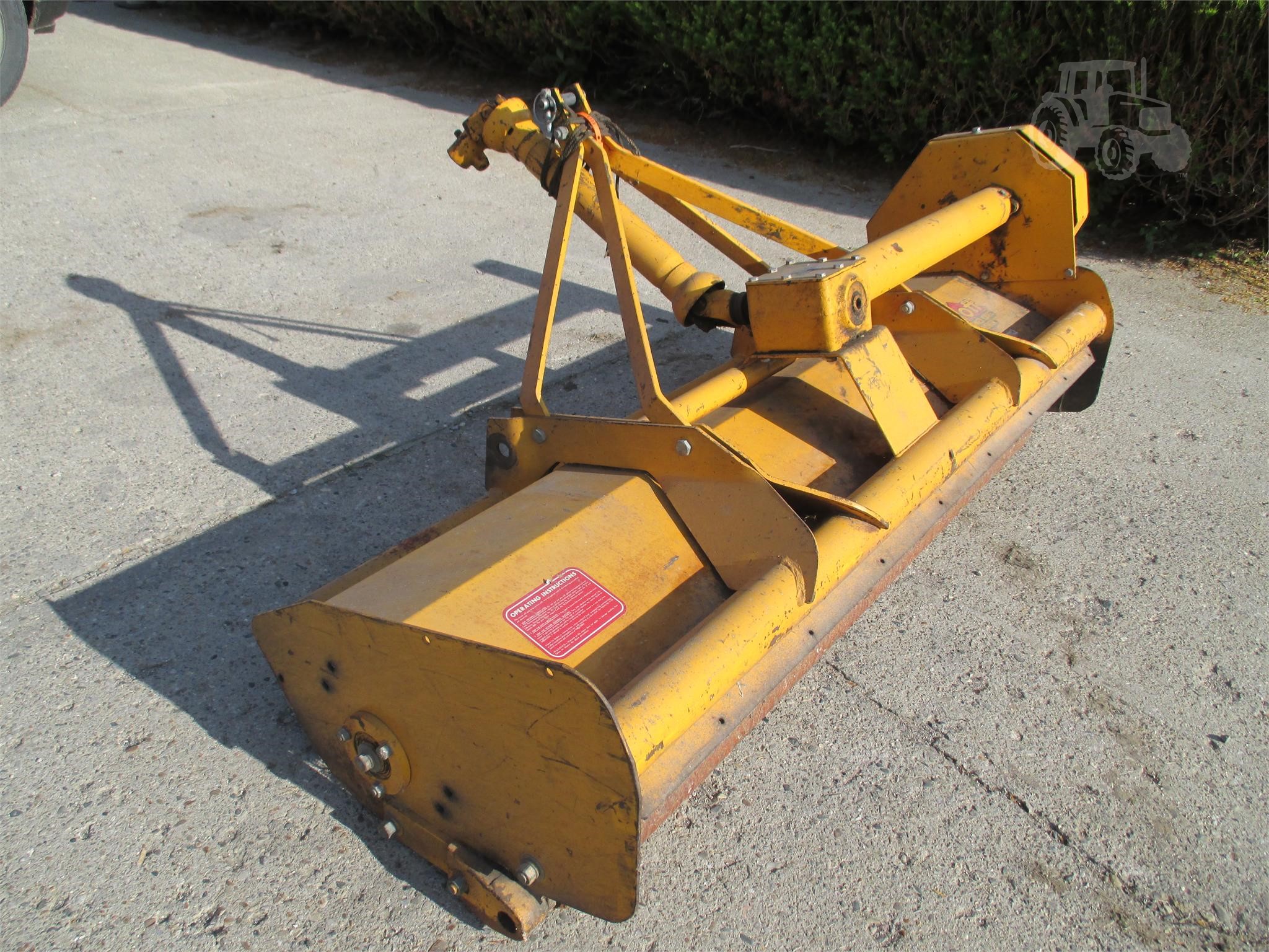

It looks like you have the 1000 PTO gearbox on that unit. I looked at 2 other J60's listed on tractor house, 1 with 1000 PTO, 1 with 540 PTO and yours looks like the 1000 PTO unit.
1000 PTO: https://www.tractorhouse.com/listings/farm-equipment/for-sale/31749375/mott-j60
540 PTO: https://www.tractorhouse.com/listings/farm-equipment/for-sale/28565787/mott-j60

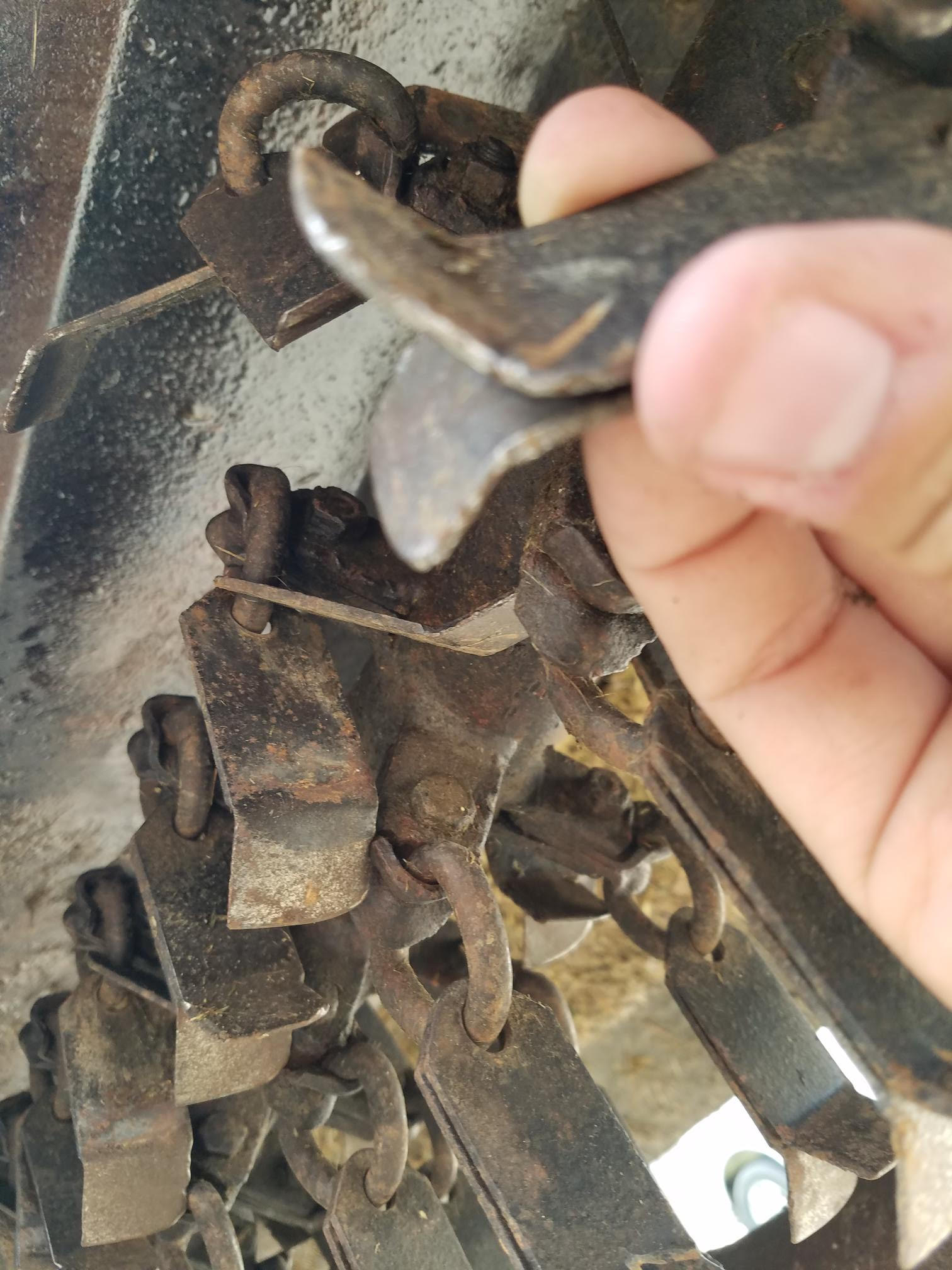

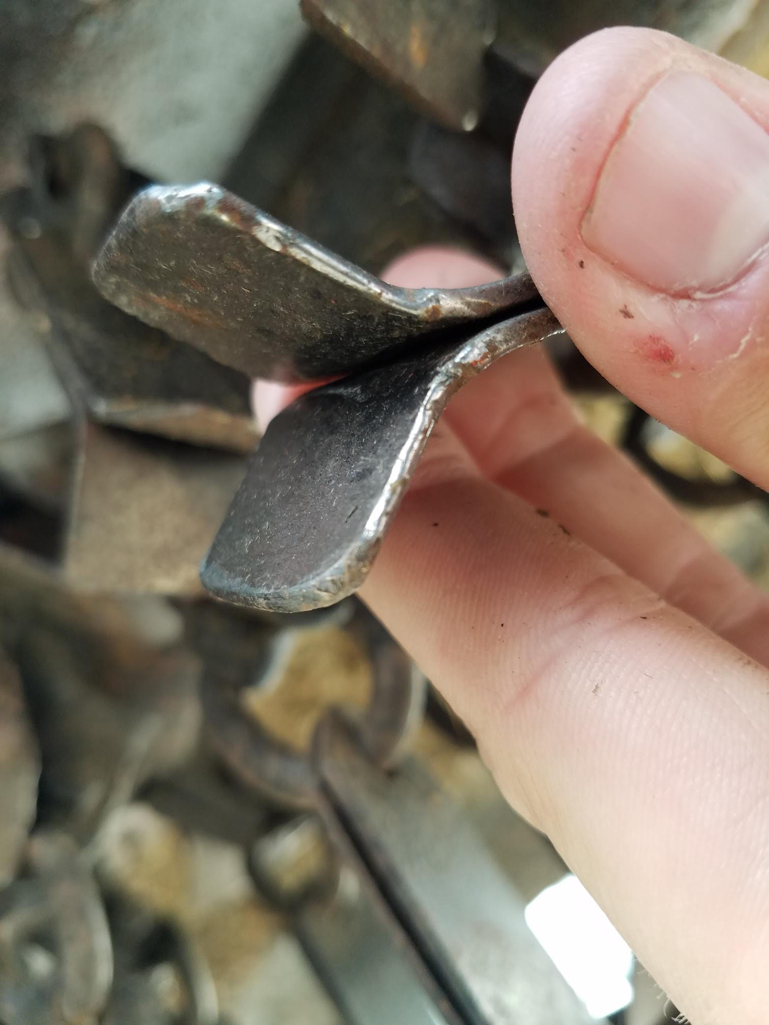

Thank you for the welcome, a little more info on why i'm concerned about it being a 1000 PTO speed unit, when i picked the unit up the owner had a IH284 which to my knowledge has both a 540 and a 1000 pto setting. me being stupid didn't think to ask about the pto speed the unit was used on, and now the owner has passed so my window has closed on that bit of info.

NOW as to the side slicer knives you have, they are the thin grass knives for your mower.
Plan on having the swear jar close by and at least one hundred bolts and nuts and a big
bottle of blue Loctite.
I would rather see you take half cuts for now and do your mowing that way as you should plan on purchasing
heavier hardened knives for your beautiful flail mower.

You have to be very, very, very, careful when dry grinding them or if you have access to a table belt sander with a
fine grit paper that will work in a pinch. I much prefer using a low speed wet well grinder and set the angle on the
tool rest at 37 degrees and cool grind away.

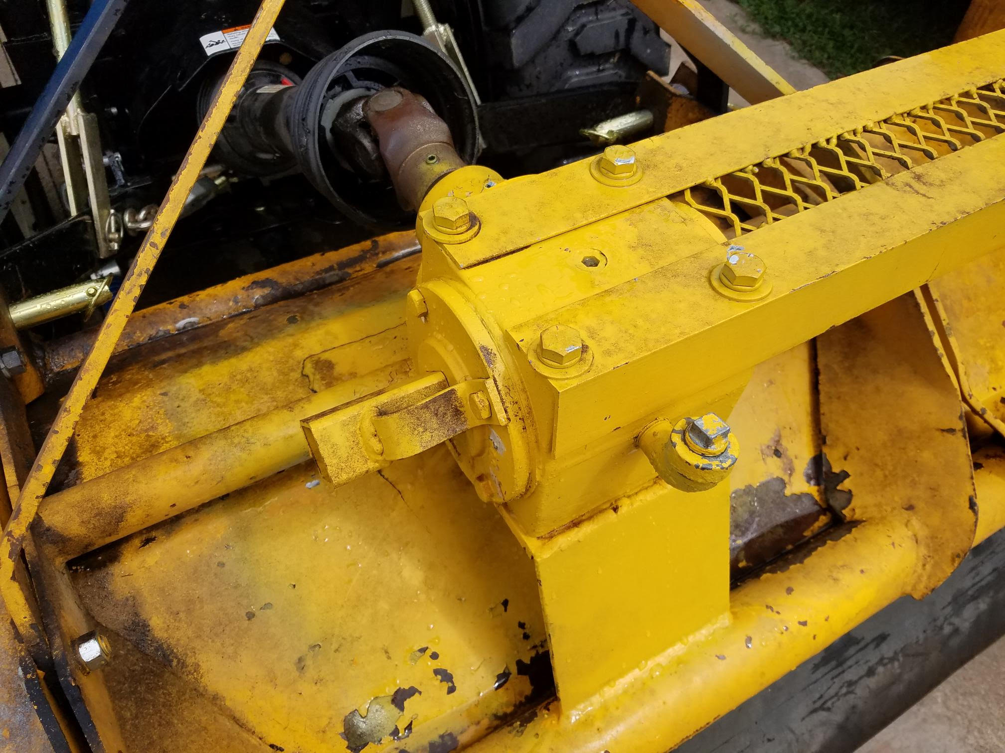

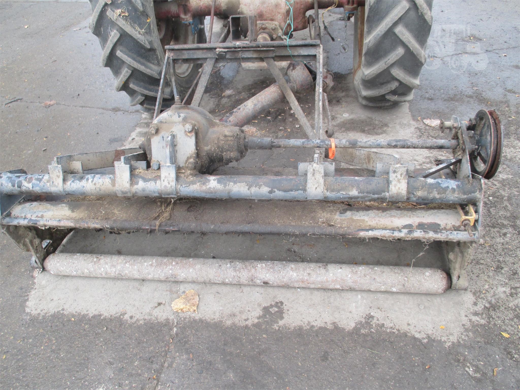

I'm fairly confident that his mower has the 1000 PTO gearbox on it
His mower: unnamed1.jpg small square gearbox.
1000 PTO: unnamed2.jpg small square gearbox.
540 PTO: unnamed3.jpg large round gearbox.
The size of the gearbox tells me that there isn't enough room for the large ring required to get a 4:1 ratio, only enough room for a 2:1 ratio.
LandofCheese, go to flailmaster and get new blades if you are keeping the mower (if it's truely a 1000 PTO I'd pass it on...). It will take just as much time and you will have fresh blades. Your blades would be on page "2" of their catalog. I believe you need MH-293 blades. Wouldn't hurt to get new nuts and bolts and maybe even clips and rings, depending on their condition. You will need to call your order in as they don't have their online store up and running yet.
