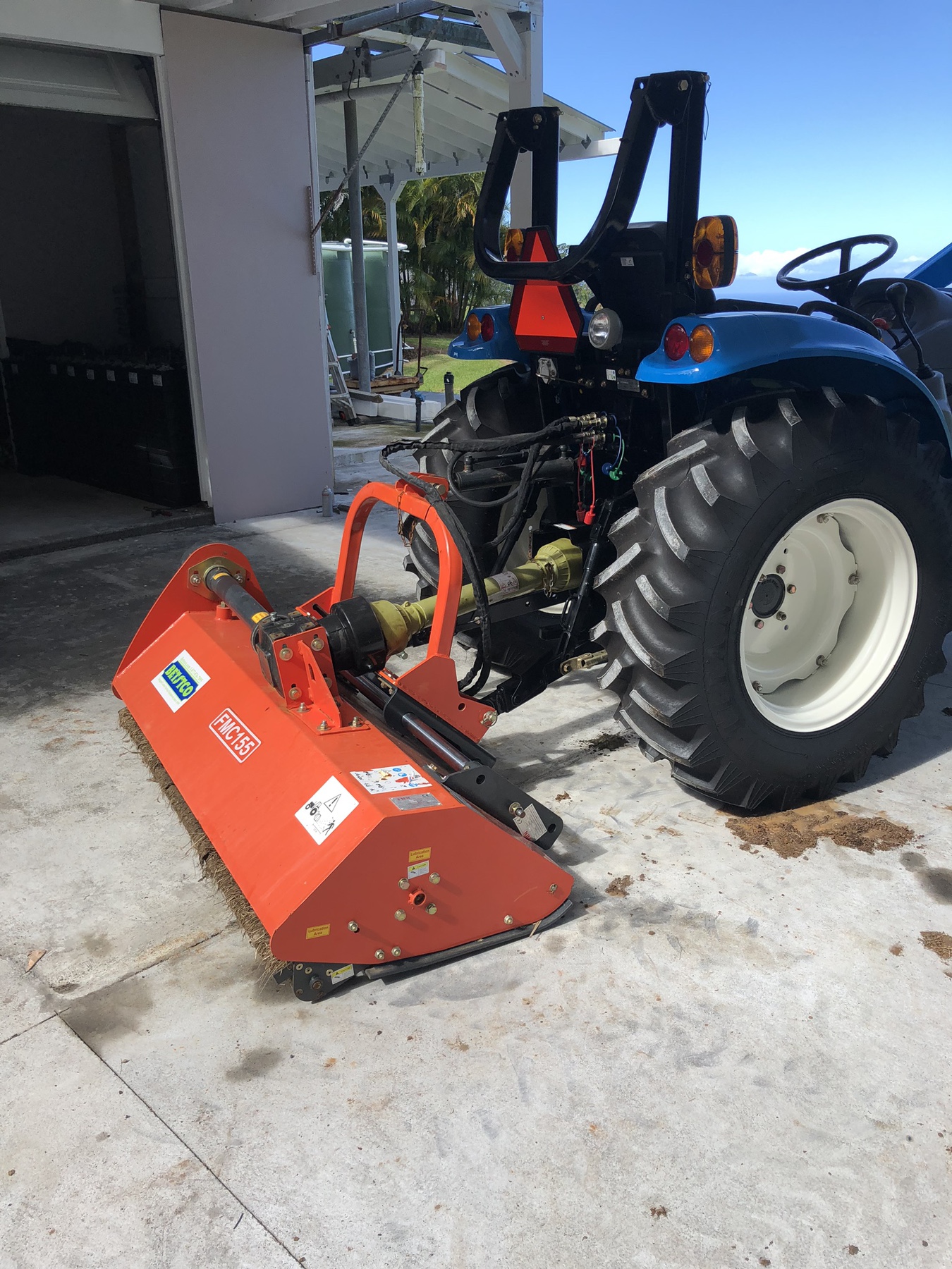

Got the hydraulic side shift kit installed on my FM155
Offset is enough to mow up to fence without catching tractor or tires, but not enough to effect balance noticeably.
