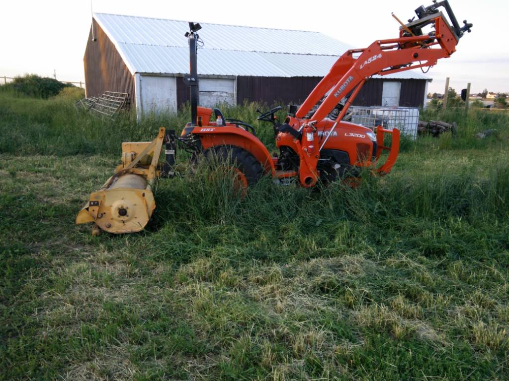

I ran a 7' old Ford 719 flail behind my former L3200. With a HST it was fine, but I had to slow down a lot on thick stuff. If you are running on a geared machine you may have to take partial passes or even half clutch to let the flail catch up.
I generally advocate going wide & slow. But that's with HST as you can constantly adjust on the fly to push things to the limit. A gear machine isnt nearly as dynamic & will be a lot more work to maintain progress & avoid lugging or stalling.

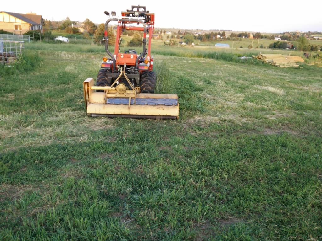

View attachment 616897View attachment 616898
The difference between the HST and Gear is interesting. I need to give that some though. I wanted a HST but got a good deal on this gear.
