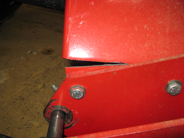

View attachment 664451View attachment 664452
Here's how I welded my Titan uprights to the top link.

Well, my replacement Chicomm flail top link brackets just failed so, I'm going to follow your advice and weld these. I may have my welder make some support straps so if the welds break, the support straps will keep the mower attached to the 3 point. May attach the supports to the gearbox. There are several unused threaded holes in the gearcase. We'll see.
My welds are ugly and I took no pains to clean them up and paint, but they are holding up fine even with rough use. This is just a poor design. The uprights themselves are heavy and the metal is fairly thick, but its a poor design to try to support over 600lbs. The steel may be inferior as Chinese steel tends to have a lot of impurities, who knows. I used a plate and bent it to match; then pierced the holes with a torch...then welded top and bottom, and the key is to weld up the sides. Makes it much stronger. Also welded the tear in the seam.
