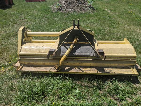

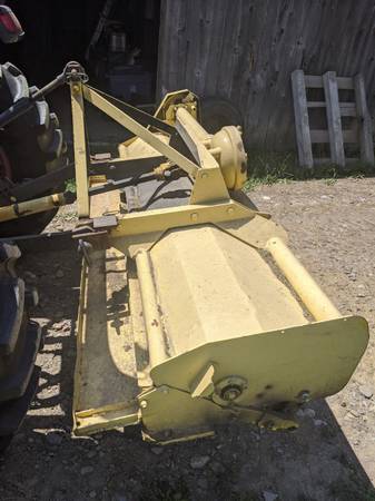

Good morning all - I wrote in shortly after purchasing our new property with some questions on flails. Just to catch up - I have an old beat up 5' brush hog, but want a flail to keep about 6 acres of field/meadow cut down once a month or so. I have a Deere 3033R and a 72D MMM for yard mowing.
So I've found a flail mower, but hoping I can get a little bit of feedback on it. I'm told it's a Mott Alamo #72 - possibly 80's vintage, with finish knives. I did a bit of searching parts manuals and google image search, but I'm not coming up with the exact model. The right side drive pulleys is throwing me - most that I'm finding have the drive line on the left side. Also, I don't see any with the extension on the front of the mower body like this has.
It looks to be in good shape, I just want to be sure it's the correct rotation and speed. Any other thoughts are welcome. Thanks!
Jon
   / Let's talk flail mowers #6,869

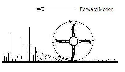

Well, I can't see the knives from here so it's hard to tell which way they're suppose to rotate. :confused2: You also didn't say which way it's rotating now. :cool:
Mine uses the "folded spoon" style knives. When the knives are hanging down, the cutting edges face the front. This is because mine rotates back to front.
