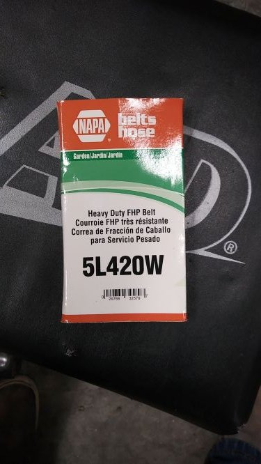

The belts on my Bestco 48" HD Flail only lasted a few hours, this is a Kevlar replacement belt from NAPA and I probably have 10 hours
and they show no sign of wear since replacement.
