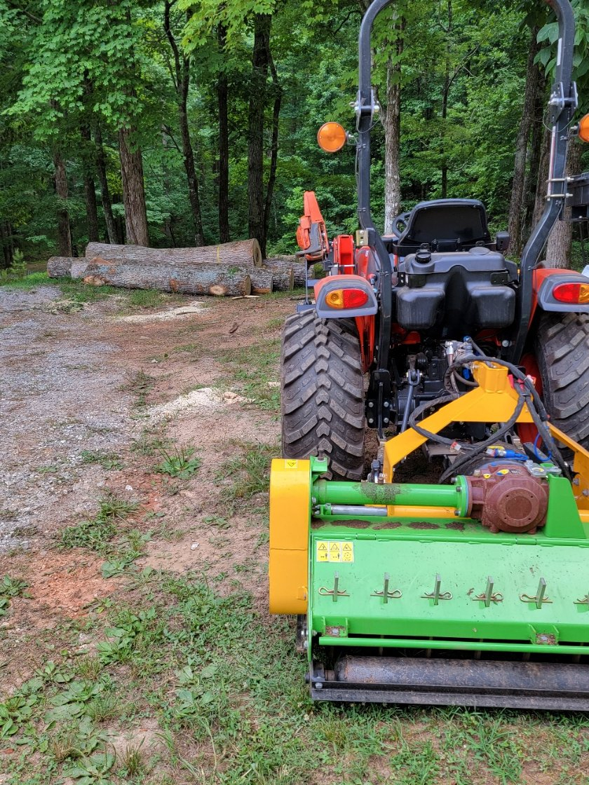

I received a 53" NOVA MFZ-135 back in May and used it for a couple of hours on the property. So far I'm very happy with the results. While it would be nice having a wider mower for grass cutting, the width of this unit is great for getting through the woods and in tight spaces, the side shift is also helpful to get close to fences and other areas. The people at Nova Tractor in Texas were very nice to deal with. I also purchased a couple of the extra hammers just incase 😯 There are some rocks on the property and we are collecting them the best that we can to minimize issues. It does chew through branches, saplings and brush very well but I'm not looking forward to finding any rocks with it.
Since it is the heaviest rear attachment that I have (840 lbs.), it has also been great as a counter-weight for moving/loading some logs... (y)

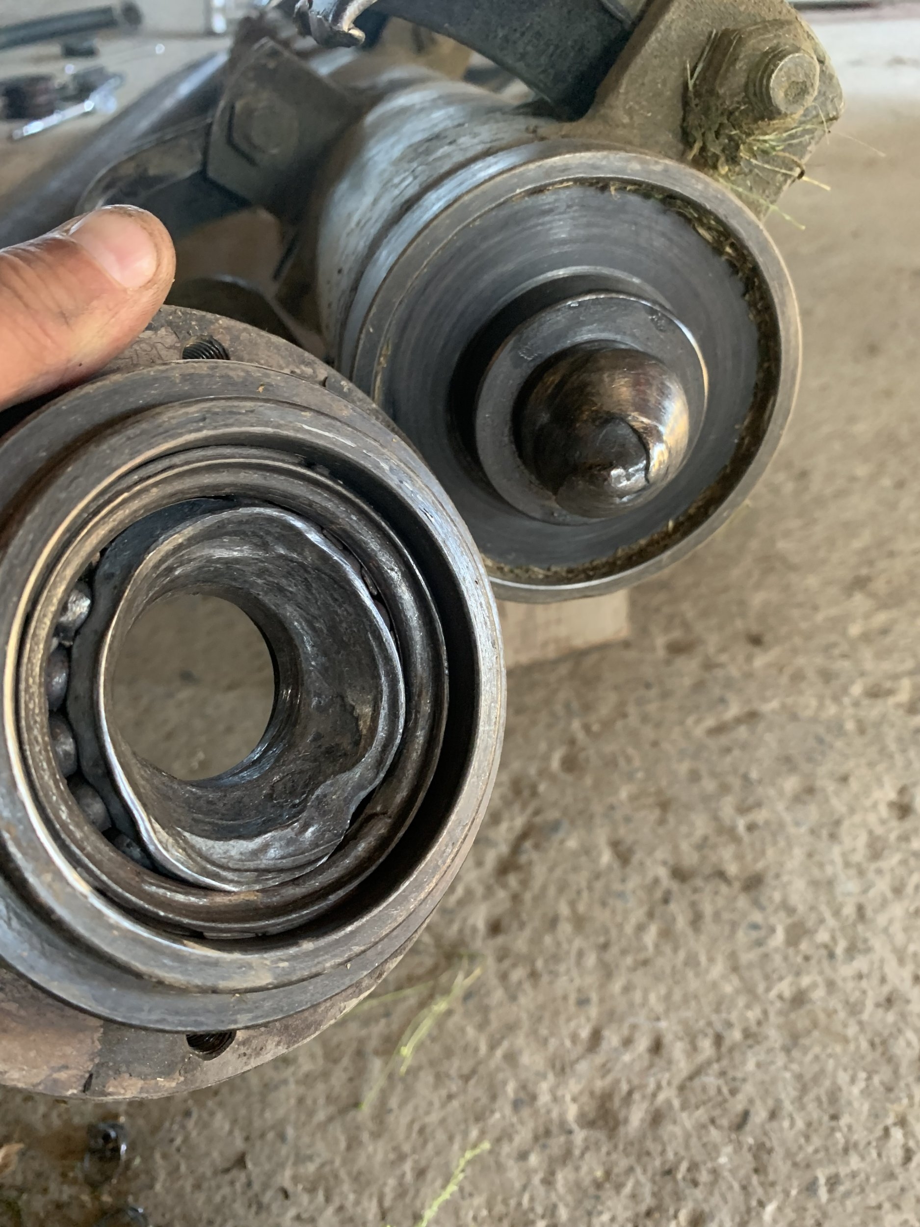

Well, ugh. I bought my flail mower new last fall. Had some initial belt breaking issues, and problems with untorqued bolts. Got it figured out this spring, but things got way out balance this afternoon. Mower only has about 30 hours on it, and I think it is pretty much toast. Manual emphasized to NOT grease the bearings yet, but here we are. I am hoping for a warranty refund, since it appears as though a replacement us not available.
I will likely be hunting a new 6'-7' hammer, hydraulic offset model. Mowing fields edges, fence lines, and thick/wet/weedy areas. Any make/model suggestions? Hopefully something without a long lead time either.
Double ouch, not greasing it; no way in HEdouble hockey sticks!!!!!!!!!!!!!!!!!!!!!!!!!!!!!!!!!!!!!!!!!!!!!!!!!!!!!!!!!!!!
The two flail mower brands I would recommend you look at are Maschio and Dell Morino.
Sent you a PM.

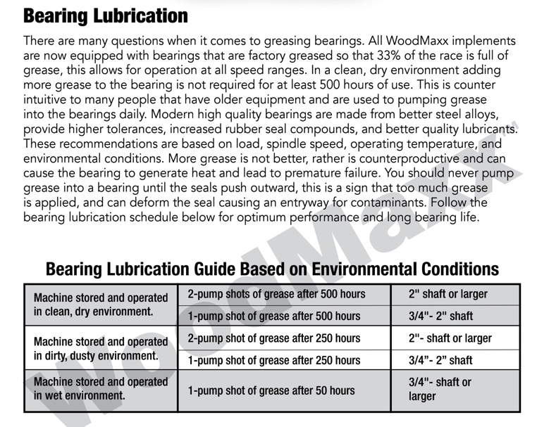

Here is the lubrication schedule. They make it pretty clear.
