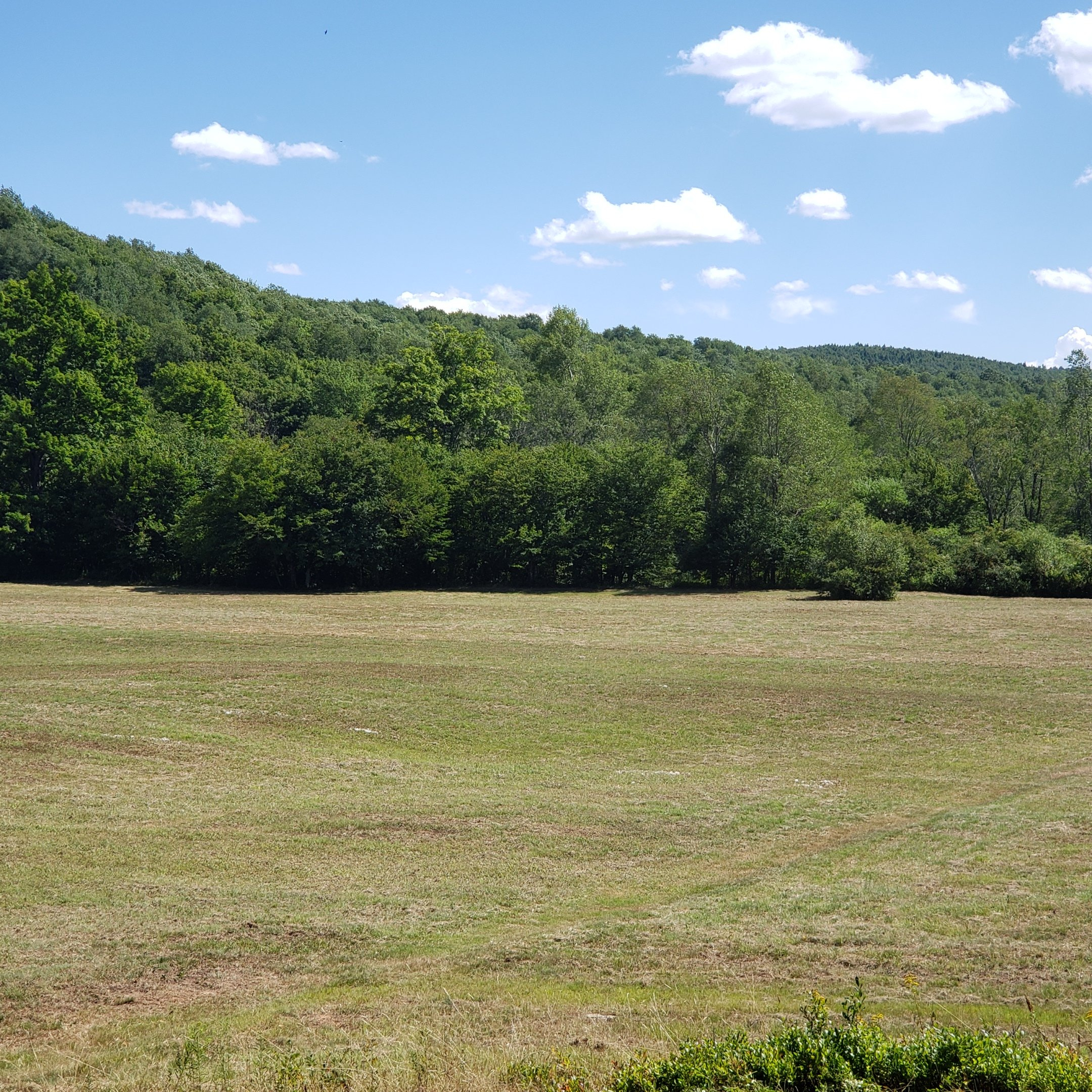

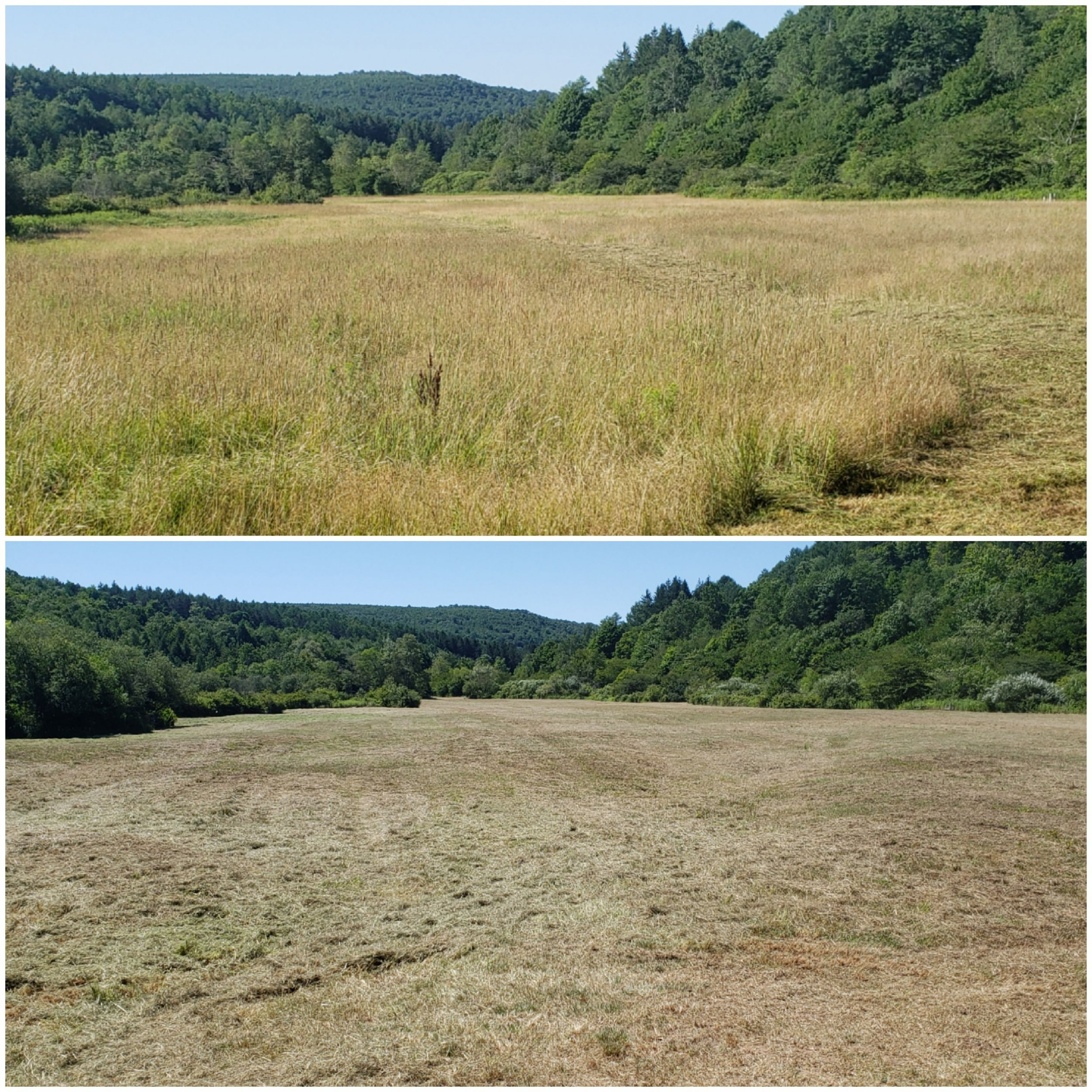

Update on my flail (JD 25A) first use and first time user. Cuts so much nicer than the brush hog and no rows. I love it! Some of the field was a 2nd time cut but most was first time through. Since it has been so dry it cut fairly easy. Fuel intake seemed to be about the same for me. The before and after pic is first time this year and most likely last. These fields are in the mountains in north east PA about 2100 elevation and I only keep them mowed so not to be over taken with brush. 2nd pic is a different field with a combo of 1st and 2nd cut. 2nd cut was like a lawn mower.
Only issues I had were rolling fields so it scalped a bit but not bad. Less than the hog. Bigger issue was some of the grass was thick and wrapped on the rotor and wrapped tight she started smoking after a bit. I cleaned it out and the belt side wrapped up again but other side wrapped and then cleaned itself out. Belt wasn't hot or smoking and neither were the bearings. I thought it was that at first but it was the friction of the grass and rotor from what I can tell. Grass was burnt black on the real packed stuff. Just had to keep and eye on it so as not to torch the field. Had to go about 0.5 mph in the real thick stuff. Not sure what that grass is but its near swampy areas and gets about 2 feet high and super thick. Good news I don't have much of it. From what I could tell it doesn't like the tall thick stuff. It doesn't like soft ground either.

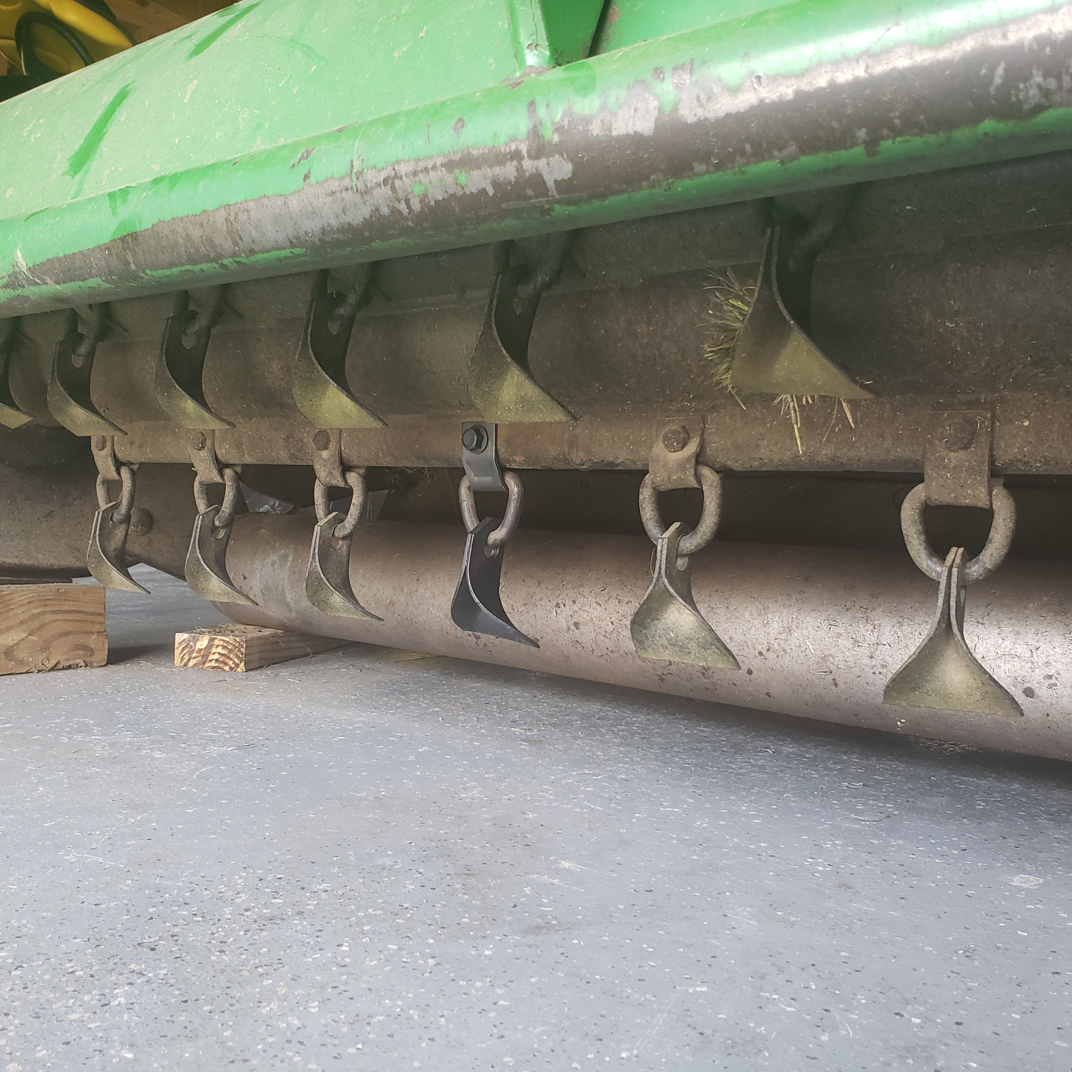

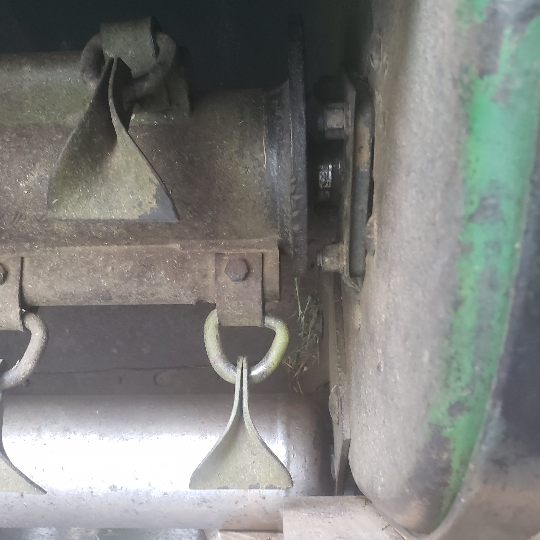

leonz - I have an iMatch quick hitch on it and flail only has one hole. Its in the float when mowing and raise front end of flail in higher stuff. Real high and thick stuff I had to lift mower and roller up about 4 inches.
Grass wrapping around rotor and getting warm is my concern. I'm guessing that's from grass too high. Doesn't seem to wrap in lower tin stuff. 1st pic is where its wrapping..after I cleaned it out.
Do I have the best blades for cutting grass shown in 2nd pic? Wasn't sure if side slicers would be better Grass only. Very little brush at field edges. Have a brush hog for that stuff sitting nearby for that.

I could see how tall grass could get pulled into that gap.

leonz - I have an iMatch quick hitch on it and flail only has one hole. It's in the float when mowing and raise front end of flail in higher stuff. Real high and thick stuff I had to lift mower and roller up about 4 inches.
Grass wrapping around rotor and getting warm is my concern. I'm guessing that's from grass too high. Doesn't seem to wrap in lower thin stuff. 1st pic is where its wrapping..after I cleaned it out.
thanks again for the help everyone.
Good morning Nittanyjd,
The scoop knives you have are a multi-purpose mowing and shredding knife.
The side slicer knife with the slotted mounting hole is best suited for shredding brush
and mowing grass as you can make multiple passes to shred the grass and brush to a
very fine clipping that will rot away and dissolve in the soil quickly.
