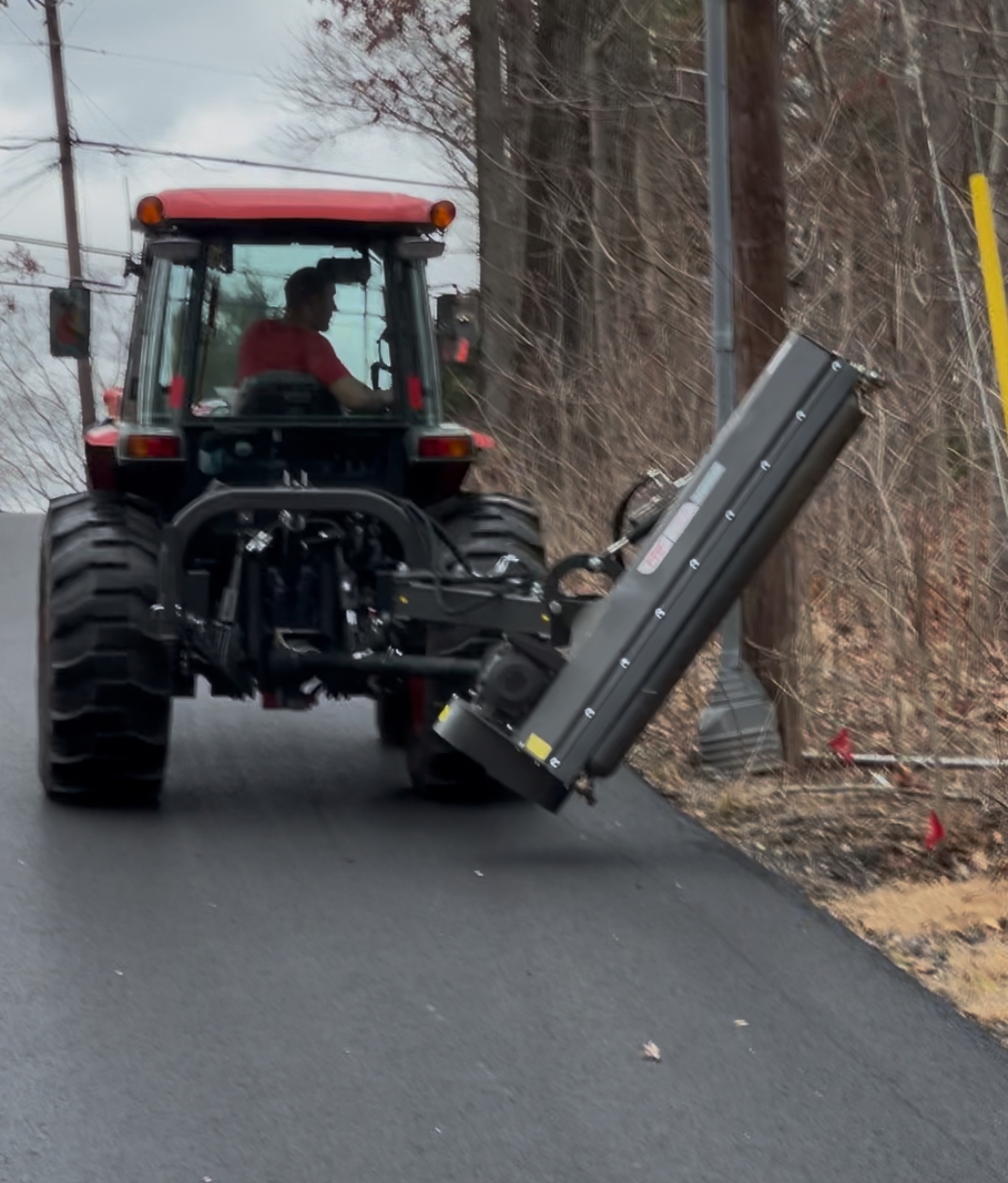

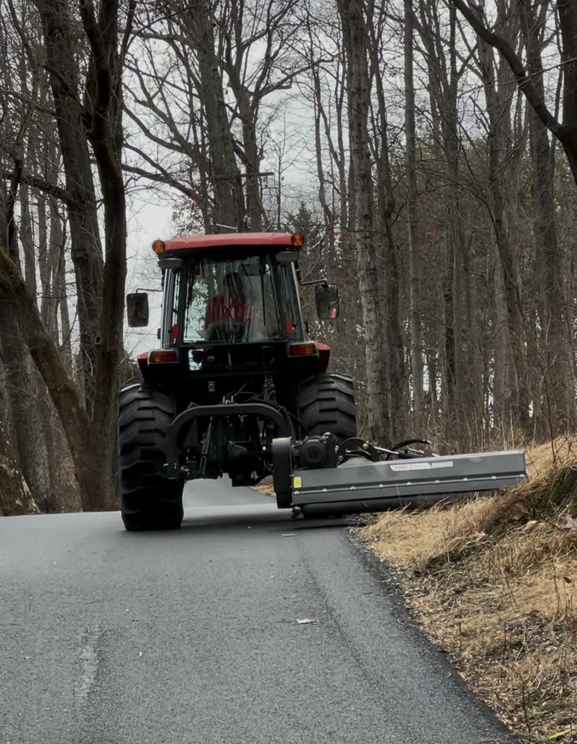

I recently purchased a Ironcraft FRF-165 (165 cm / 65”).
I’m running the mower behind a Kubota L5740 with filled rear tires and max wheel weights and FEL. Our tractors should be along the same weight.
I think it handles the mower well, and is pretty stable. (Albeit I haven’t run it on any extreme slopes).
For next size up in the 78” class, the weight of the mower basically doubles. Given the weight increase and having more offset I think the 78” would definitely be too much for my tractor.
I wanted to avoid the China built units, because I like to avoid China when I can, and I wanted to ensure parts availability down the road. The Ironcrafts are made in Italy by Cosmo, but the price is much more economical than a the high-end Italian Del Morino mowers. So far I am happy with my decision. Might be worth considering if you have a dealer near you.

   / Let's talk flail mowers #8,115
I'm running a Peruzzo Super Bull 2200 (7.5') on a L4060, same frame as this Kubota, only a few less HP. It's a bit big for my machine at 1,500lbs, but has been working good for 5ish years or so. It's an adjustable offset mower, not a ditch bank mower. There is now way I could offset it more than the 2-3' it sticks past my right tire. As it is I rarely lift it off the ground with it fully offset. A ditch bank mower will trail your machine even further back allowing for more leverage.
Don't go to wide or heavy. There is tremendous twisting torque on the 3pt with things offset. Your likely to run into stability or 3pt breakage issues.

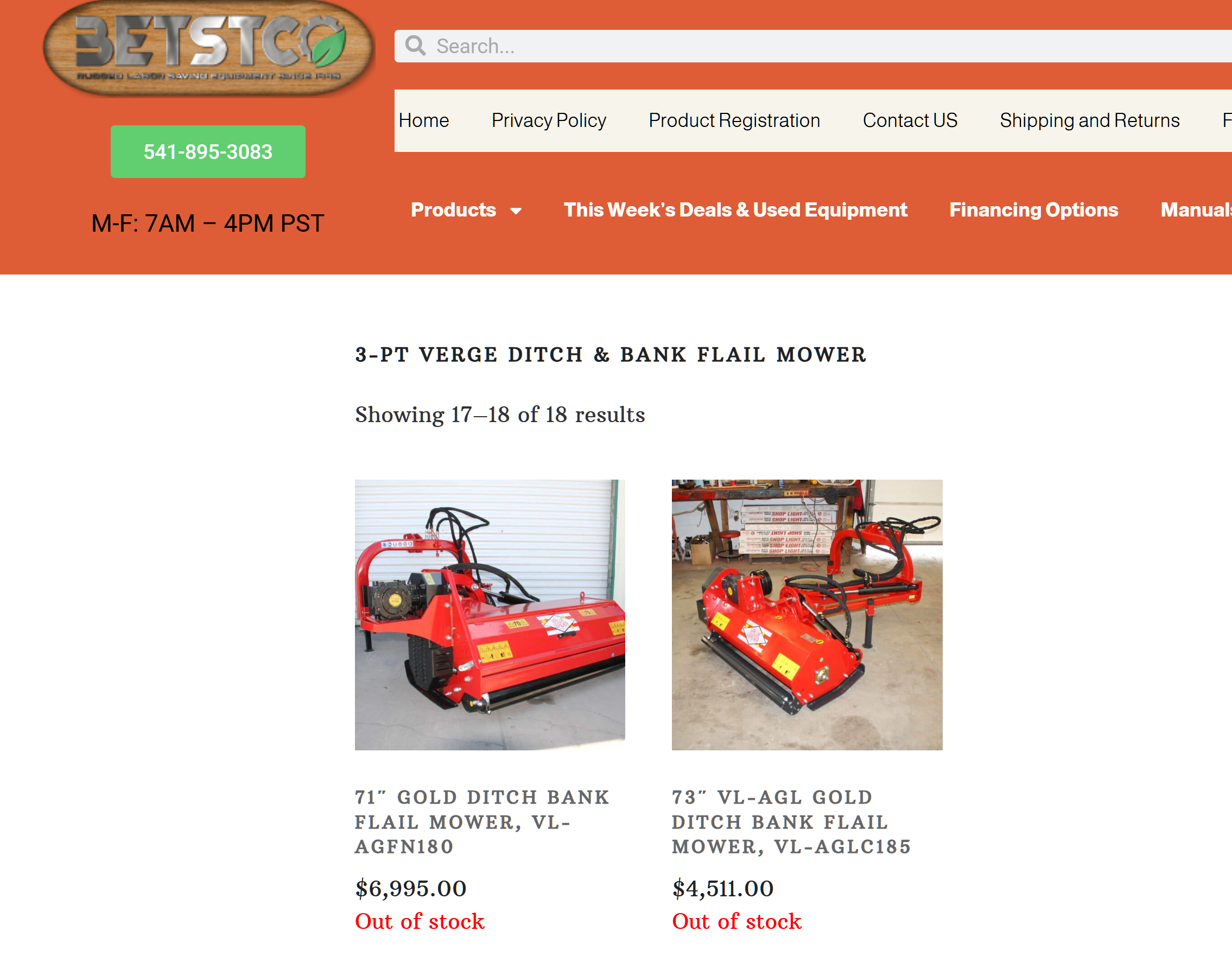

   / Let's talk flail mowers #8,117
What are the opinions on Bestco? They have a 73" that is under 1000 lbs. (oddly, the 71" next to it is over 1500 lbs. ) where does all that weight go?
@leonz , I realize you recommended a smaller unit, but this one has similar weight to the ones your suggested.

   / Let's talk flail mowers #8,119
The light one;
Blade Type: The VL-AGL series uses standard hammer blade. Each hammer blade weighs 14 oz made of cast steel (cast steel is much more durable than cast iron). Use the hammer blades for clearing saplings (2″ diameter or less) and for grasses.
Number of Blades: The VL-AGL C185 uses 32 hammer blades.
The heavy one;
AGFN takes our AGF mower and adds an openable rear deck for faster mowing when you do not need fine mulching (it is also nice for changing blades) a holder for your hoses when not attached and a floating right side 3-point connection to allow the mower greater flex when following the contours of the ground. AGFN verge flail muchers are super heavy duty mowers designed for Cat-II tractors. They feature very heavy 43 ounce cutting blades that can chop heavy brush including grasses, debris, sticks, vines, branches and other wooded materials up to 4” in Diameter.
Only 16 blades "hammers" but much heavier.
Also the lighter one is rated for up to 2 inch brush,
the heavier unit is rated for up to 4 inch.
   / Let's talk flail mowers #8,120
so, a 15 lb difference in hammer weight totals, 5/16" vs. 1/4" walls, etc. larger rotor. Just incremental adds throughout. Amazing it adds up to that much difference.
