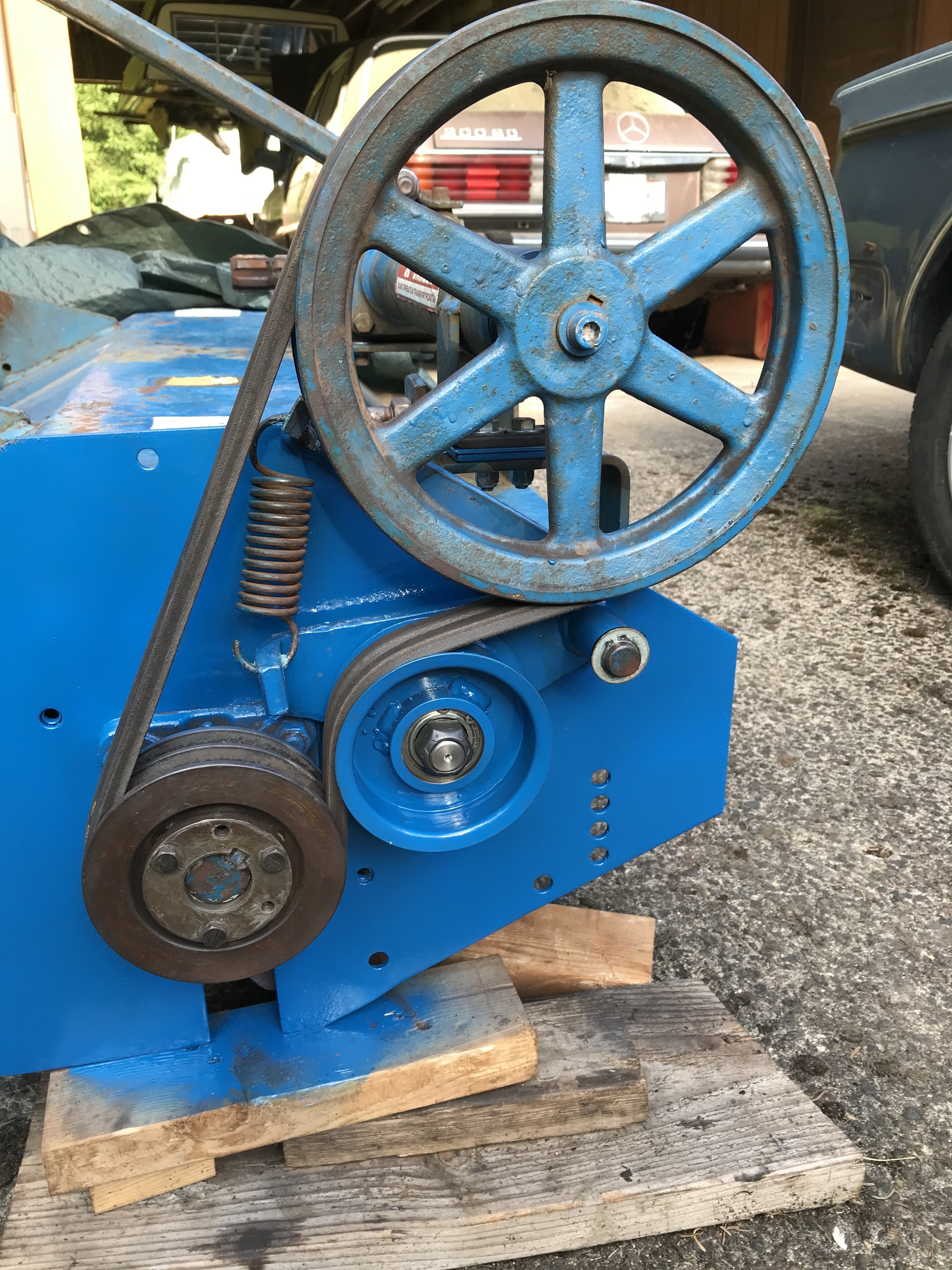

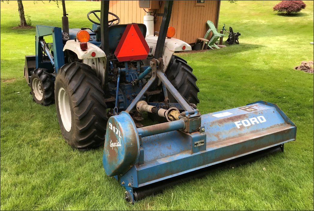

I see often mentioning of V-belt tension gauge which makes me wonder why are the manufacturers not using spring loaded tensioner, like shown in my old Ford 917L Special below - perhaps it's just cheaper to make them without one?

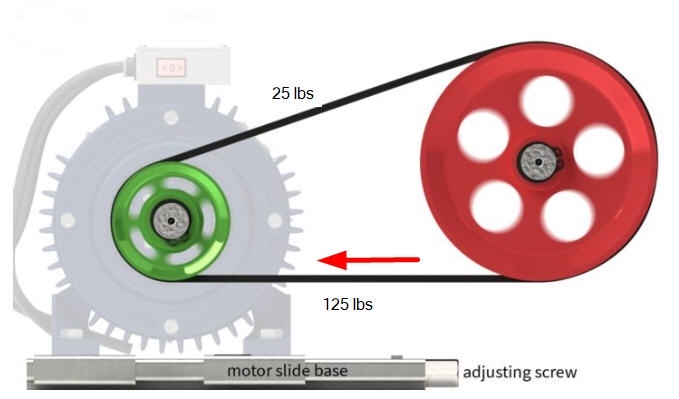

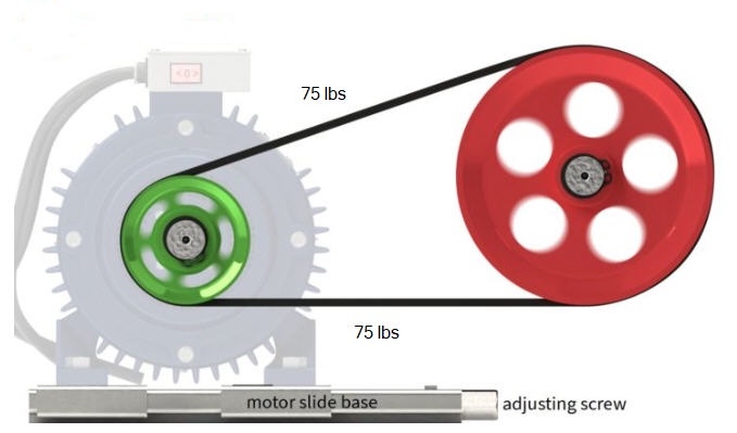

Here is a typical drive with 5:1 tension ratio at full load. Wonderful. Look what happens to tensions when the loading is lightened or the drive stops:

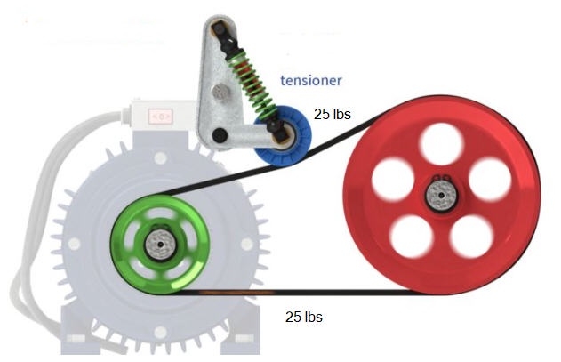

Now add a backside sprung idler tensioned for full load.

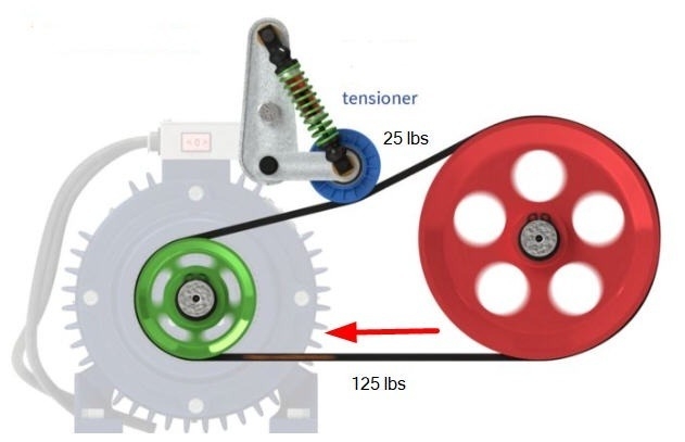

Same result right? Now analyze at low or no load:
Huge difference... belt tension lowered by 1/3!
If a drive only see's constant loading (air compressor for example) a sprung idler doesn't offer much advantage. If a drive will see variable loading (like mowers).... a sprung idler lowers tensions considerably and increases life on belts, sheaves, and bearings. Adds cost though. Hope this helps!

Yes! Cost. Retired tractor engineer here. You typically see sprung tensioners on high quality drives that see variable loading. Why? The belt tension is held to a low constant regardless of the loading allowing long life for the drive.
Many belt manufacturers advise their V-belts run to a 5:1 tension ratio (although ratios as low as 10:1 run fine without slippage).
I bought this mower five years ago as a fixer upper and it has worked out very good without any need to mess with the belts, once I figured the correct belt length.
This is obviously light duty mower with side slicer flails and it does a nice job in mowing a field, as well as forested area, without any scalping.
This thread has been very helpful for me!
View attachment 4184713 View attachment 4184711 View attachment 4184719
