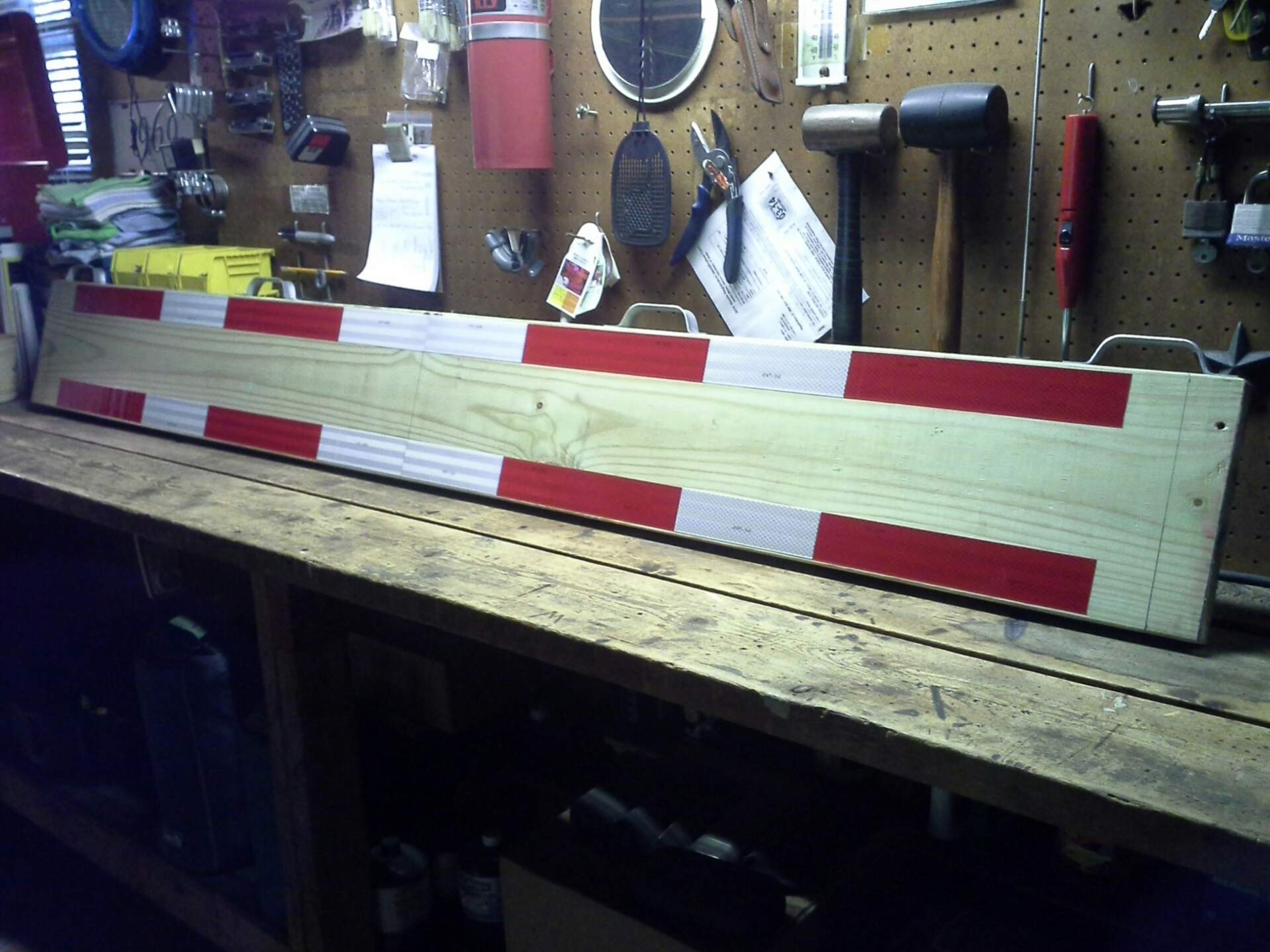

I hope this gets drivers attention, I would hate gettin' rear ended :eek:

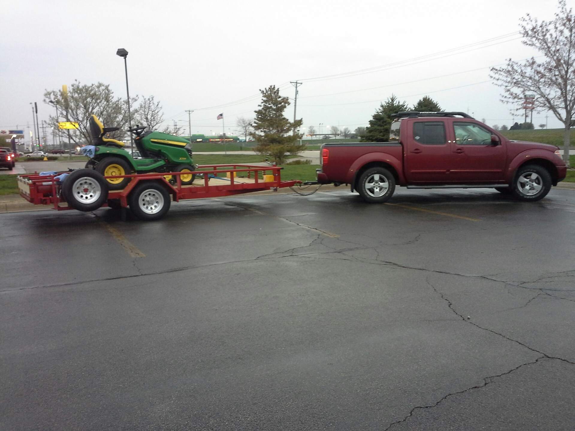

Well, the trailer did great, took it up to EauClaire,Wis, 825 miles total.
I do/did not need a tandem:p tires at 50 PSI, also balanced.
My 8 inch hitch extension was flawless, anti rattle gizmo's work great.
You could honestly not tell the trailer was behind the Frontier.
I am running 180 pounds of tongue weight, the Deere X534 is near 840
pounds the way it sits.
I ended up taking out two more chain links on the safety chains.
I could not be happier, people, please don't cobble things together
I am glad I took my time and bought good stuff:cool:
