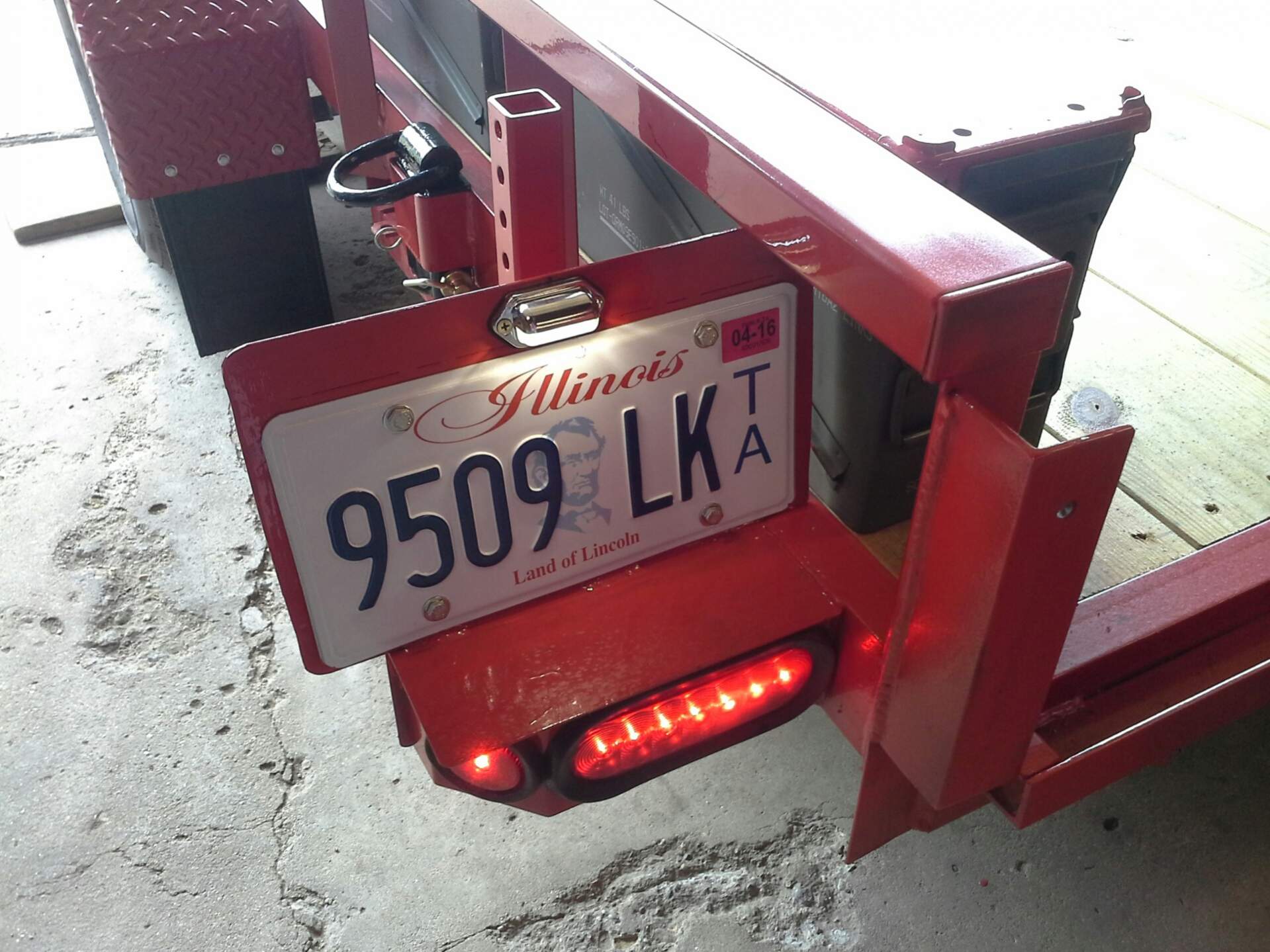

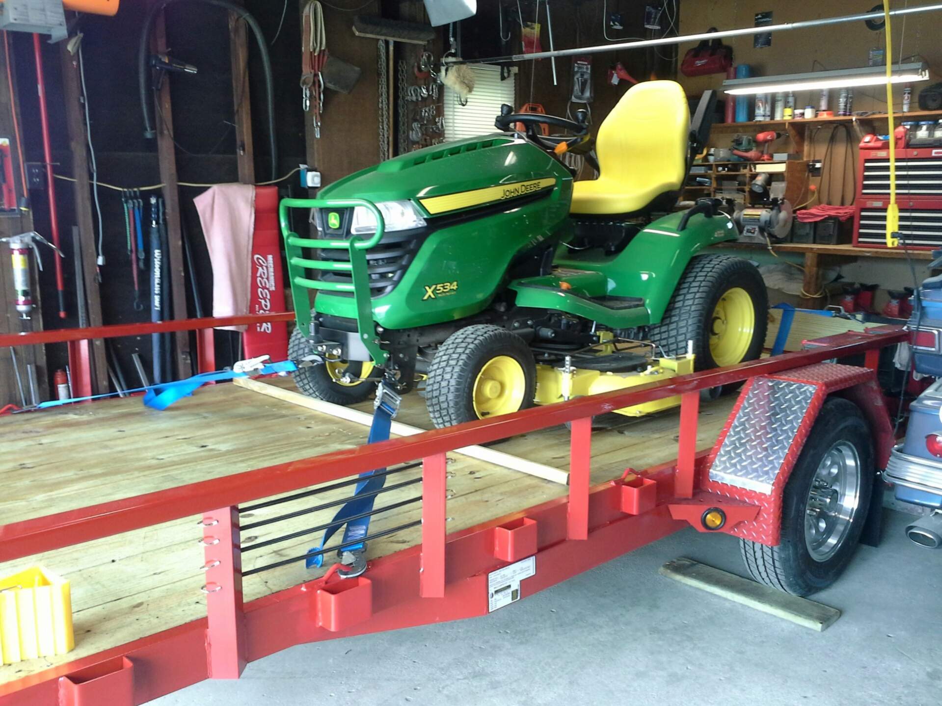

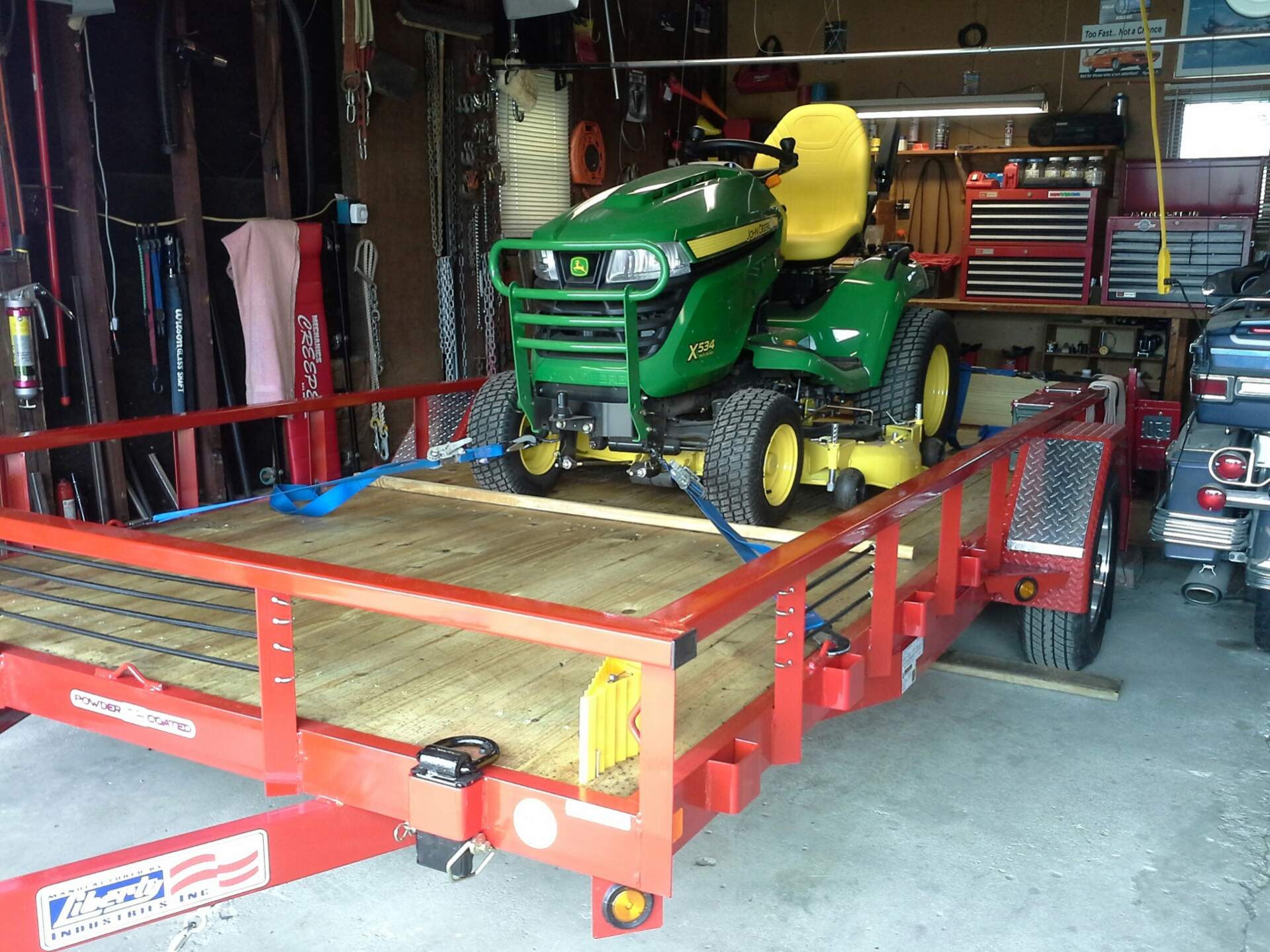

I think I might be done or about 99.9% LOL
Two LED license plate light from Etrailer=very bright.

She sure looks sweet on the trailer.

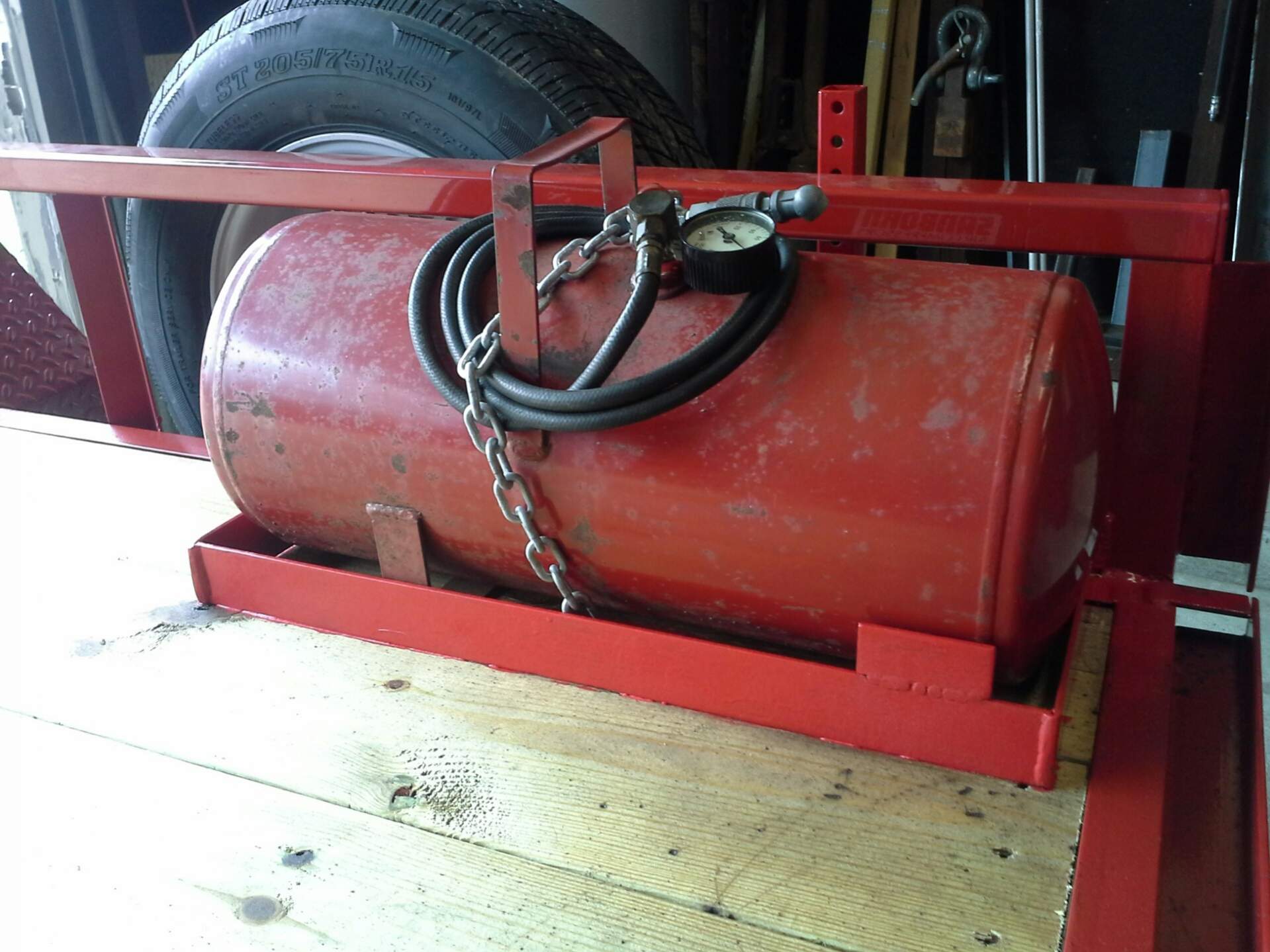

Made a frame for my air tank.

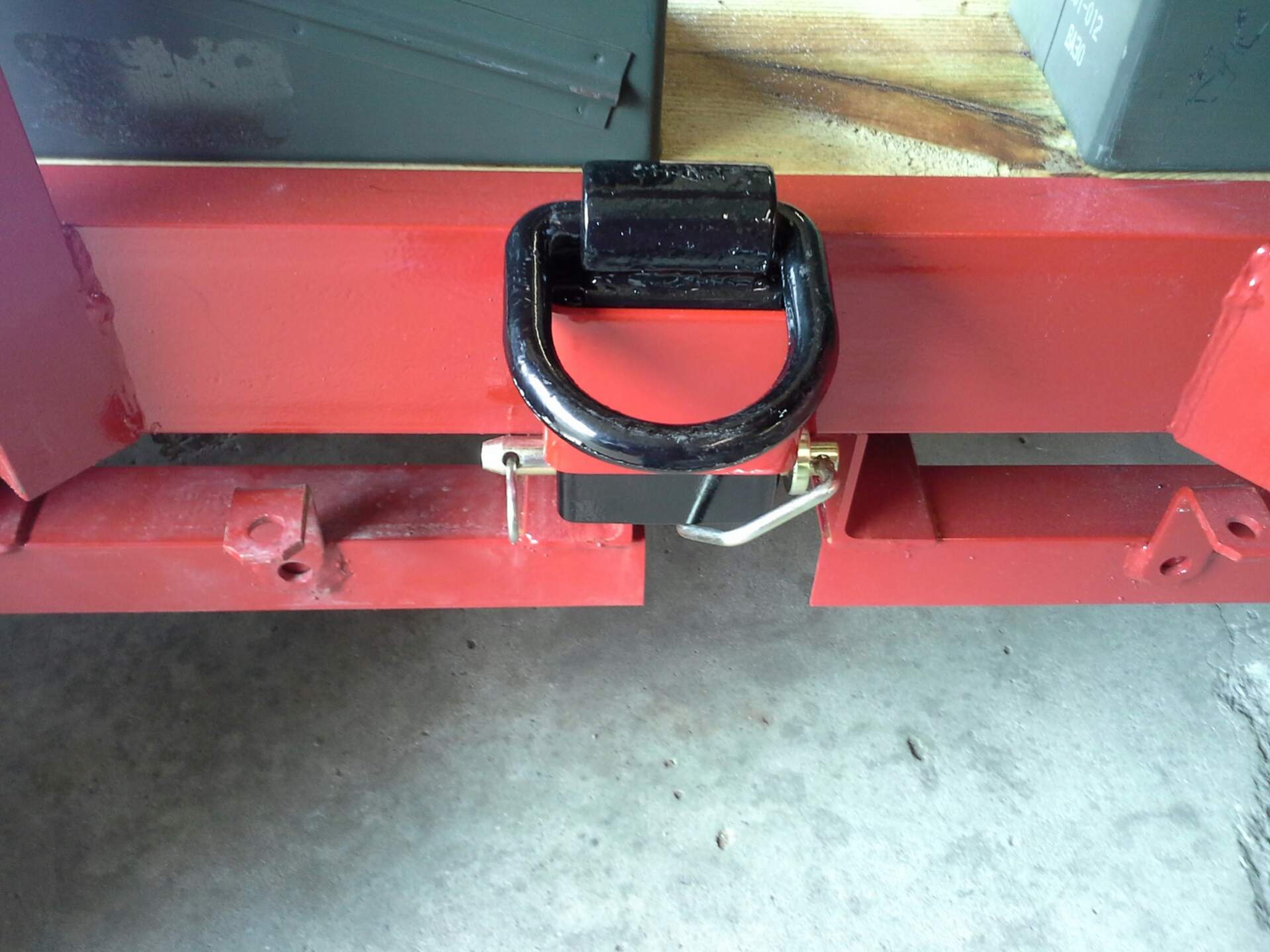

I thought that I would never do this, but, I drilled a 1/4 inch hole and installed two hitch pins:p

Here is what I just love, when I did the rear gate delete, I didn't think I was going to get the ramp baskets, but they put them under the trailer, it is so nice not having the ramps on the deck, another tie down, I had to shorten this one a bit.

Good job on the hitch pins for the tail gate. I was lucky when mine came off it was on a rural 2 lane and I noticed it right away after hitting the bump.
You won't always have an interference fit when the wood dries out and shrinks.
