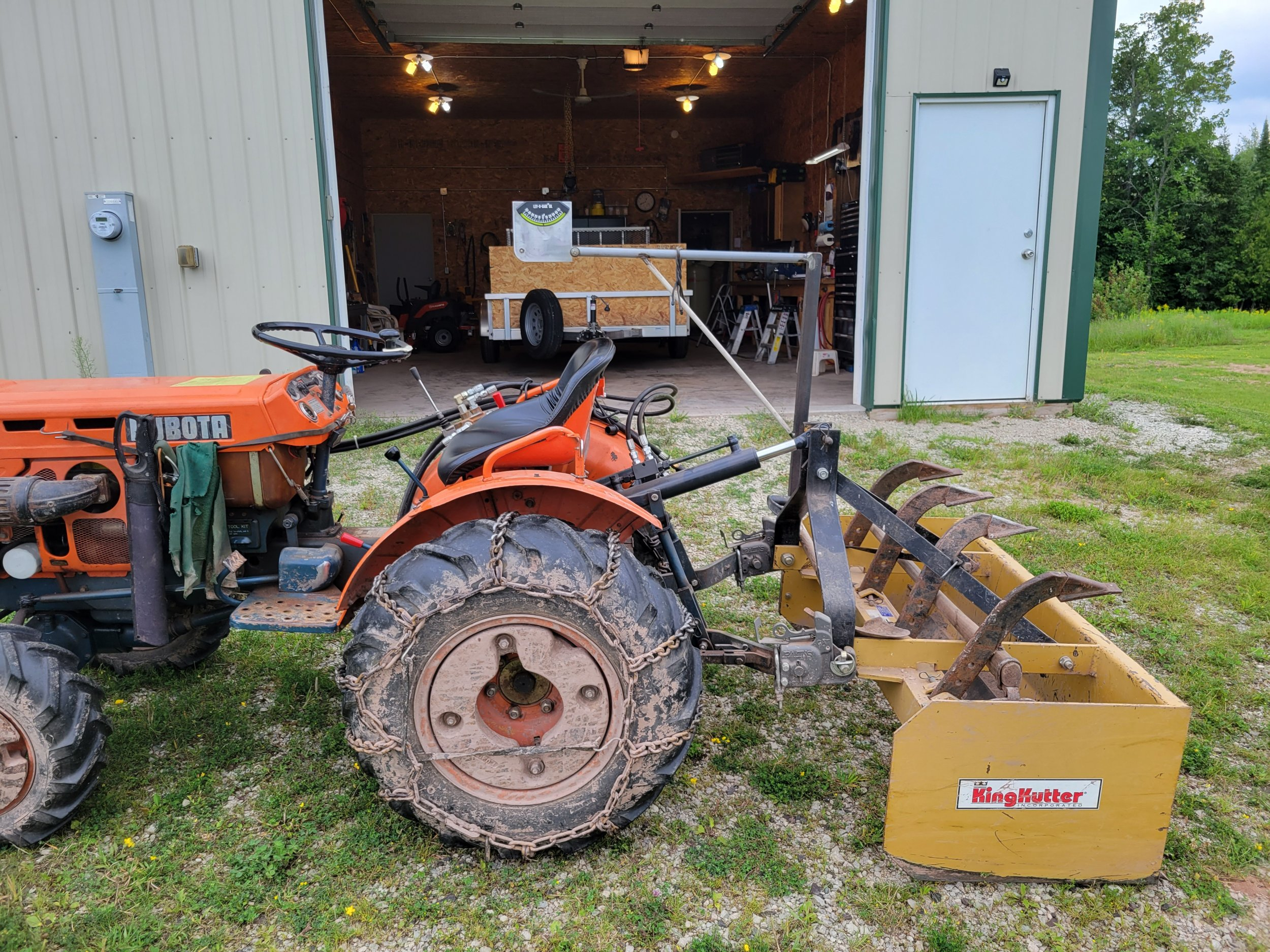

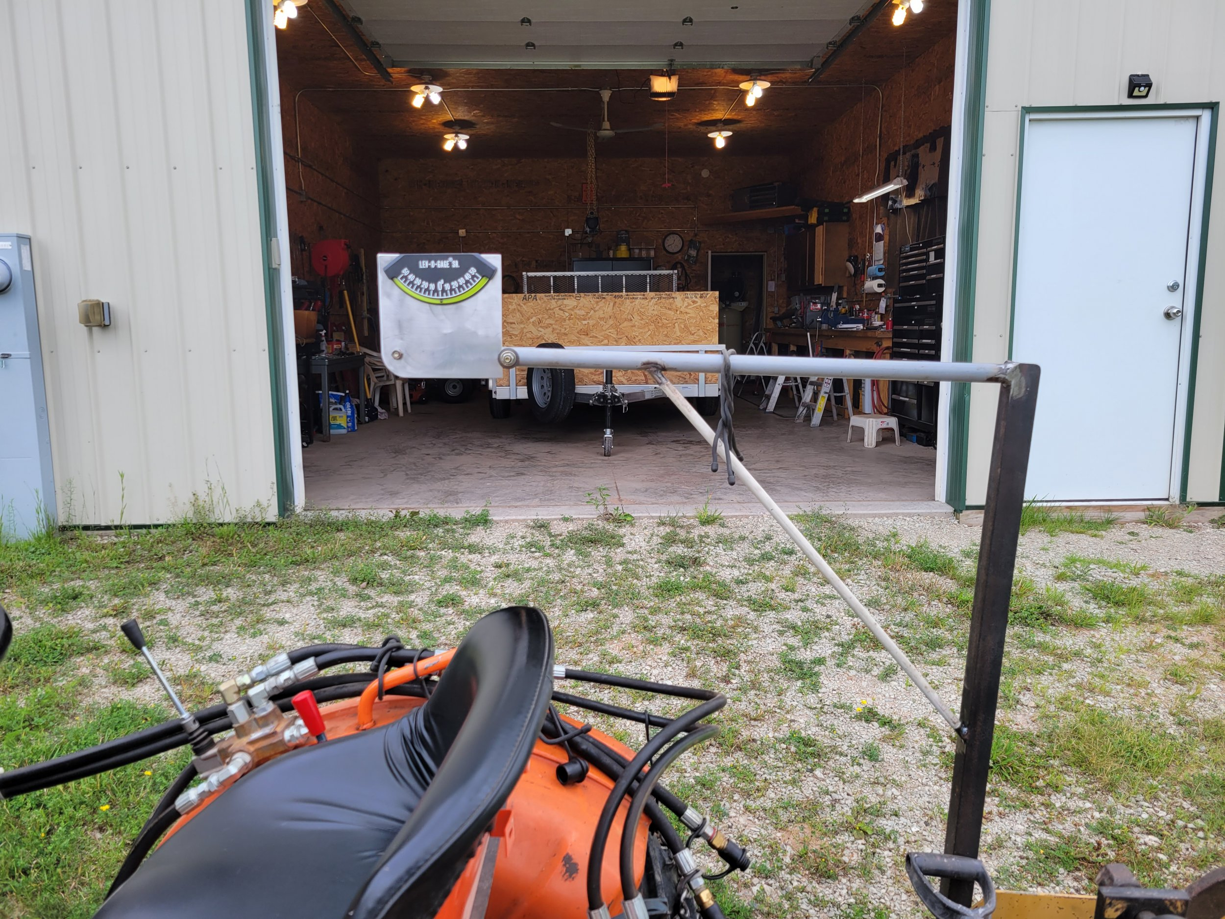

I came up with something like that for my B7100. I have arthritis in my spine. I can't see the hydraulic top link or the blade. Mine is not fancy, but works great.

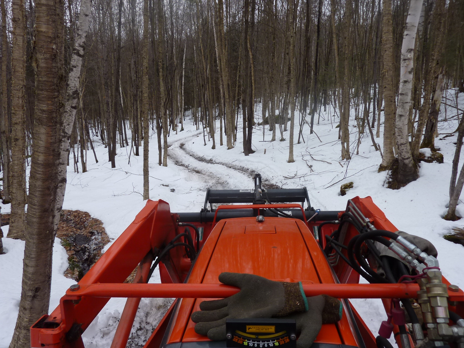

I use one of those inclin-o-meter things. I find it quite helpful for setting and checking road contours. It tells me what the slope of the road is. If it is not what I want I adjust the blade relative to the road to make the correction. Low tech but simple, cheap, and works well on curvy hills where it is hard to eyeball things. Plenty good enough for me to keep the water running off the road. This is mine - stuck on with double sided tape

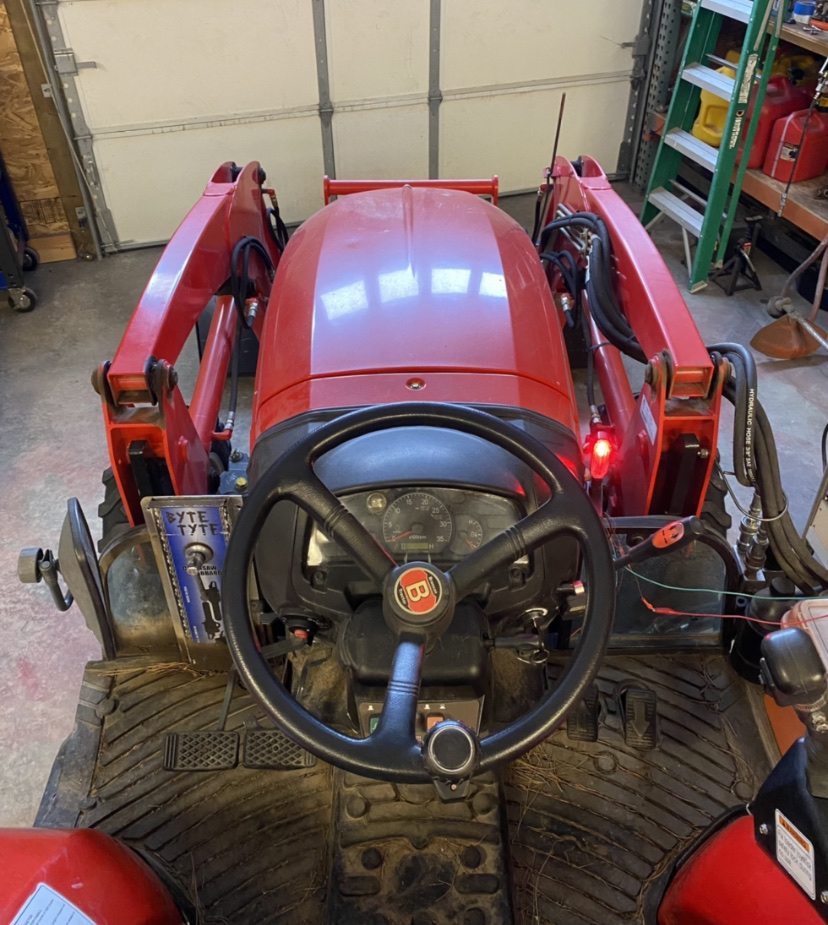

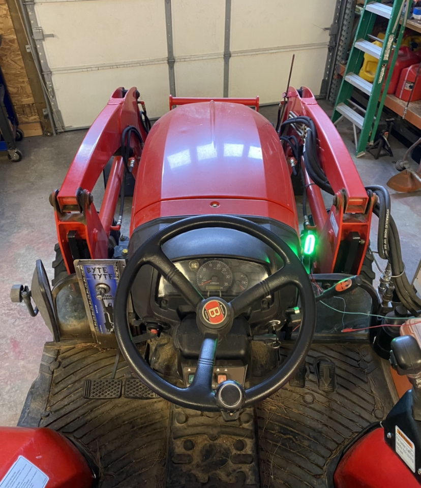

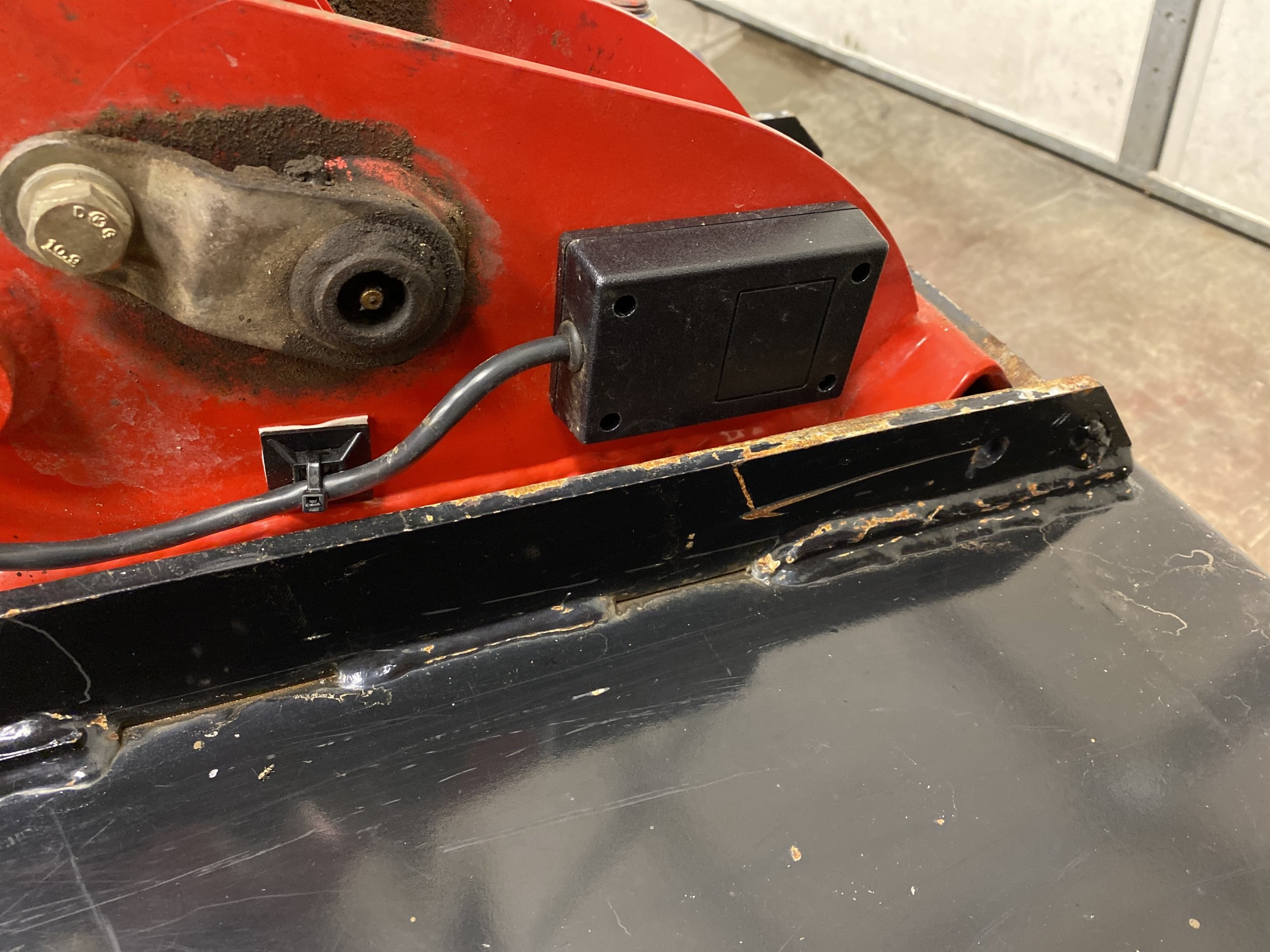

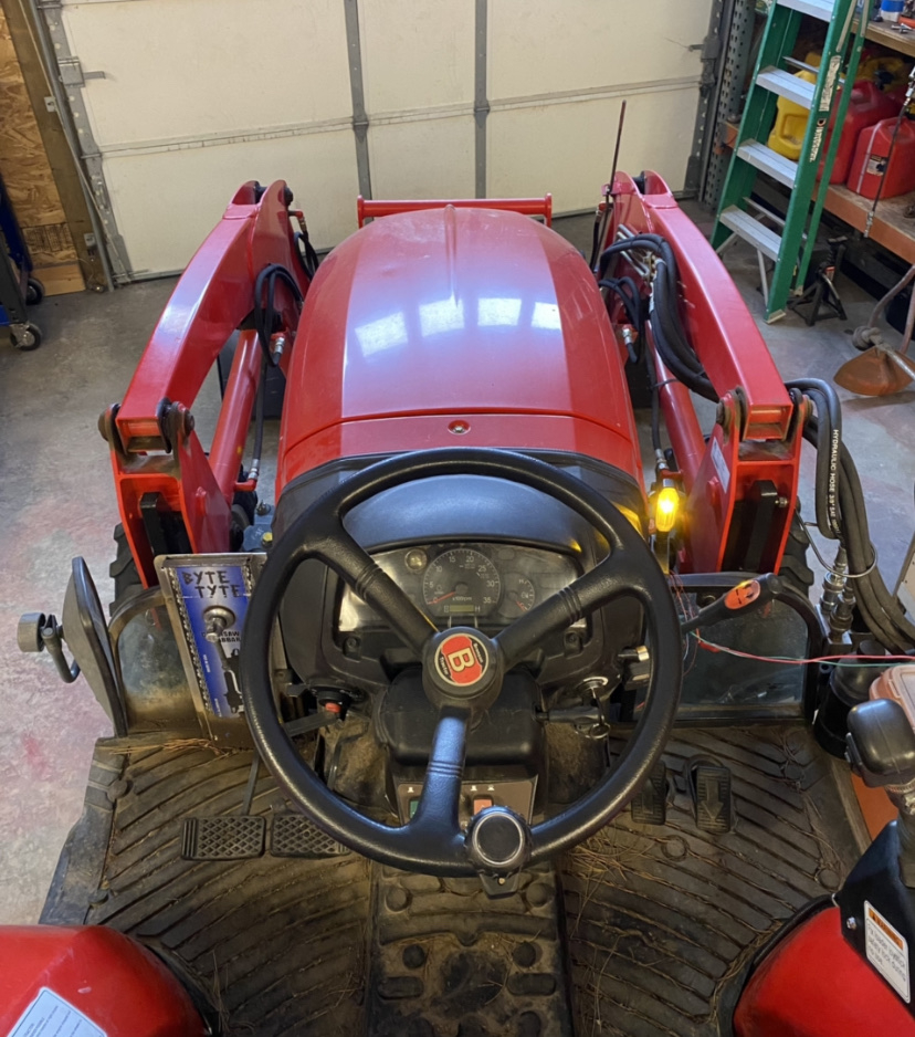

This is my work in progress… there’s two inclinometers, one on the tractor where the light is mounted and one on the quick attach. It’s hardwired between the two and has a power saver feature. I can select the base reference of either the tractor body or relative to gravity. In both modes, I can tare it to zero out (which is useful for different implements). There’s 5 light positions. Green indicates -3° to 3° reference while amber (between 3° and 5°) & red (more that 5°) flanks both side to denote how much positive or negative tilt.
Also added is the 3 level dimmer selection. All from one momentary button to select level mode, brightness, tare, and power on/off.
Pics shows mock-up testing of LEDs. It’s now hardwired into place and am doing trials.

   / LEVEL INDICATOR FOR TILT CYLINDER ON TNT #27
Pardon my french, but that is BADASS!! Great job!
