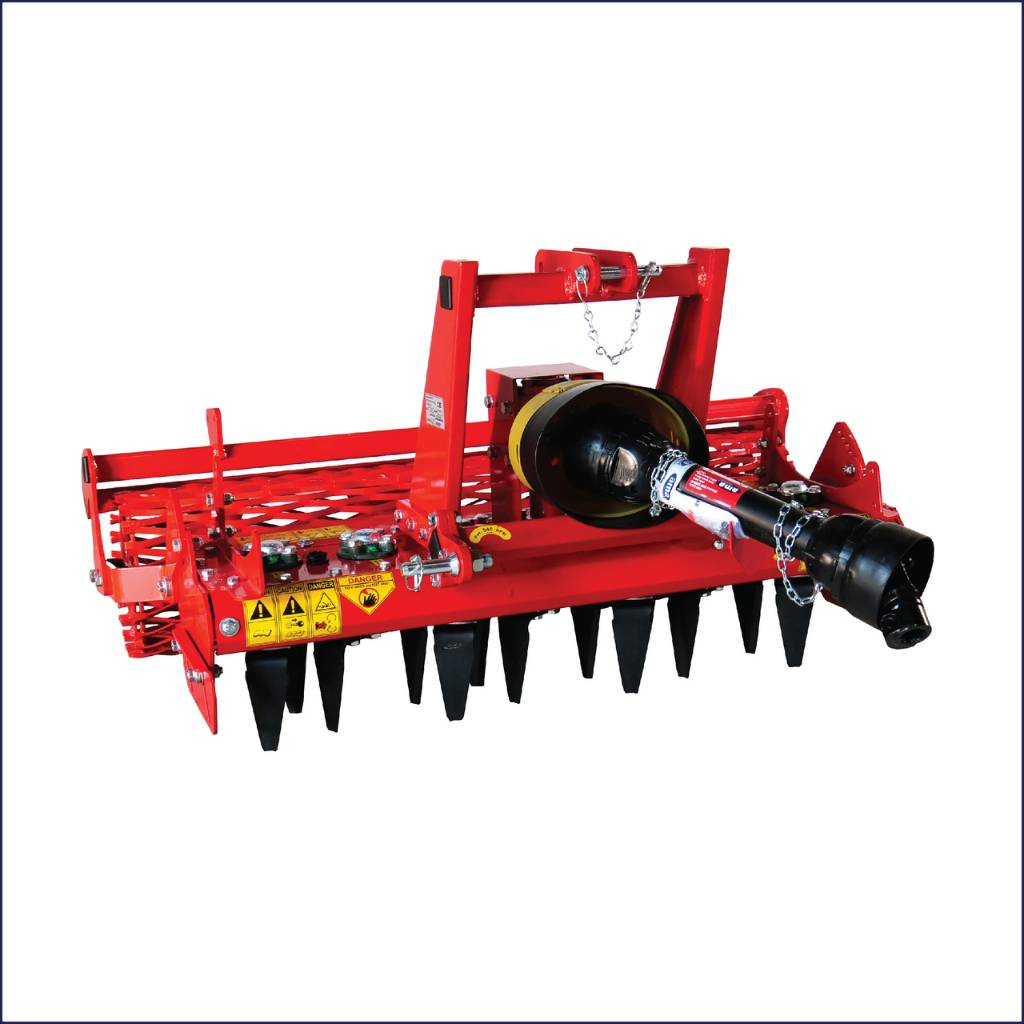

Till as shallow as you can, and drag between tills to flatten and level the surface. Till, drag, till, drag, etc. The problem with deep tilling or disking is the disturbed soil will continue to settle (unevenly) for a couple years and you'll end up with dips and humps again. A shallow till and many drag passes gets you good compaction and a smoother finish in the long run.
Thanks so much for the great advice. That makes perfect sense!!

I recently started mowing more and more land around my house to have a nice lawn. It’s about four acres, the rest I brush hog. It was pasture land and is rough on the kidneys and back so I want to level it. Should I start with a pto tiller, disc or box blade? I have access to all three. I’ll finish it with an eight foot piece of railroad track that’s heavy and flat. Thanks in advance!
My vote is the tiller. You'll never get the finished lawn you want using the box blade or discs. I've used them all plus a land plane, box spring, dozer, FEL & spring tooth harrow. With time and effort you can make any of them work to some degree of satisfaction I guess, but the quickest and smoothest is to start with the tiller. Just IMHO.
