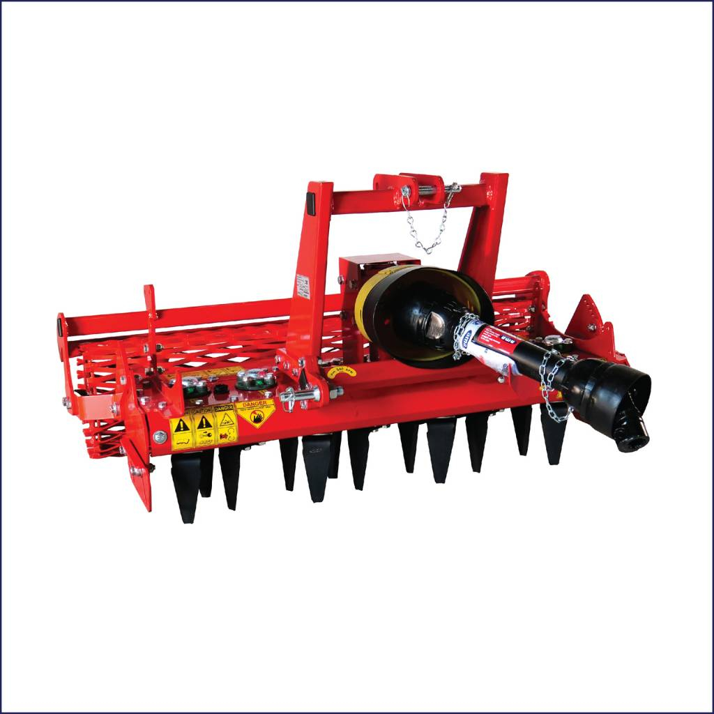

It just occurred to me and rarely anyone mentions them, if the ground you are trying to level is not dried clay hardpack/hardpan, the best tool for the job is to rent a power harrow.
The power harrow is pto driven and vertically mulches or stirs the ground rather than lifting it like a tiller/cultivator/disc does.
Or use it after tilling/disc/etc to break up the big chunks.
The other similar tool is a mulching flail but I rarely ever hear about anyone rent them out. View attachment 705340

I just watched a video on a power harrow and that looks really cool. I’ve never seen one before. I do however have a lot of clay here in Northern Louisiana and Monday morning I’m going to start tilling. My plan is to till then rake. Then, rinse and repeat until most of the grass is gone and in the burn pile. I’ll drag until hopefully I have smooth terrain. Thanks for your input again!
