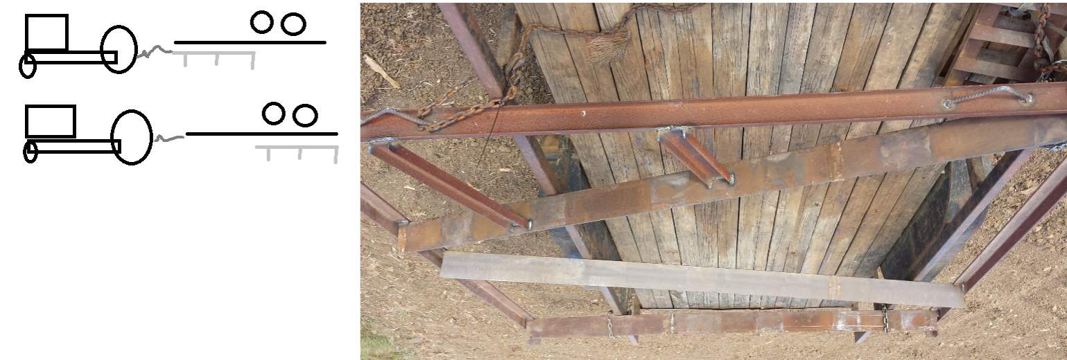

160lbs? i might bite but 1600lbs?
i just realized you have it chained to the trailer *uth oh* planning to tip the entire thing up side down when ya get to were ever? ok 1600lbs!! wow!!
i could see the RR spikes as well. ya just might loose some though. i am not seeing how you could get that much weld beads on them, and keep them from bending/breaking off. i would think you would loose to much of a spike length just from welds to keep them held on? *looks confused*
Flipping it over to drag? Negative! I let it run on the skids, the way it's pictured. Not sure I could drag flipped.
   / Leveling Drag----and I have searched. #12
TractorData.com John Deere 6605 tractor information 95hp tractor, 4 foot or so wide bed of a trailer it looks like, and a metal frame drag guessing 6 to 7 feet wide. i doubt you will have issue with dragging it all. "trailer and all flipped upside down", if it is planned to run on skids. flip it over on trailer. and re chain it back down.
and yes it was late last night when replying, and very early for me this morning, so i am not all there with it just yet.
but your picture reminds me of "tractor pulling competitions" i think you have it in the bag, exception traction being only concern!
ya i just realized, it was a double axle trailer... took me a while to catch that it was double axle even after i drew in 2 wheels for one side of the trailer being upside down..
still 1600 lbs, and jumping the width / length up to what 8 to 10 feet wide and same in length it looks like. you still have a low PSI that sets on the ground. that might be good for floating it across the ground, but not much getting it to drop down into the softer dirt and move it about.
honestly i would flip that drag up side down to let it drag on the skids like you want it to, maybe add a couple extra supports to trailer, then chain drag and trailer together and then once at site flip entire thing (drag and trailer as one unit upside down) and go.

ya i am still waking up, and the foggy mind of mine starting click, the upside down trailer with drag, chained to it, once at the given site, would resemble more of a "motor grader" setup. and some horse arena drags. being able to adjust the drag back and forth on trailer to re'adjust the weight on the drag. ((letting the sides of trailer act some what like skids themselves when upside down in the dirt)). it would keep the drag firm, and in place and follow along, vs corners of the drag wanting to flip up and/or dig into the ground and hip hop on ya.
I have a 4 or 6 footer i don't remember right off been a couple years, drag harrow. ((RR spikes in essences)), that i can adjust the angle of the spikes. it is an old single section from a bigger field tractor / implement setup. by itself that thing will barely got into the dirt. at slowest speed i can set, and then raising front end all the way up to put all the press on i think 10 spikes. it just does not cut the cake, without me adding extra weight to the top of it. i don't see your drag being any different. without extra weight.
from dragging logs, chain link fence, disc, etc.... weight is king. or you spend and easy 10 times longer trying to level things out and smooth things out. once you get to were you want, then ya start taking weight back off. but not until then. at least that is how it has been for me.

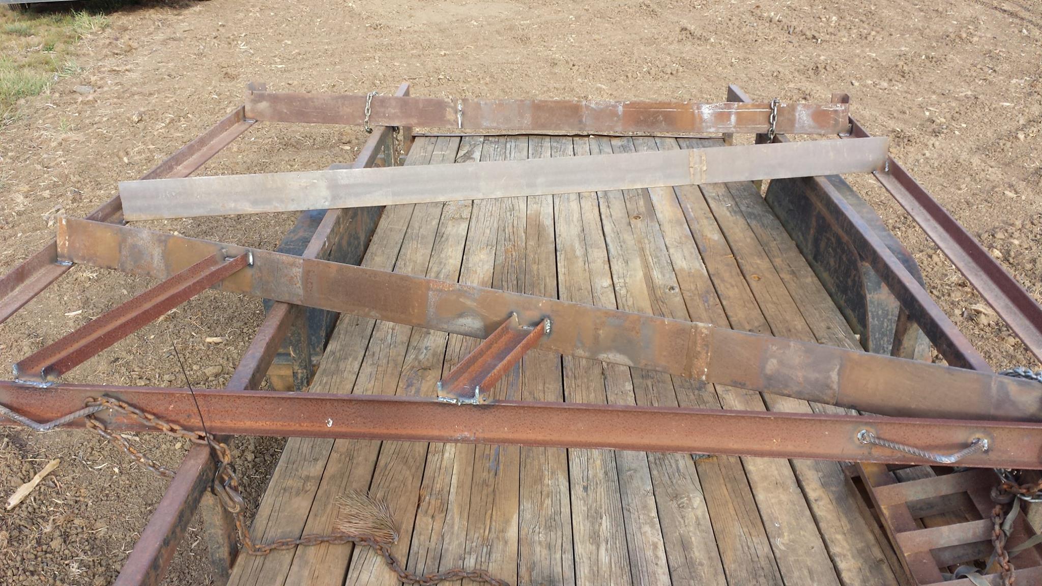

Well here is a rush build. It is pulled with the first blade angled, 2nd blade angled in opposite direction, and last blade is straight across.
Maybe it's still too early in the day for me too, and I didn't read all of the other post before I made mine, but I still have to stand by mine, with the possible exception of adding weight, if it really does weigh 1600#.
Could you please to re-explain your plans on how to use it for me in small words?
Is the trailer part of your plans to drag or not?
Does the metal frame itself weight #1600?
Is the view you've shown of the top or bottom?
I presume that this is a view of the bottom, given that unless you flip it over, the frame going around it will be in ground contact, mostly negating the effect of the "blades" you made.
If I am correct, then won't the two braces you have holding the first "blade" in place be digging in when you try to pull it?
It looks like the leading ends of them should be moved to the other side [the bottom as displayed in your picture] so that they're on top when you pull it.
Otherwise it's a nice looking drag, though I'd have to agree with Mr. Boggen, it also looks like it needs more weight.
I think that may be the only real advantage of using RR rails, they are so much beefier and heavy than the usual steel we private citizens can lay hands on.
Nice work, I hope it kicks butt and takes names for you.

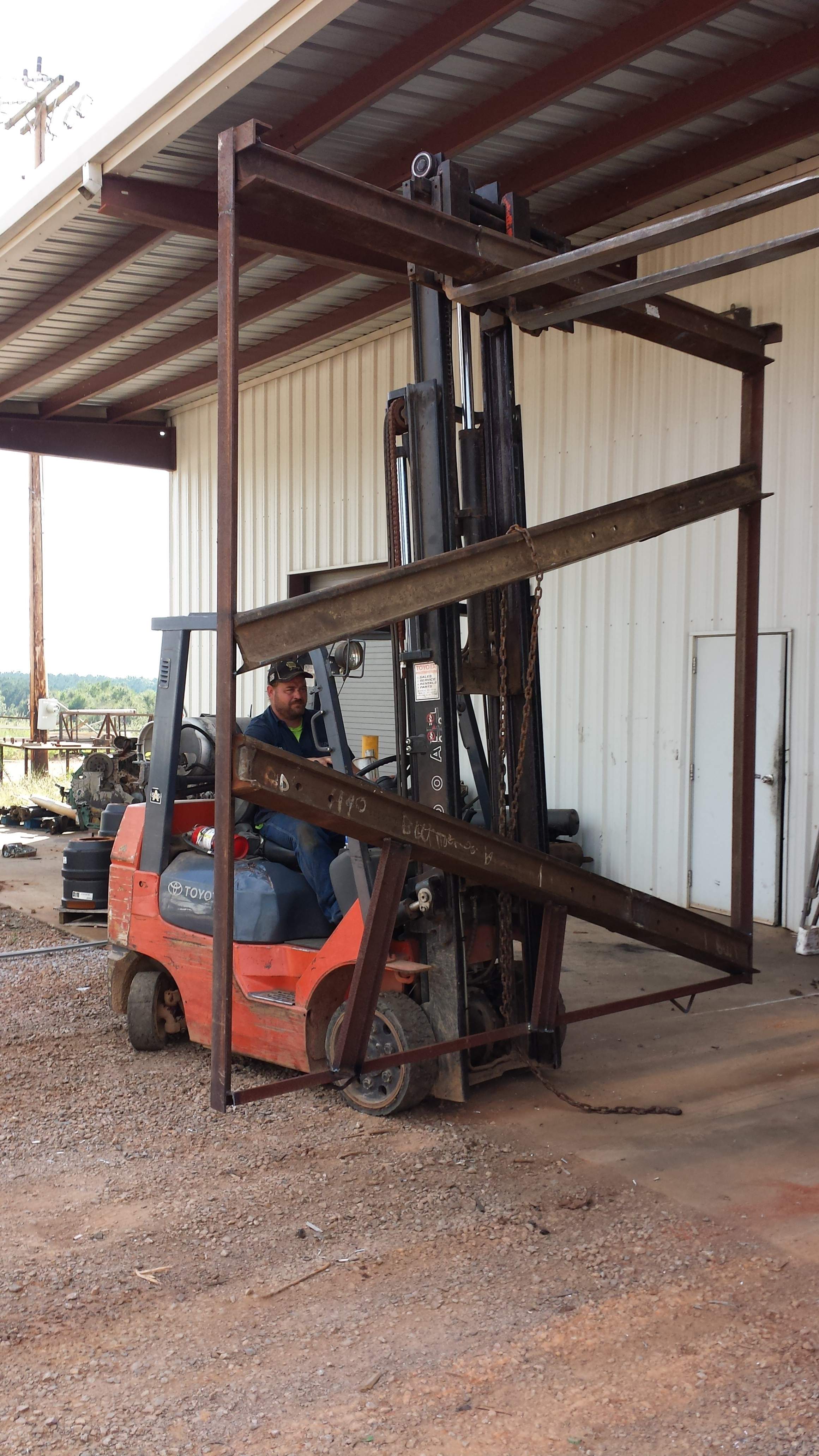

Maybe this will show it's size a little better than sitting on the trailer.20140920_155739.jpgDrag1.jpg
Just over 10' wide. 132 lb/yard rail. 2 angle rails are 128"

Maybe this will show it's size a little better than sitting on the trailer.View attachment 392254View attachment 392255
awesome!
sorry for giving you such a rough time in previous posts, it was not meant to be that way. that 1 picture really did "picture worth a 1,000 words." being able to see more clearly, the angles of stuff. 2nd picture *big thumbs up* ya! being a arm chair bozo and getting my rear kicked out of the seat, vs getting out there and doing it. all good *chuckles*
with the RR spikes, using them at scarficer teeth?, looking more at 2nd picture, the top soil looks pretty dry, and looks like ya just dragging top 1/2" to maybe if lucky 1" depth via ruts and lows in the field? looks like a lot of branches and root parts mixed in that picture. it will be interesting to see if ya rig up some RR spikes as a comb / rake / drag harrow like doing to help pull all that crud out, and maybe break down into the soil a bit more.

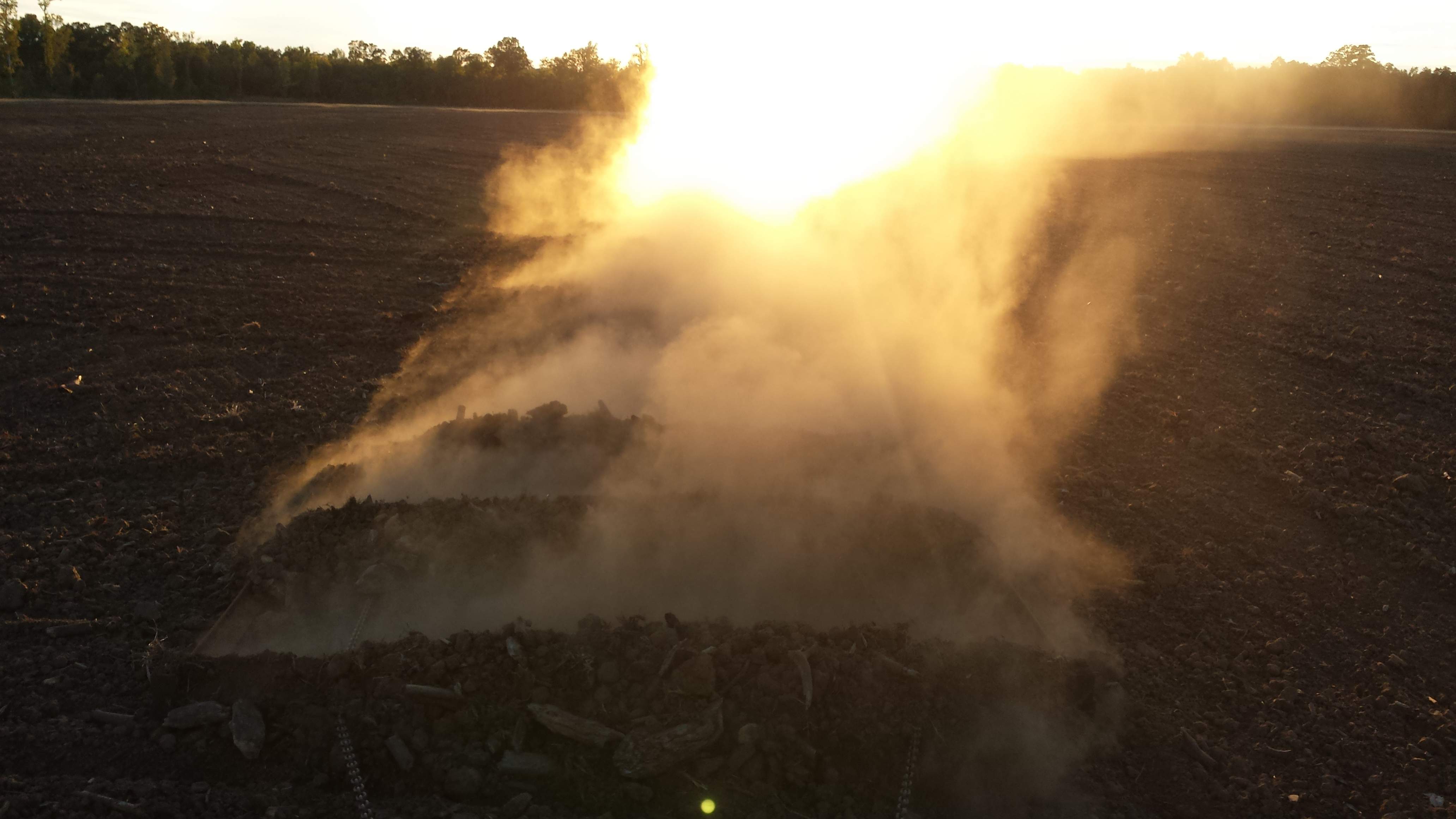

That looks like what I was afraid would happen, they all load up with dirt, but no where for it to go. You may have to rig up a way to stabilize the RR iron at the ends while leaving a couple of feet at the end for the dirt to shuffle out and go back to the next slanted bar. Not sure how you can do the front frame so it doesn't dig in so much.
   / Leveling Drag----and I have searched. #20
Nice job, looks like it working alright for ya.
