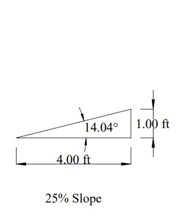

So, we are all talking about the same thing, attached drawing explains % slope and angle of slope
Normal highway slope is 2 horizontal to 1 verticalView attachment Slopes Explained.pdf

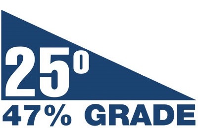

I wondered if anyone wound notice the 25% Slope in the title of this thread.
25% slope is only 14 degrees, not steep at all:
25° is a 47% slope, steep and hard to walk on:

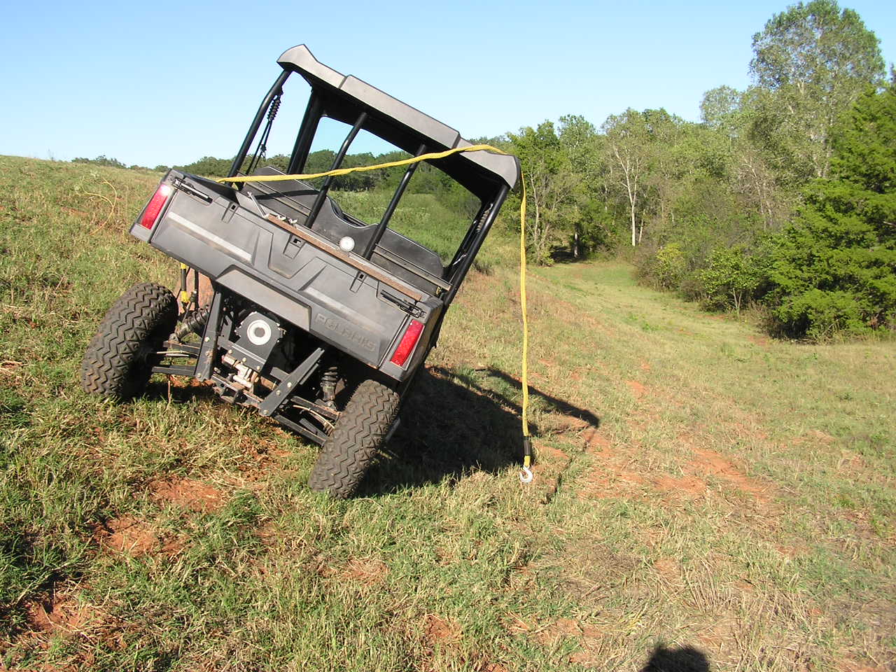

This is a 2/1, 50%, 26.6° slope. The hanging tow rope shows true vertical:
