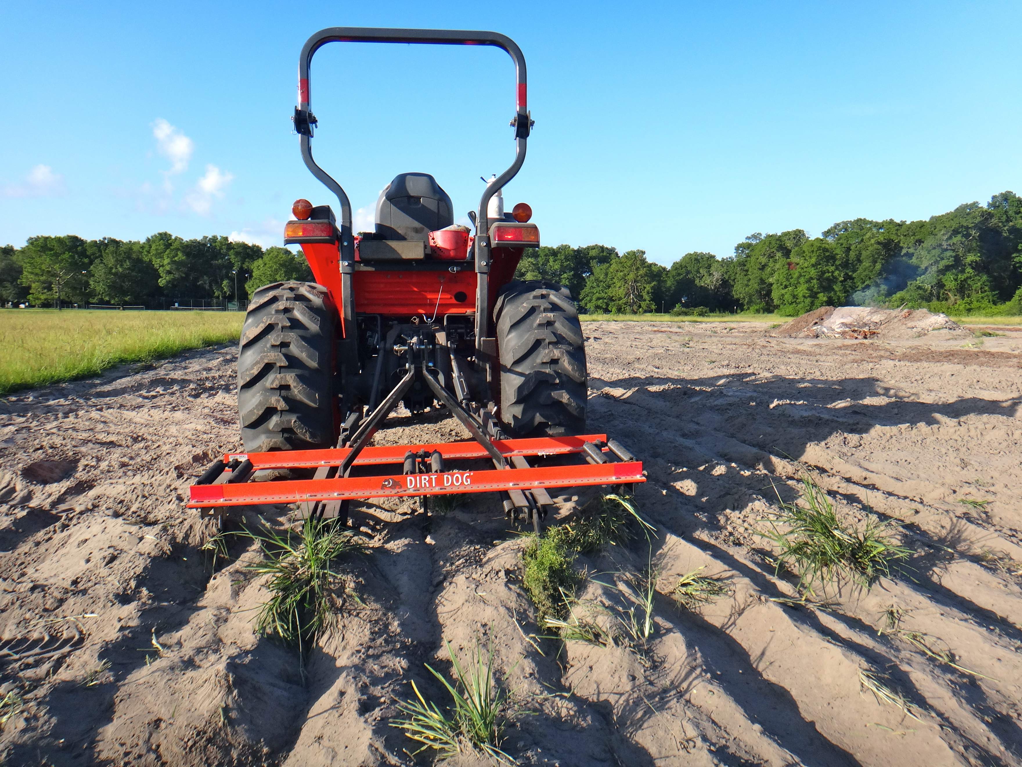

If your soil is not too tough, I suggest a Field Cultivator. A CK2510 should manage either five tines or four tines, more likely five tines, and penetrate to 12" depth if you desire.
(Five tine model around $700 in USA.)
MORE: http://www.tractorbynet.com/forums/attachments/339095-dirt-dog-all-purpose-plow.html?highlight=

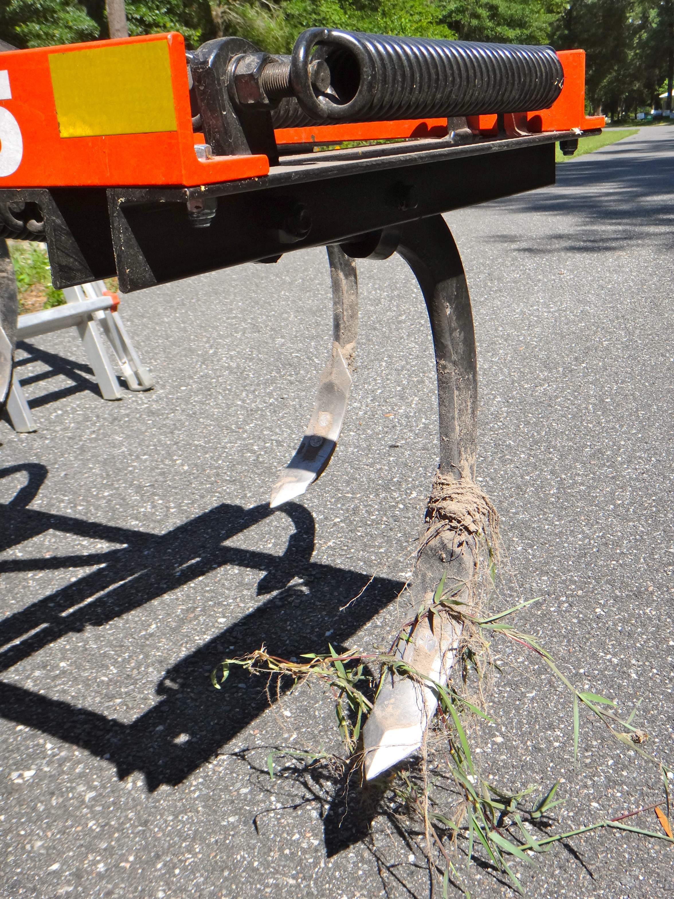

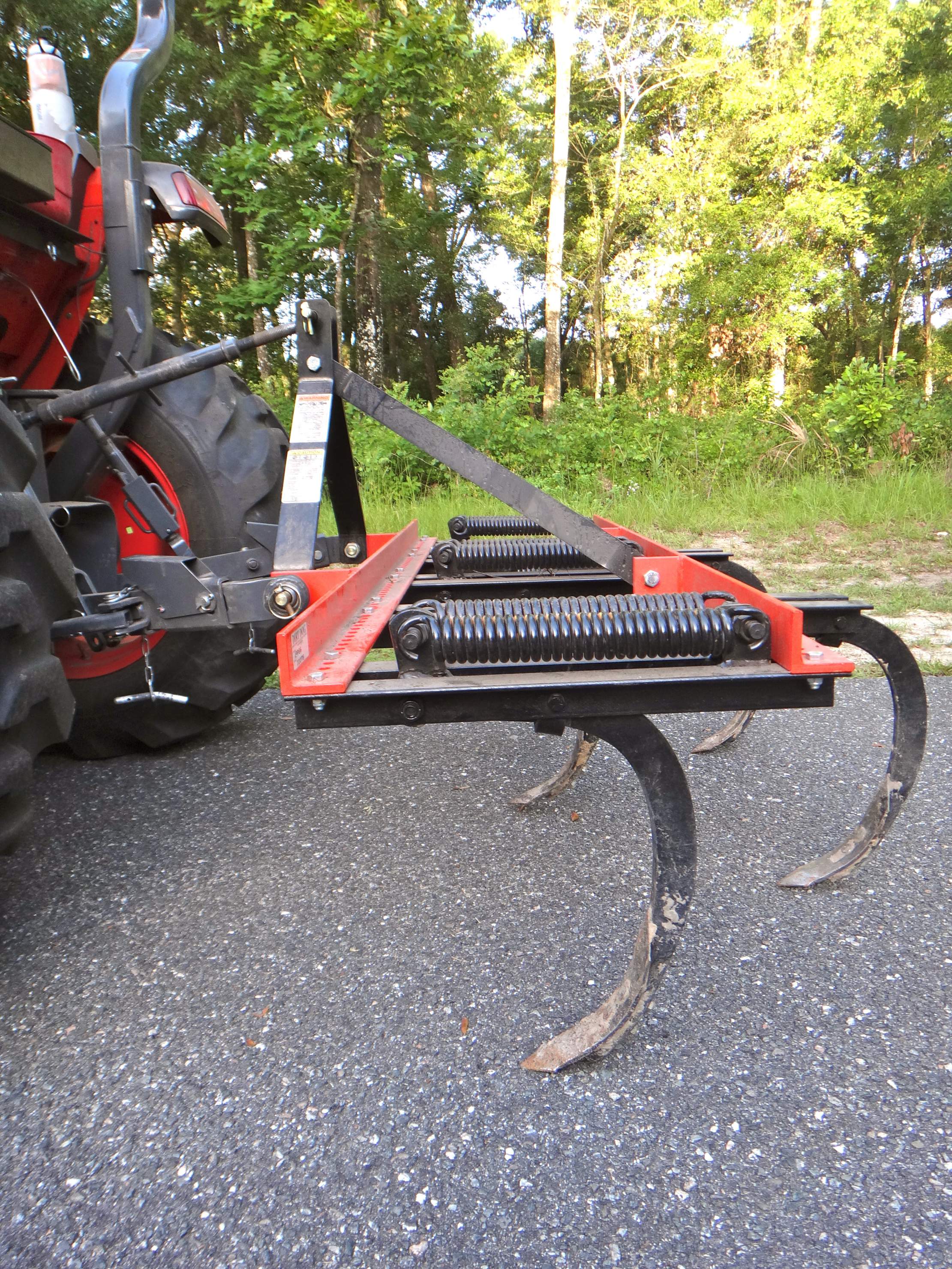

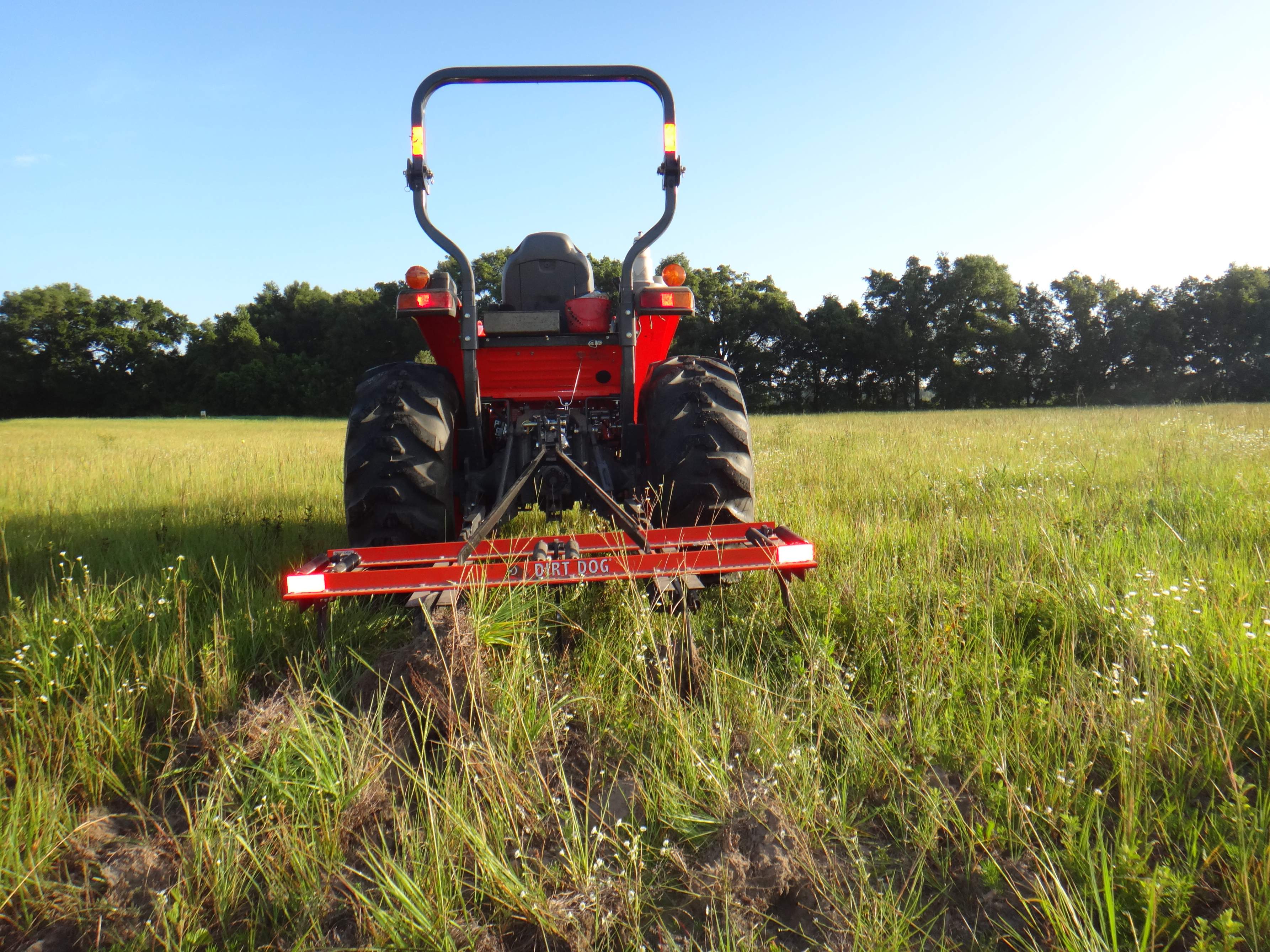

I see you have very sandy soft soil, around here in the hard boney soil those light duty tines would be destroyed quickly, your second picture you are using them as we would a set of chisel plows. We pull a 12ft set of chisel plows and disk with 175-225 hp and 18,000-20,000#s

Field Cultivator and Chisel Plow are very loosely used implement terms.
To me, a Field Cultivator is theoretically for secondary cultivation, where a Chisel Plow is theoretically for primary cultivation. They are built similarly but to different scales. Both implements have spring protection for the tines. However, it is true that "hard, boney" dirt could pretzel a Field Cultivator. (The other side of the coin is that I have never seen a real Chisel Plow in Florida, either behind a tractor or in a tractor dealer's implement inventory.)
In Florida sandy-loam there has been just one occasion when my Field Cultivator did not want to penetrate ~~~that was a hard packed pasture in a dry month.
I would rip with the Field Cultivator first, then observe the results. Field Cultivator deep rip may solve your excessive standing water problem, which will stimulate grass and worms ~~~ as should high nitrogen duck excreta.
Field Cultivator will level slightly. Think of it as a rake with rake teeth spaced 8" apart.
Photo #1 Dirt Dog (brand) 66" All Purpose Plow
Photo #2 Athens Chisel Plow/ 5 tines.

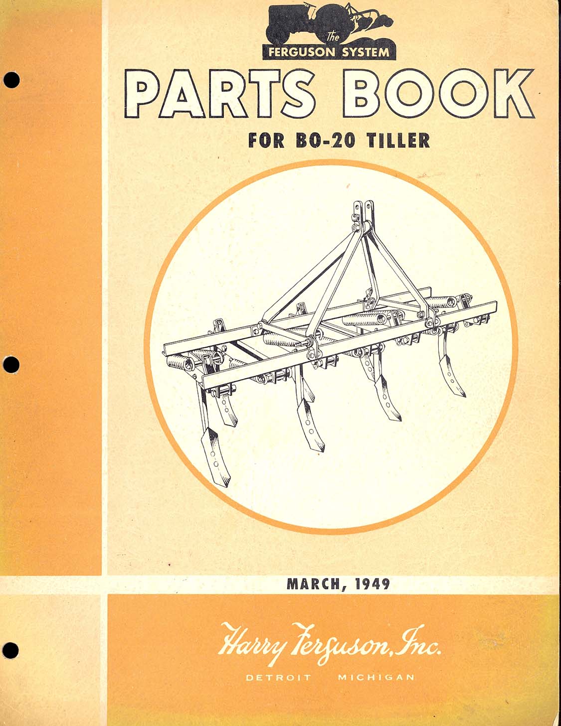

A further note.
The Field Cultivator was developed by Harry Ferguson, inventor of the Three Point Hitch. Ferguson called it a "tiller".
Harry was a small man. He makes that Ferguson tractor, same size as a Ford 9N/2N/8N, look big.
Ferguson's "Tiller" was one of the first four (4) Three Point Hitch tractor implements.
