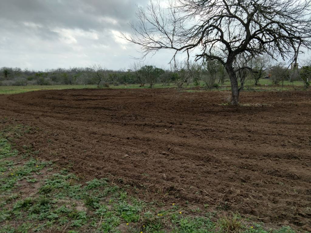

I repaired my pig pastures by discing thoroughly and them smoothing with a landscape rake. It looked like a moonscape before, now you can't tell they were ever there. IMG_20180217_092653545_HDR.jpg

Thats fantastic stx - sounds like what I gotta do! Put the pigs elsewhere in the meantime I guess?
