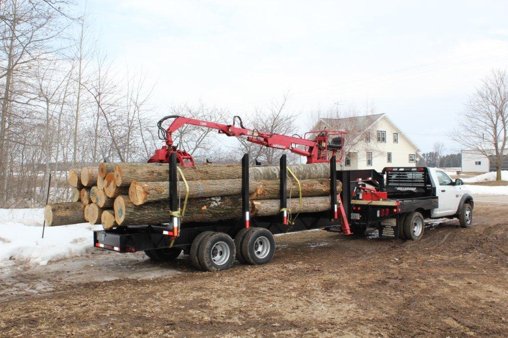

Do you find the same lifespan on trailer tires with a G rating and 14ply? I have two dully Gooseneck trailers with ST 235/80 R16 LRE tires and one bumper pull 10K dump trailer at 235/85 R16 LRG 14 ply but G rated, However, my biggest concern now is that I will have to replace all the tires on my gooseneck trailers as the tires are six years old? I also just converted my older Metavic log loader onto a new trailer (see below) and used 10ply tires and possibly should of gone to G rated ones? Given the two older GN trailers are six years old with the original tires would I get a longer lifespan from G rated trailer tires or is it just the nature of the beast? I will never use the trailers enough to wear out the tread but can't be without them for transporting my equipment. The trailers do sit outside all the time but when not being used are empty (no load). Thanks Log Trailer (2).jpg

Do you find the same lifespan on trailer tires with a G rating and 14ply. I have three two large Gooseneck trailers with ST 235/80 R16 LRE and then a smaller bumper pull 10K dump trailer at 235/85 R16 LRG 14 ply tire and I must admit that G rated tire has held up much better. However, my biggest concern now is that I will have to replace all the tires on my gooseneck trailers as the tires are close to six years old? I also just converted my log loader onto a new trailer (see below) and used 10ply tires and possibly should of gone to G rated ones? as the as two of the trailers are now six years old with the original tires. Do I get any more life from G rated trailer tires or is just the nature of the beast? The trailers do sit outside all the time but when not being used are empty (no load). Thanks<img src="http://www.tractorbynet.com/forums/attachment.php?attachmentid=314198"/>
Time is usually the limiting factor but going with the heaviest load rating for your wheels and axles is always a good idea.
Chris

Do you find the same lifespan on trailer tires with a G rating and 14ply? I have two dully Gooseneck trailers with ST 235/80 R16 LRE tires and one bumper pull 10K dump trailer at 235/85 R16 LRG 14 ply but G rated, However, my biggest concern now is that I will have to replace all the tires on my gooseneck trailers as the tires are six years old? I also just converted my older Metavic log loader onto a new trailer (see below) and used 10ply tires and possibly should of gone to G rated ones? Given the two older GN trailers are six years old with the original tires would I get a longer lifespan from G rated trailer tires or is it just the nature of the beast? I will never use the trailers enough to wear out the tread but can't be without them for transporting my equipment. The trailers do sit outside all the time but when not being used are empty (no load). Thanks<img src="http://www.tractorbynet.com/forums/attachment.php?attachmentid=314198"/>
With a trailer like yours, if you are doing short trips and don't mind a few road side break downs. I'm basing on the fact that your trailer has duals and double axle, lots of redundancy and likely used under capacity. I'd probably wait until the second tire failure than replace them all. Jmo.

I do not like the idea of replacing 16 tires that appear in great shape but I hate even more the thought of a blowout on the highway when your towing a trailer loaded to nearly 20K?. When I use the trailers I am seldom light on my trailer loads so like the orginator of this thread this will be expensive! If I never come close to wearing out the tires and it is just a matter of time then going to G-rated 14 ply tires would not really help me as far as the lifespan. I have so far had no problems with the 10 ply E rates tires. As far as my log trailer I wish I had put G-rated tires on them as they get abused and I am close to capacity at times. Anyway thanks for all the good advice.
