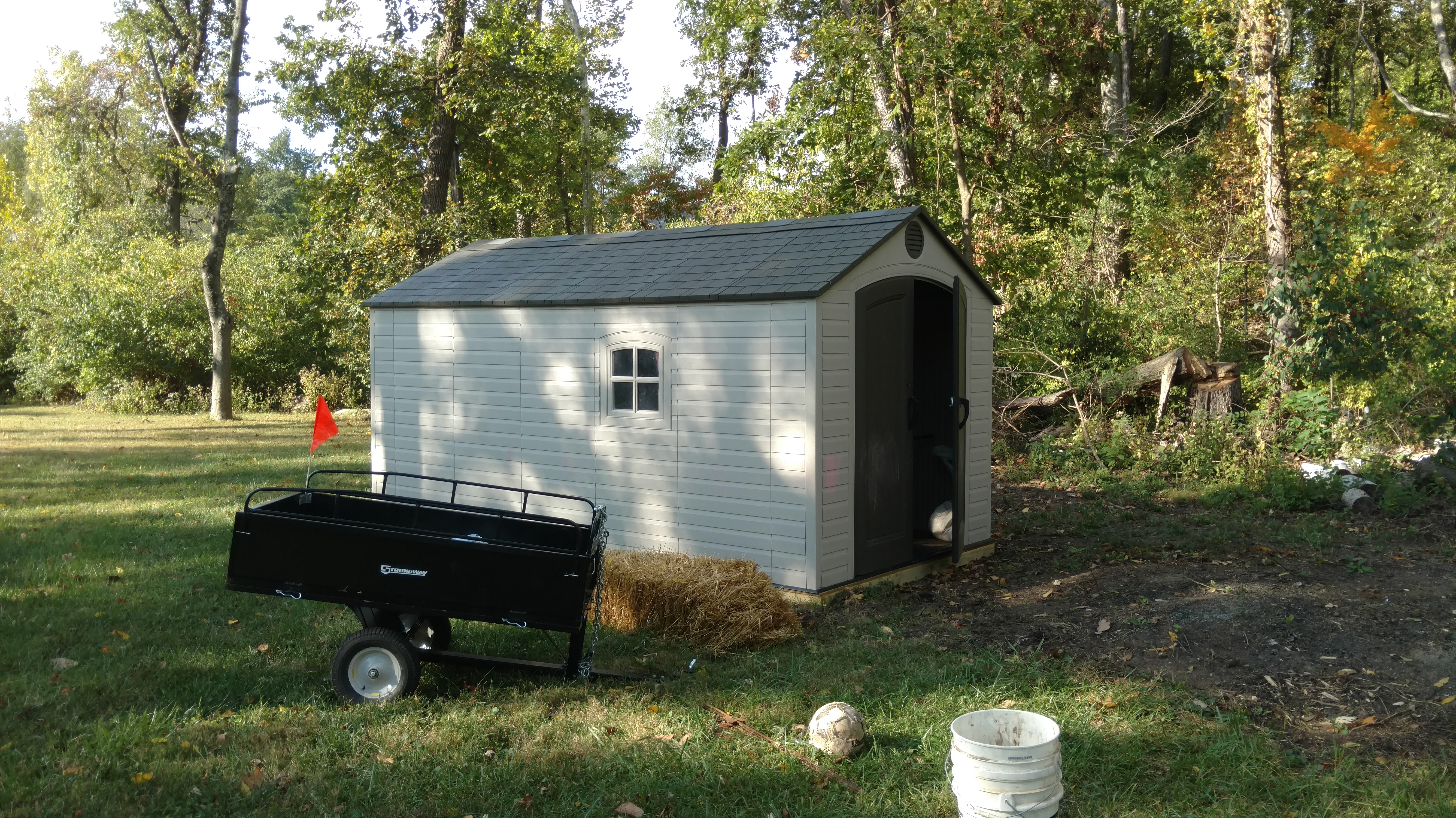

I have assembled one of those 8x15 Lifetime sheds. It is working well so far.
Our old church storage shed was crushed by a tree. They just don't make quality buildings anymore. :laughing:
Costco had the Lifetime shed delivered for $1,000 + tax. You need add the cost of either a wood or concrete foundation to that (I built a wood one from the instructions, just took the list from the manual to the lumber yard and had them cut all the pieces for an extra couple $). It was around $240 for the treated wood and plywood and nails.
With expert help we were able to assemble it pretty fast and it includes a few shelves in the back and by the doors. Add in a few of the wire shelving units and it works pretty well around here (not much snowfall or high winds). They sell and extra kit of reinforcement if you have more extreme weather.
There are some steps that really do need two people to get it done, and I would not recommend doing it with any significant wind. Pretty flimsy until it is all bolted together with the reinforcement trusses inside. The windows and translucent panels on the roof work well for letting light in.

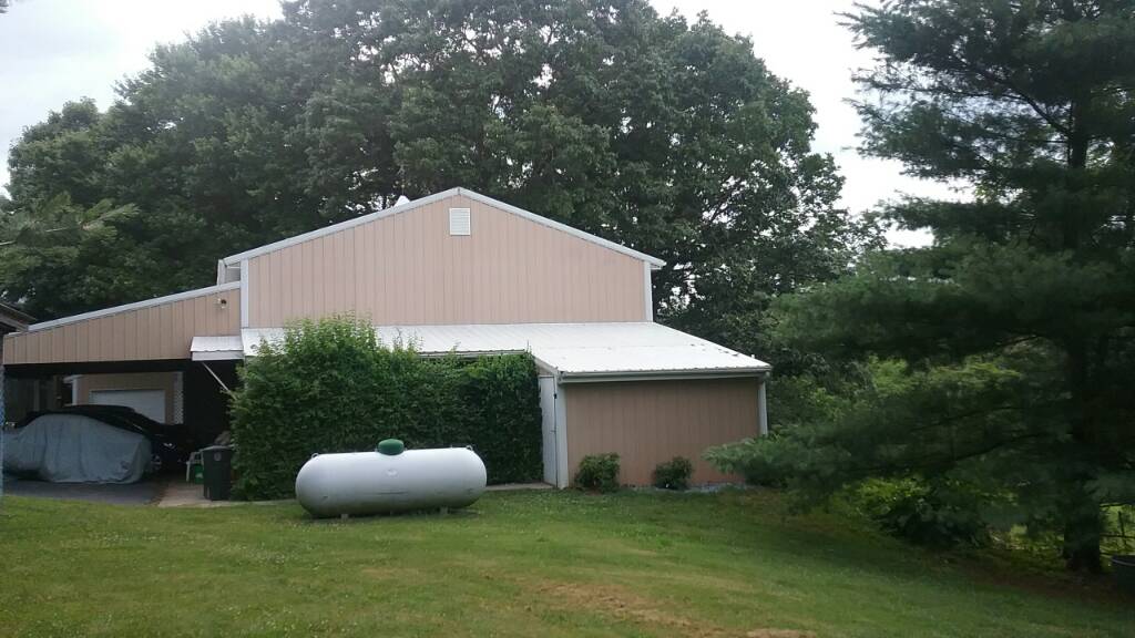

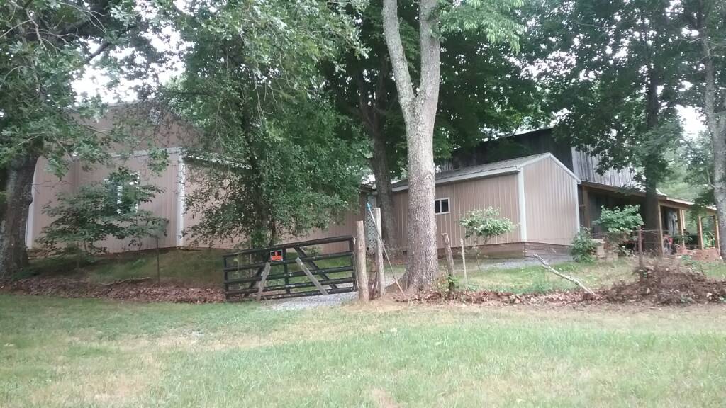

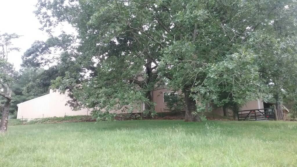

Sounds awesome. Off topic, but have any pics to share?
Sure. It's hard to take pictures for all the trees. The back is where barn and hay shed will be. That old fence and gate will be removed.
That old tobacco barn is of course separate.20180621_183707.jpeg20180621_183753.jpeg20180621_183610.jpeg20180621_183938.jpeg20180621_184040.jpeg20180621_184227.jpeg20180621_185212.jpeg
