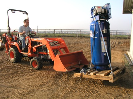

You won't be able to lift 800lbs using bucket forks. I used my BX22 with bucket forks to lift a 450lb Quincey compressor off a 17" high trailer and move it into my barn. I was RIGHT AT the lift limit of the FEL with forks. Managed to lift the compressor about an inch by carefully curling the bucket in, then used some metal rods as levers to help lift it off the trailer.
