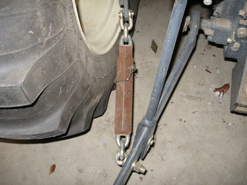

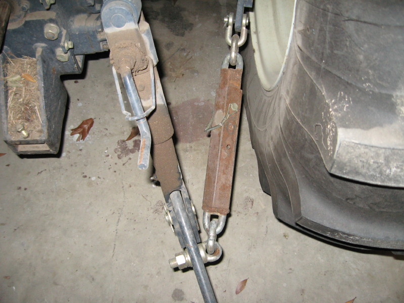

Sorry if this is kind of late, but just ran across your post. I made a set of telescoping sway bars for my Mahindra 4110. They were built as light duty, as far as I was concerned. Kind of a proof of concept. But I have yet to buckle them, even with a fairly heavy harrow. They are made of 1.5" and 1.25" square tubing, both .125" thick wall. I drilled the outside with three holes 1.5" apart, and the inside tube with holes 1" apart, so the adjustment rate is .25". As this is my first post, I will attempt to attach some photos, but I will apologize ahead of time if they are missing. Also, I would say at this point, I would drop the link of chain I left in on the original.

Thanks. Actually, what you see on each end of the square tubing is the remainder of the original turnbuckle type sway links. I welded a plug in each end of the tubing, sawed out the turnbuckle, and welded the tubing in. If you didn't want to sacrifice your original though, the eyelet should be available from a good hardware supplier, as well as weldable chain links. Try McMaster Carr.
McMaster-Carr
Later,
Wayne

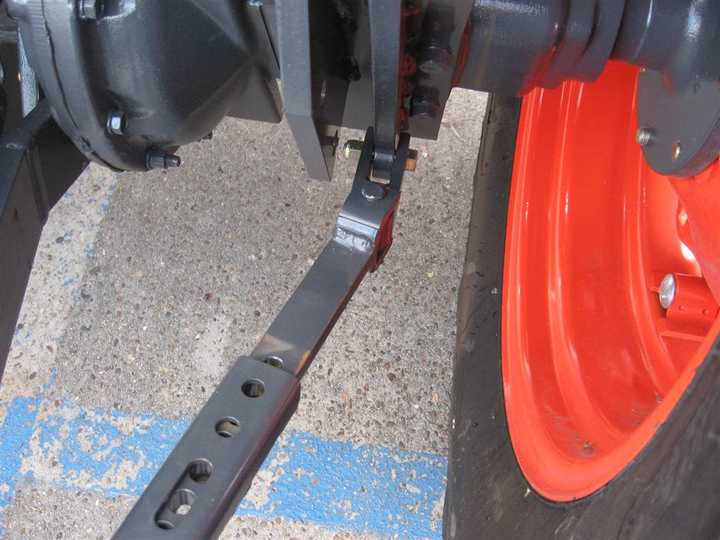

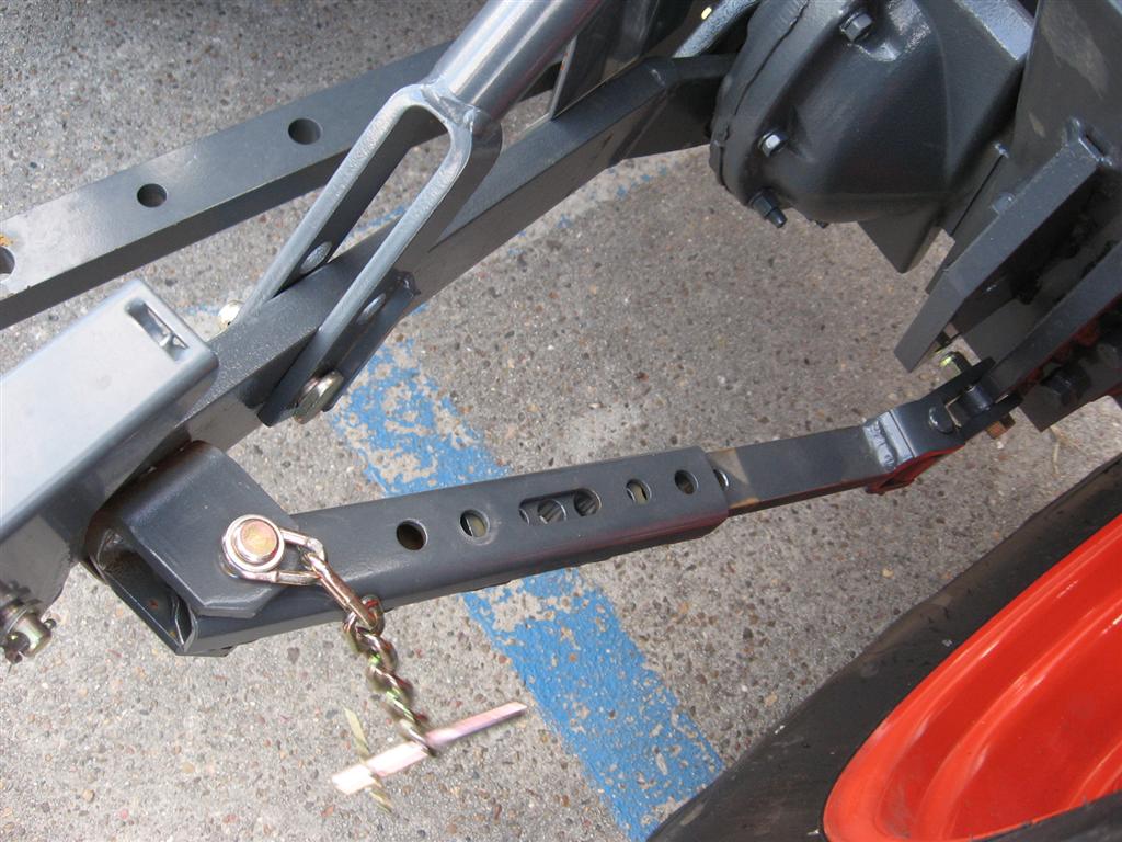

I'm noodling a homemade set. It's tough to find the right telescoping material to use. Factory looks like a 3/8" 1.25" flat bar, the rect tube looks to be 3/16" thick. 16ga tubing probably isn't enough.
On my L I can buy just the telescoping parts for $86 for each side with some of the pins and stuff (TA140-39606). Doesn't include the ends that I'd have to make for my L (not an option).
Wayne's looks ok but I wanted to match the factory more and not have the chain links in there.

I was buy a dealer and took some shots of this. It's off an M5000 or M50??. I'm going for something like this. I have an L so I have to go on the outside (more room than a B, wider tires). I think these are the P/N I mentioned above. As I was driving out I stopped by a bigger Kubota. M7??? not sure. The stabilizer arms were heavier metal. But rolled in a U shape. The female piece was also a U shape and only had about 8" of the U closed up to form the tube. Interesting. No pics of that one.
I've got some more ideas so I'm not killing this yet. :D
