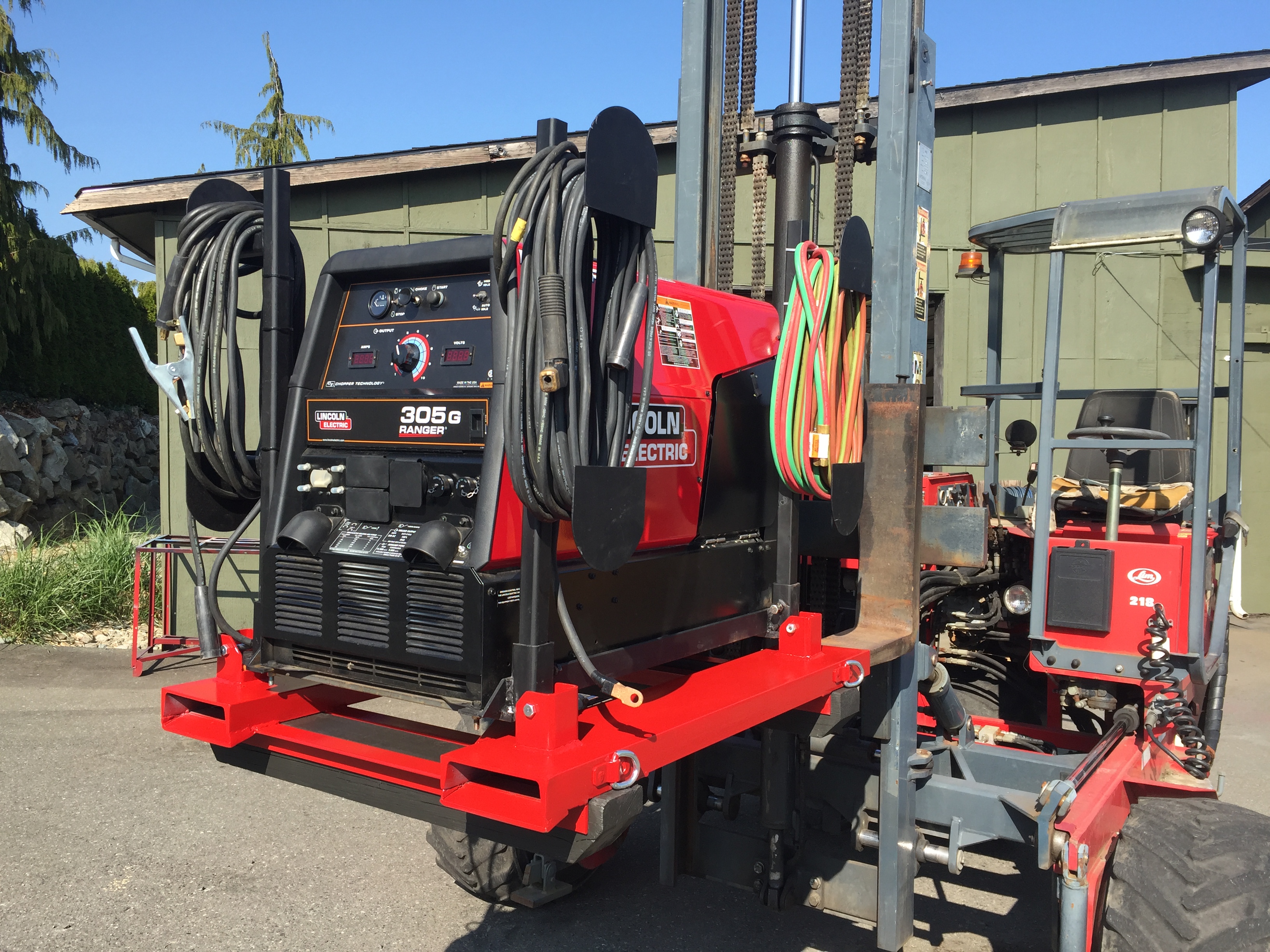

Here is a skid I built for my welder. Same concept...

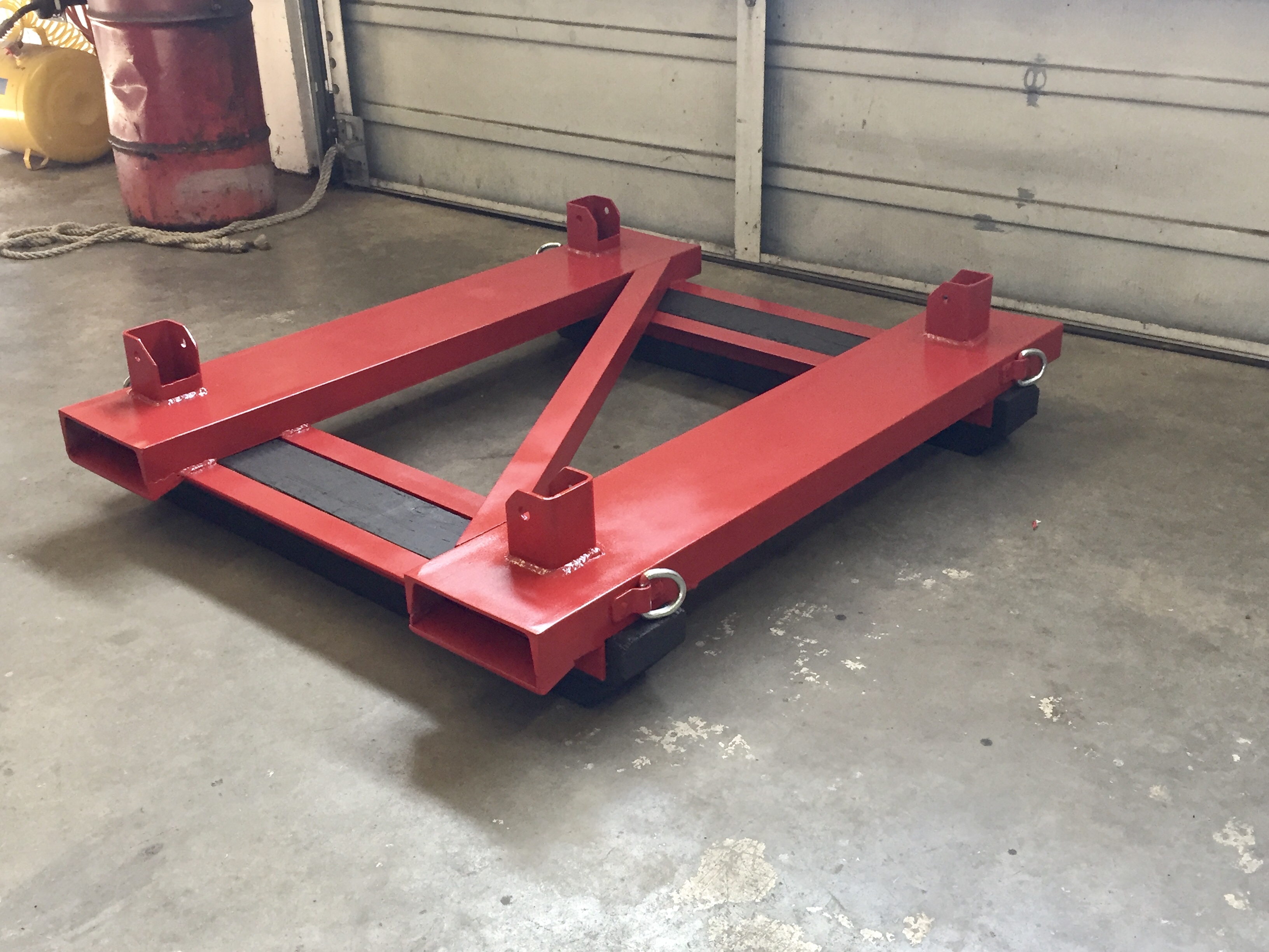

and a base under a 500 pound pseudo anvil..

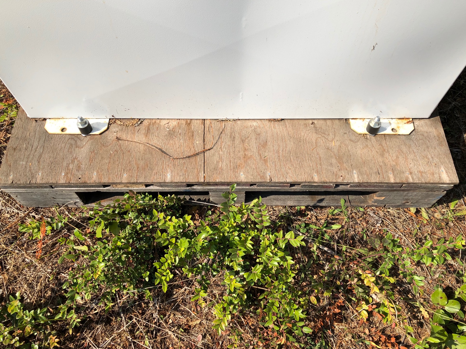

Simple skid mount for the tank. The pallet is reinforced with a plywood top, well nailed. Then the tank is bolted through both plywood and pallet. This is very strong.
