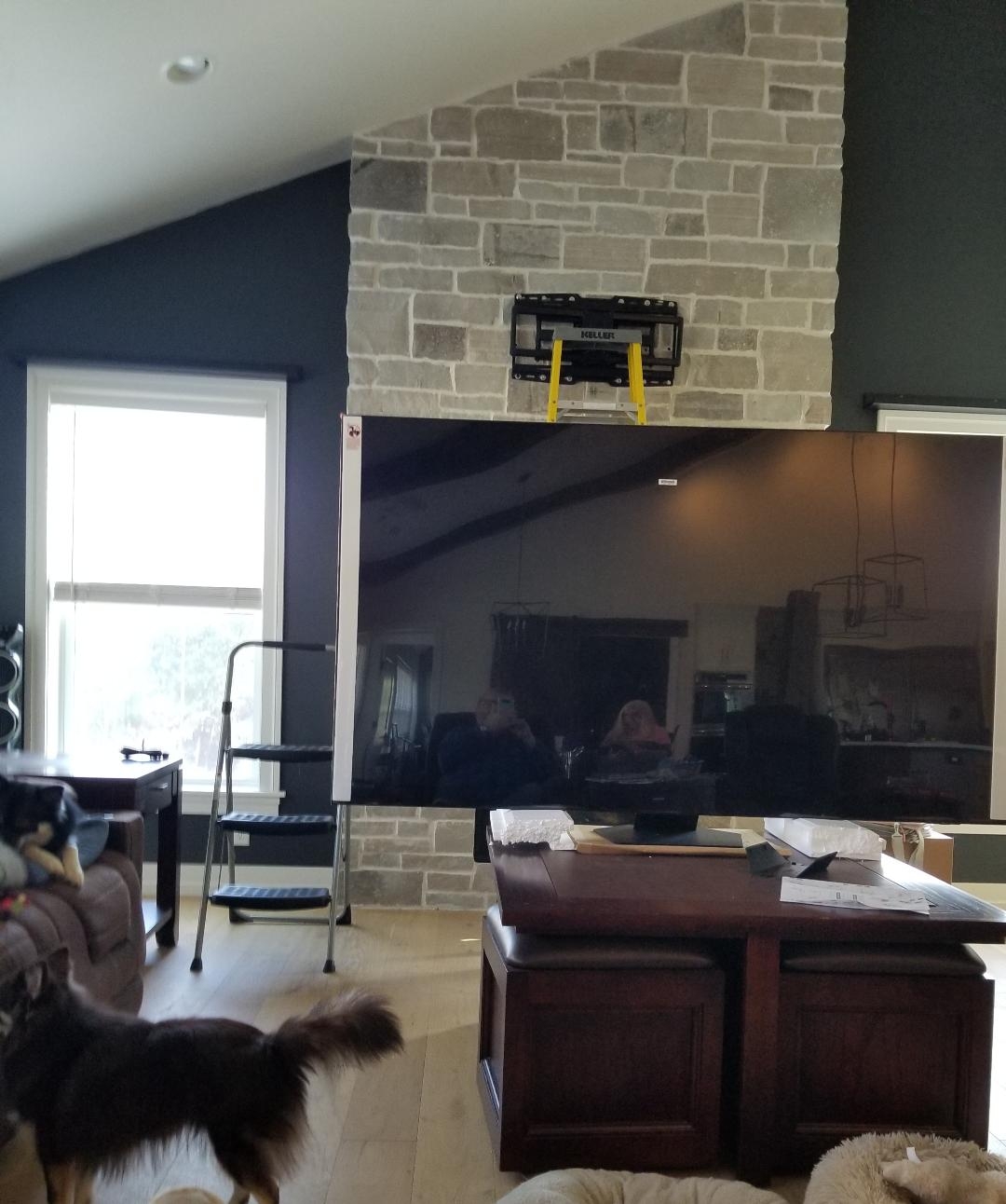

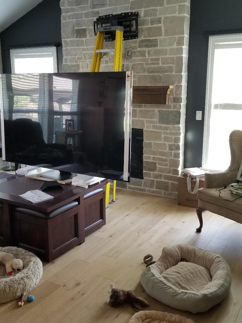

Here it is

Here it is
Me...I'd move everything out of the way, pets & people out of the room. I'd want 3 guys.
A ladder each end about a foot wider apart than tv. The stool in middle.
Have a padded quilt on floor bigger than tv.
Quilt out flat, no lumps.
Unscrew base (4 screws probably), two guys lift tv off of base, face down on quilt slow & carefully.
Then be sure mount for tv works in bracket ok, testing it a few times. Mount bracket on tv.
Guy each end carefully lift off of quilt, up ladders with third guy in middle...he's there pushing up for stability & takes load off.
Hook mount on bracket. Secure safety screws/bolts. Connect cables.
I would make a trial run with it's box first which is light.

If it works better after being sure tv mount goes in wall bracket properly is mount to tv, unscrew base (a guy either end holding set), lift it up off base (no quilt).

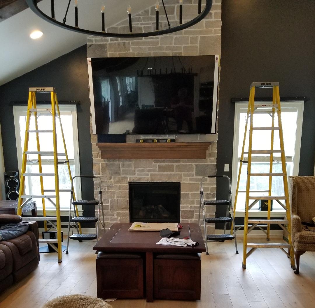

The builder from down the street sent over 2 of his boys. They were part of the construction crew for my house 2 years earlier. 5-10 minutes later, the deed was done. I made sure I know what beer to buy them.
